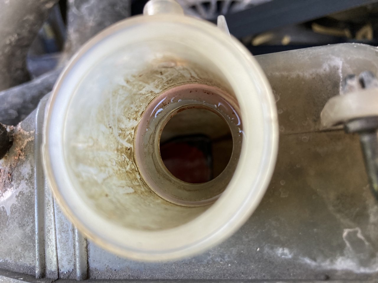

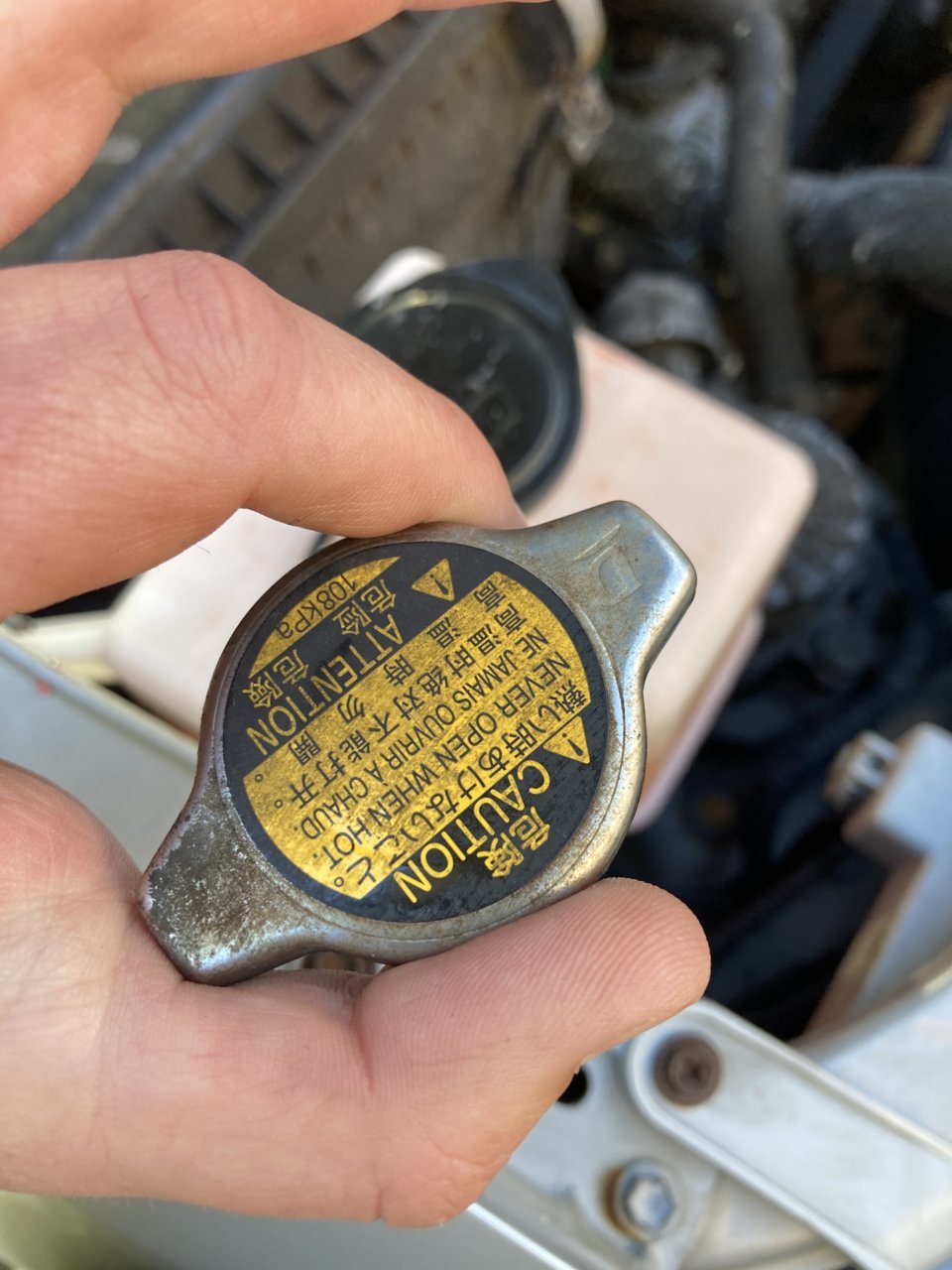

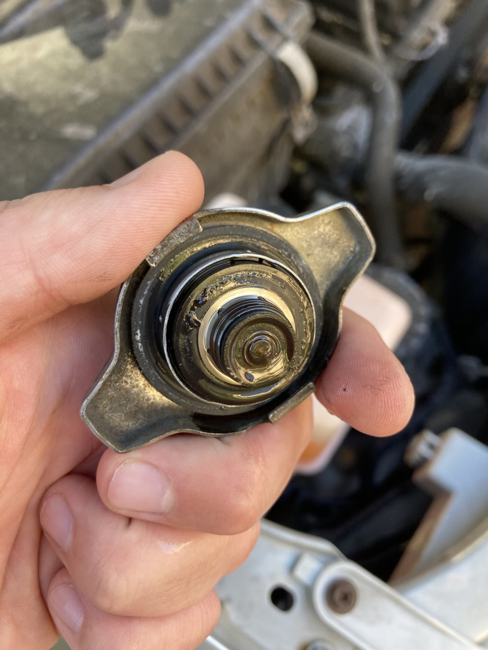

    As far as I know, it has never been replaced; How would I know if it it is bad?
    2B69A842-F3B8-4F31-B5BB-04263CA61912.jpg 747AB865-3550-4B57-A65A-E8F8D59020D4.jpg
  10. Jun 28, 2022 at 1:31 PM
    Dm93
    Dm93 Test Don't Guess
    Mar 3, 2015
    #150066
    13,592
    Texas
    2014 DC OR 6spd 4x4
    Predator tube steps, Ranch Hand grill guard, Magnaflow CatBack exhaust, Toyota tool box & bed mat, 2LO Module by @Up2NoGood, Rearview Compass/Temp Mirror, Tune by @JustDSM.
    Take it off (with the engine cool of course) and see if the little plastic check valve is broken or missing.

    This could very well be the problem; Should I go with OEM or buy an aftermarket one?
  12. Jun 28, 2022 at 1:34 PM
    TnShooter
    TnShooter The TacomaWorld Stray
    Sep 2, 2010
    #42625
    21,166
    Deogee
    07' TRD Off-Road, Auto
    STOCK
    OEM
  13. Jun 28, 2022 at 1:34 PM
    Dm93
    Mar 3, 2015
    #150066
    13,592
    Texas
    2014 DC OR 6spd 4x4
    If it was mine I would go OEM
  14. Jun 28, 2022 at 1:35 PM
    TnShooter
    Sep 2, 2010
    #42625
    21,166
    Deogee
    STOCK
    I guess I should say, you could buy an aftermarket one to run until you can get an OEM. Then put the OEM one on.

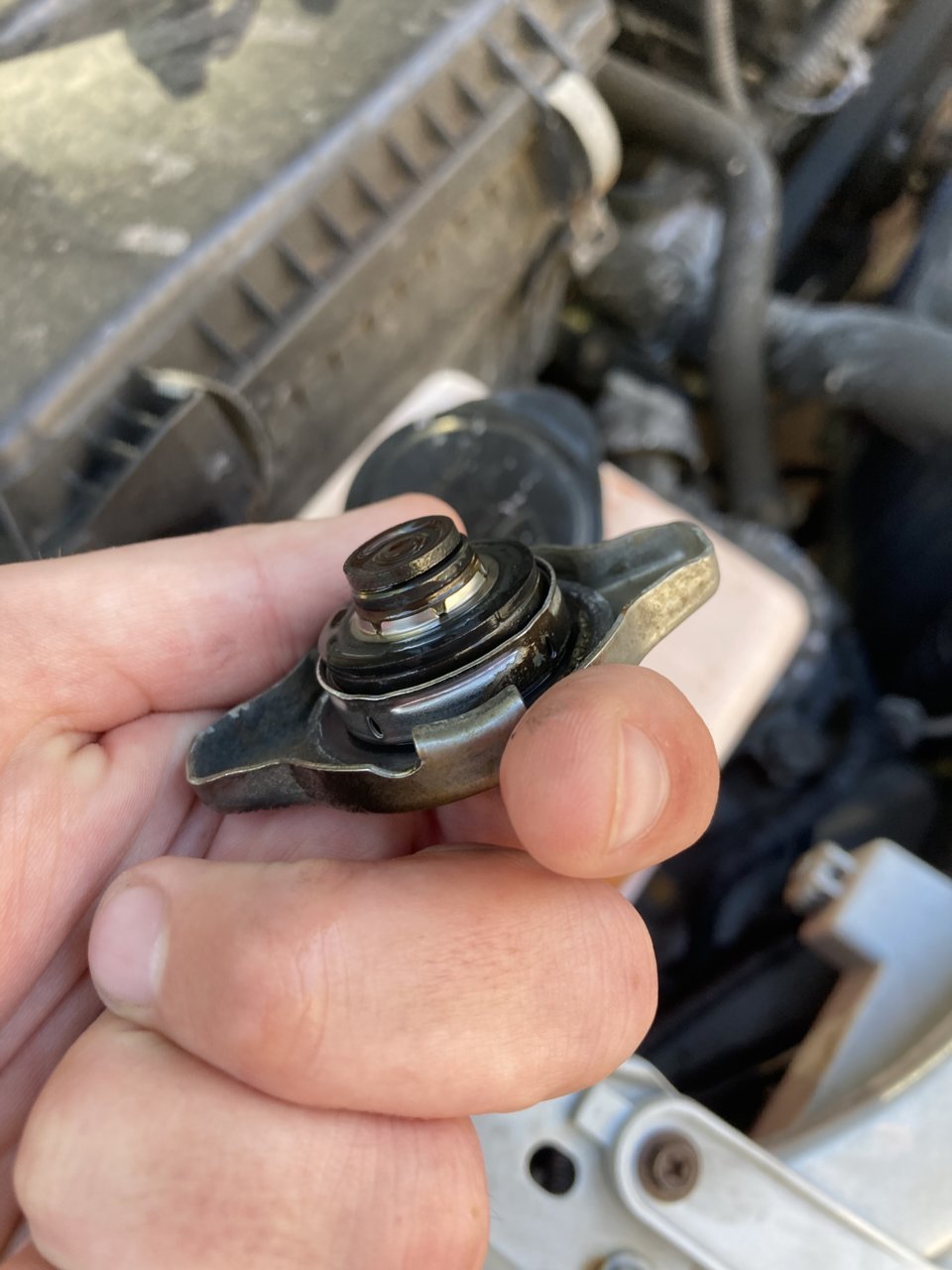

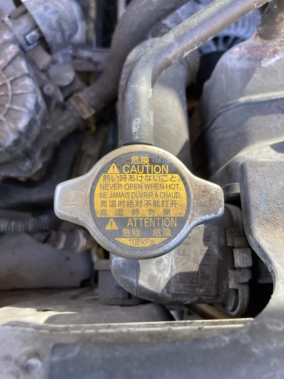

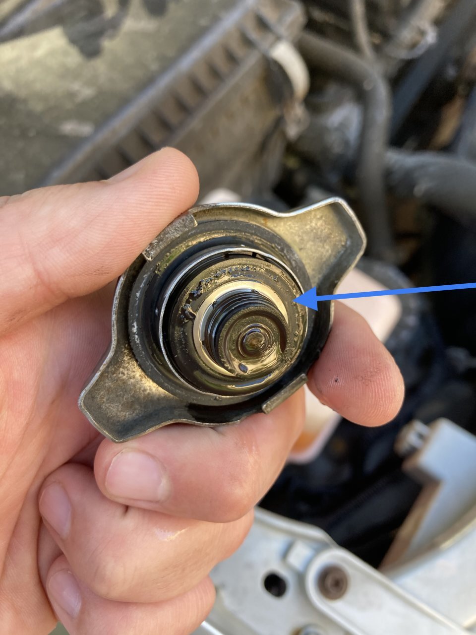

  15. Jun 28, 2022 at 2:48 PM
    PennSilverTaco
    PennSilverTaco [OP] Encyclopedia of useless information...
    Jul 15, 2014
    #134007
    72,211
    Charlie
    Central Bucks, Pennsylvania
    2010 Zombie Truck 2002 PT Cruiser
    BC7FA8AB-5F64-47BE-AAFB-43FBE891673C.jpg8621CEE8-95BF-4390-B76F-DB19273C2BCE.jpgA51CF878-DD2C-404A-896C-60EBC49B894C.jpg8AFA0094-6A07-4800-AE94-BD64F3A16CDE.jpg1C683629-F6E4-4AD1-BCDF-F429A937BCD6.jpg

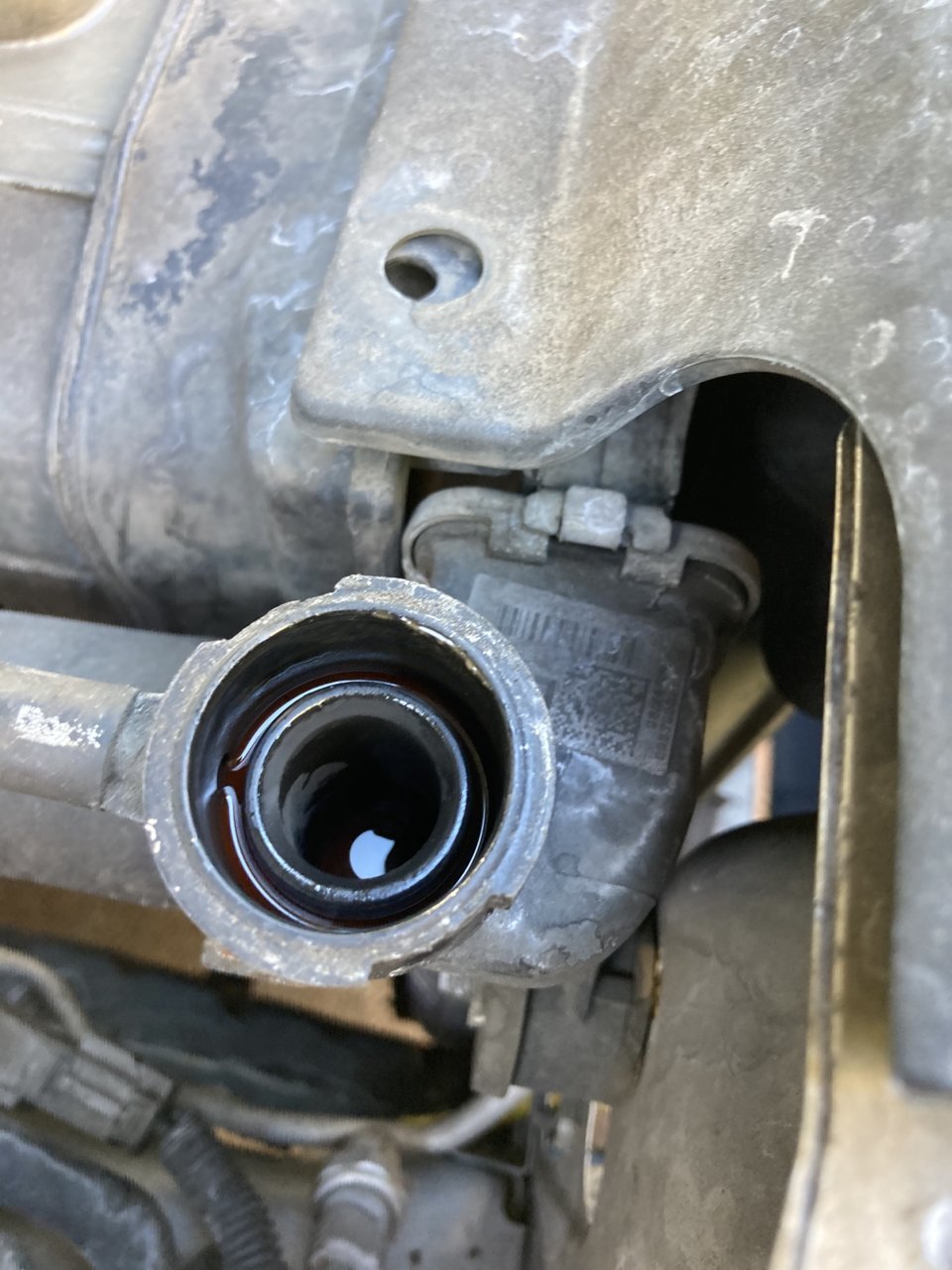

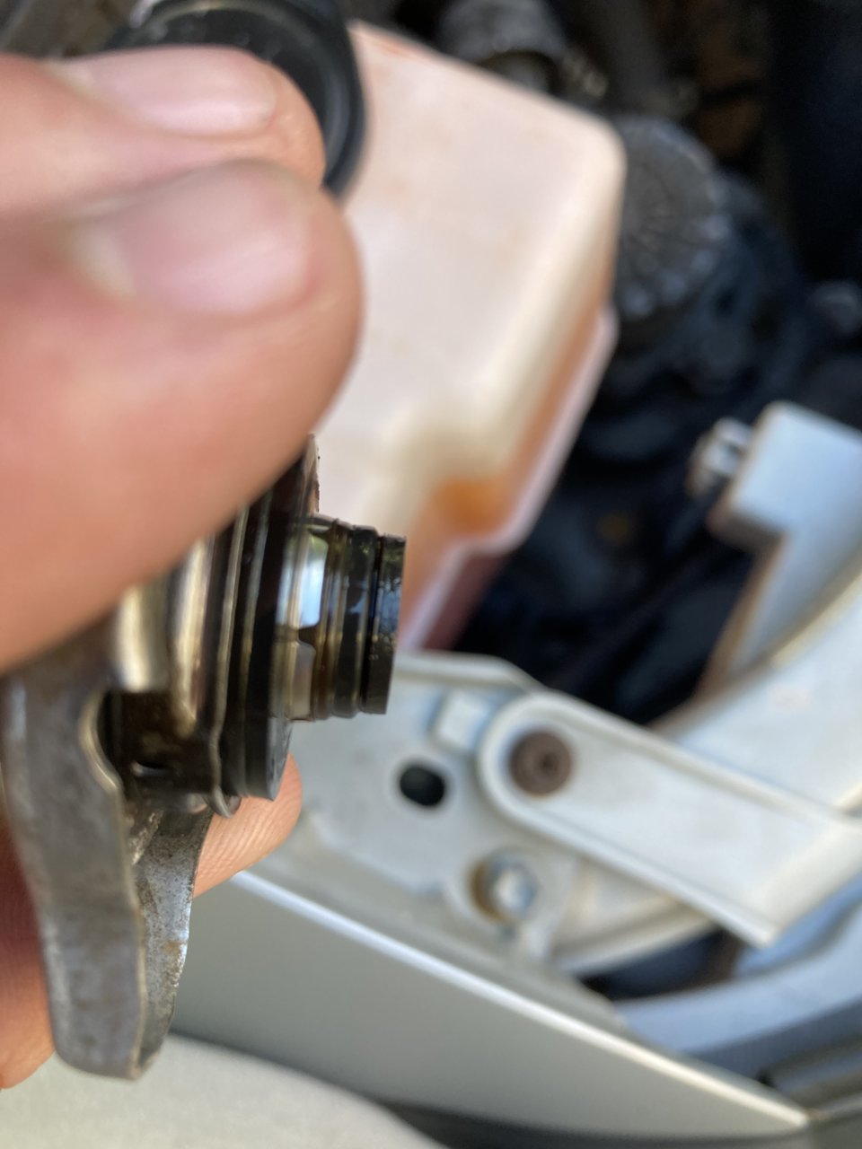

  16. Jun 28, 2022 at 2:51 PM
    PennSilverTaco
    Jul 15, 2014
    #134007
    72,211
    Charlie

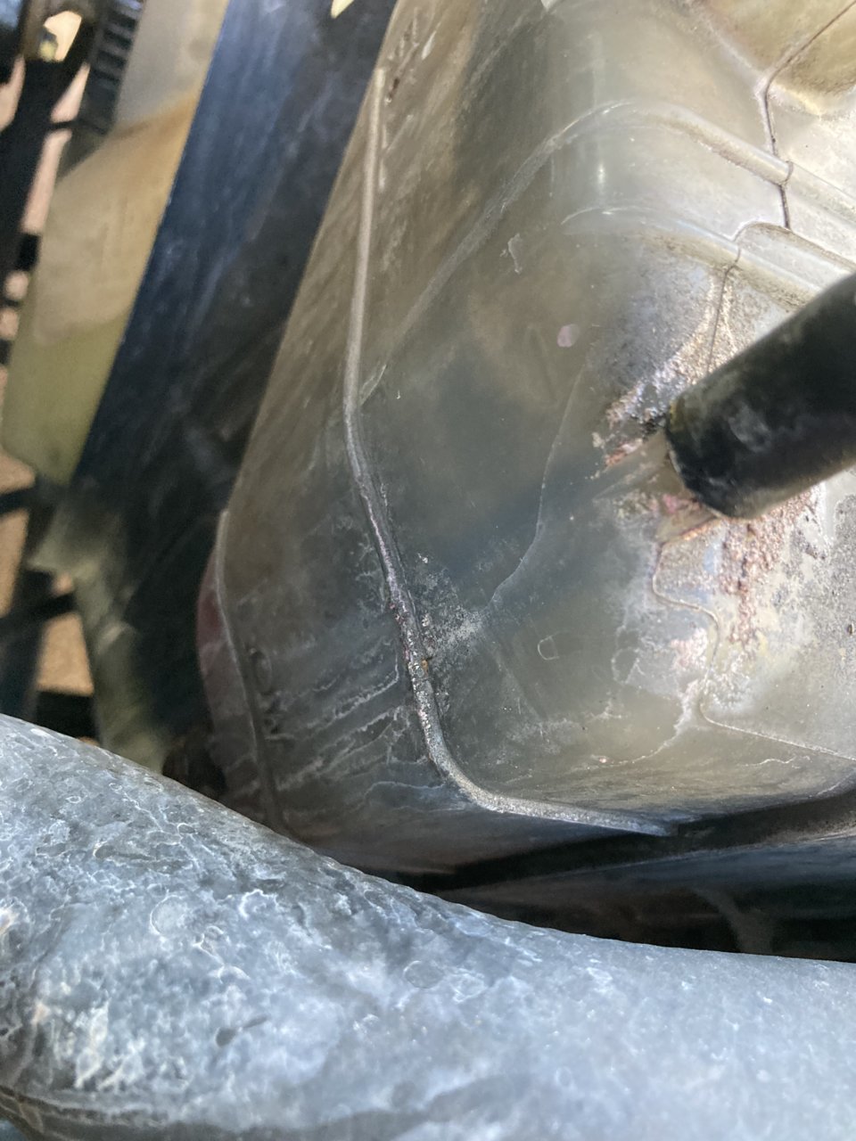

    The truck has been sitting for maybe an hour, and the coolant is currently right at the LOW mark...
    8ED88BC9-0D19-4630-AEDF-9E4715F8ED04.jpg 81BA233A-F215-4CEC-8A3C-5AD75DBB91DA.jpg
  17. Jun 28, 2022 at 2:58 PM
    TnShooter
    Sep 2, 2010
    #42625
    21,166
    Deogee
    STOCK
    The seal on that cap has a lot gunk on it.
    See the area below for where the seal is.
    I personally would replace that cap, if for no other reason than preventative maintenance.
    They can fail and the spring an bottom end fall down into the radiator. You ain’t getting it out either.
    It lives there until the radiator is replaced.

    Just ordered...

    Yup replace the cap. top off radiator, and fill overflow tank (clear tank on back of rad) to the full mark and drive!
