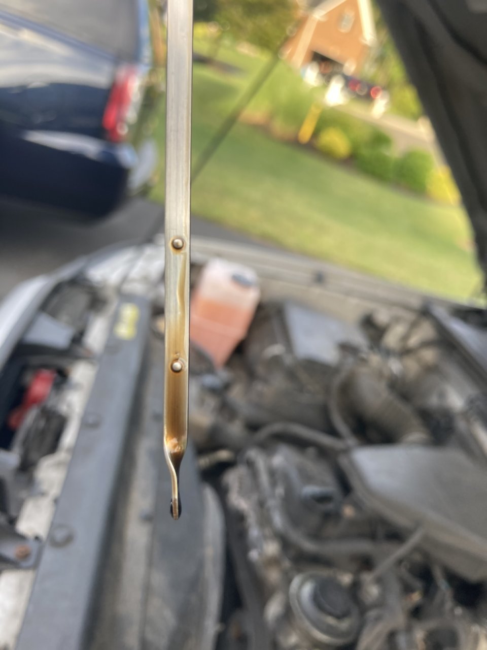

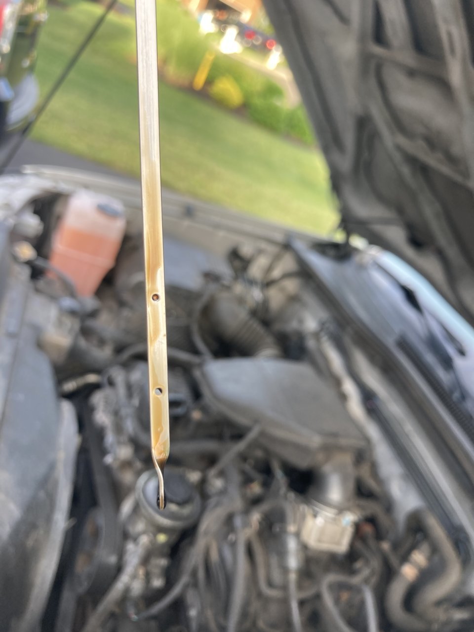

    This is how it looks after driving a little over 20 miles, so the engine is very hot here...

    I check my oil with the engine cool after it has set for a few hours.
    Then pull the stick, wipe it down, reinsert it, pull it back out and check.
    Sure you can check it warm, but I like for all the oil to run down in the pan to give me a more accurate reading. Plus, heat rises and I don’t like fooling around under the hood when the engine is warm if I don’t have to.
    wi_taco and PennSilverTaco[OP] like this.

    How does the oil level look in the above pictures?

    Hard to tell.
    It’s smeared up the stick.
    Looks likes it’s in the middle if I were to use my best judgement looking at the photo.

    either measure cold on first pull of the stick. Or if hot after its been shutdown for awhile (oil does have to drain back to the pan). Pull the stick out, wipe it off, LEAVE IT OUT for 5 min or so for the oil to drain back down the tube. Insert all the way and pull out to check.
    The problem you see there is there is oil from running or previously pulled out wet dipstick that gives all sorts of false readings on the stick as it has oil on it from inside the dipstick tube.

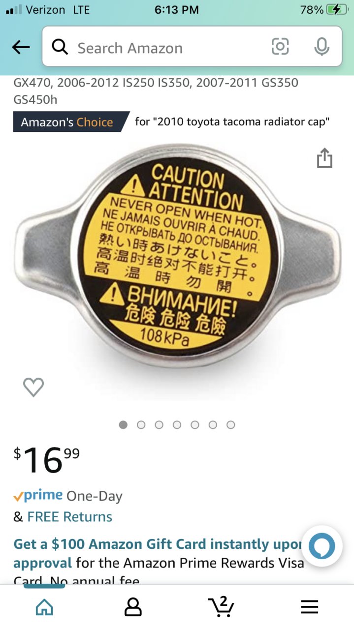

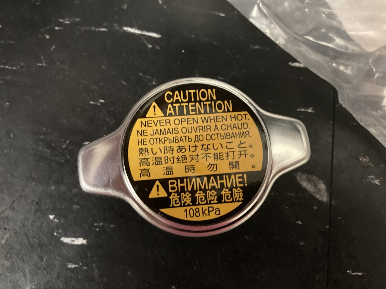

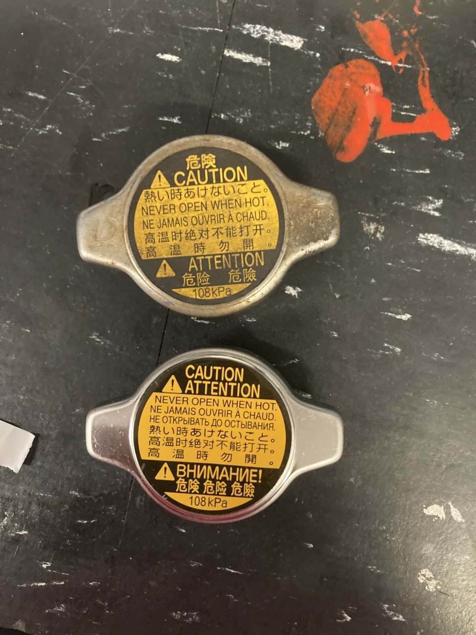

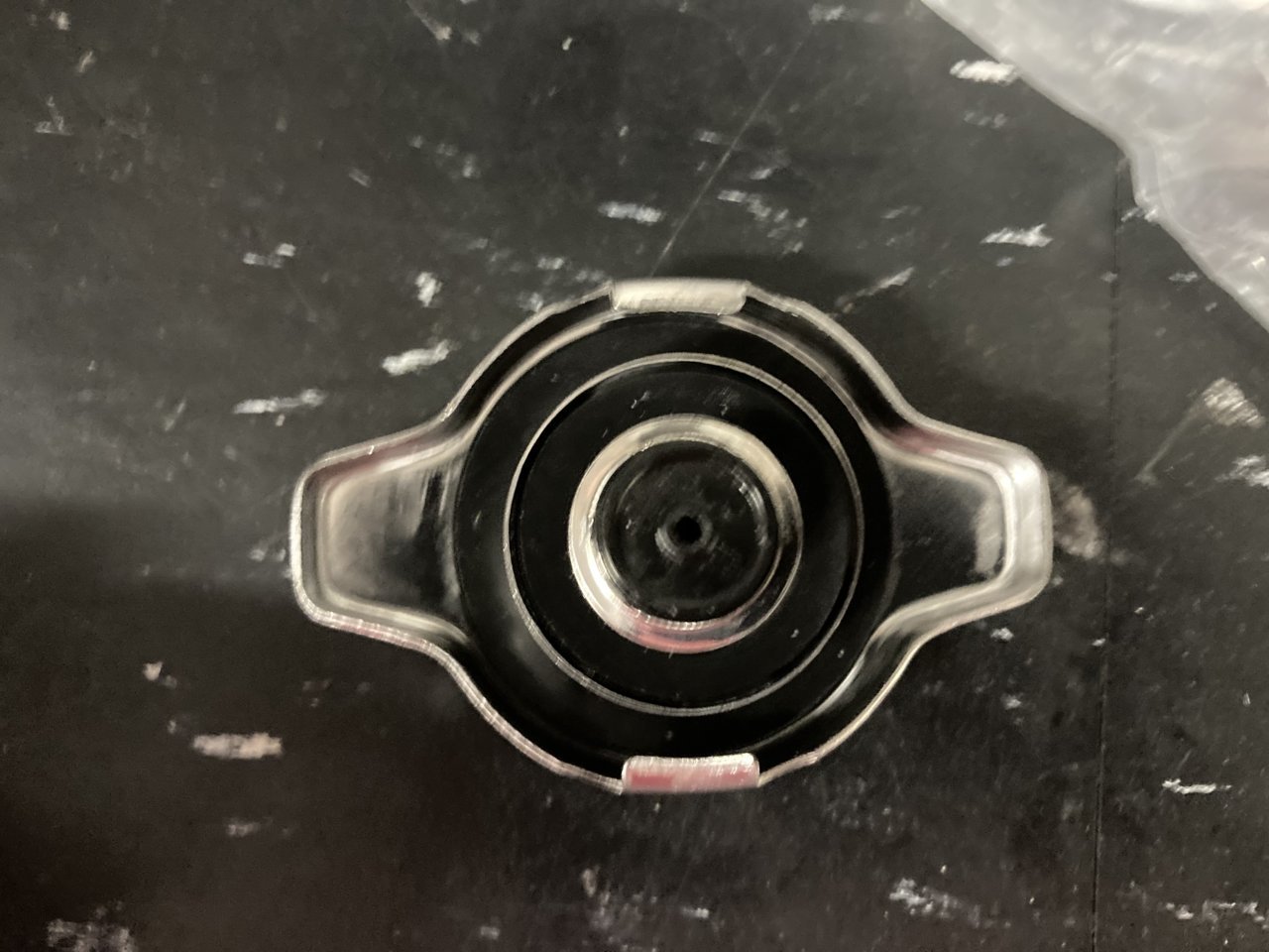

    Off-brand Amazon radiator cap...
    3B254DDD-5068-4BEF-A227-F523D5D72896.jpg 19834B21-9EBC-4751-BC6E-395887DCDBA1.jpg
  17. Jun 30, 2022 at 7:12 AM
    PennSilverTaco
    PennSilverTaco [OP] Encyclopedia of useless information...
    Jul 15, 2014
    #134007
    72,255
    Charlie
    Central Bucks, Pennsylvania
    2010 Zombie Truck 2002 PT Cruiser

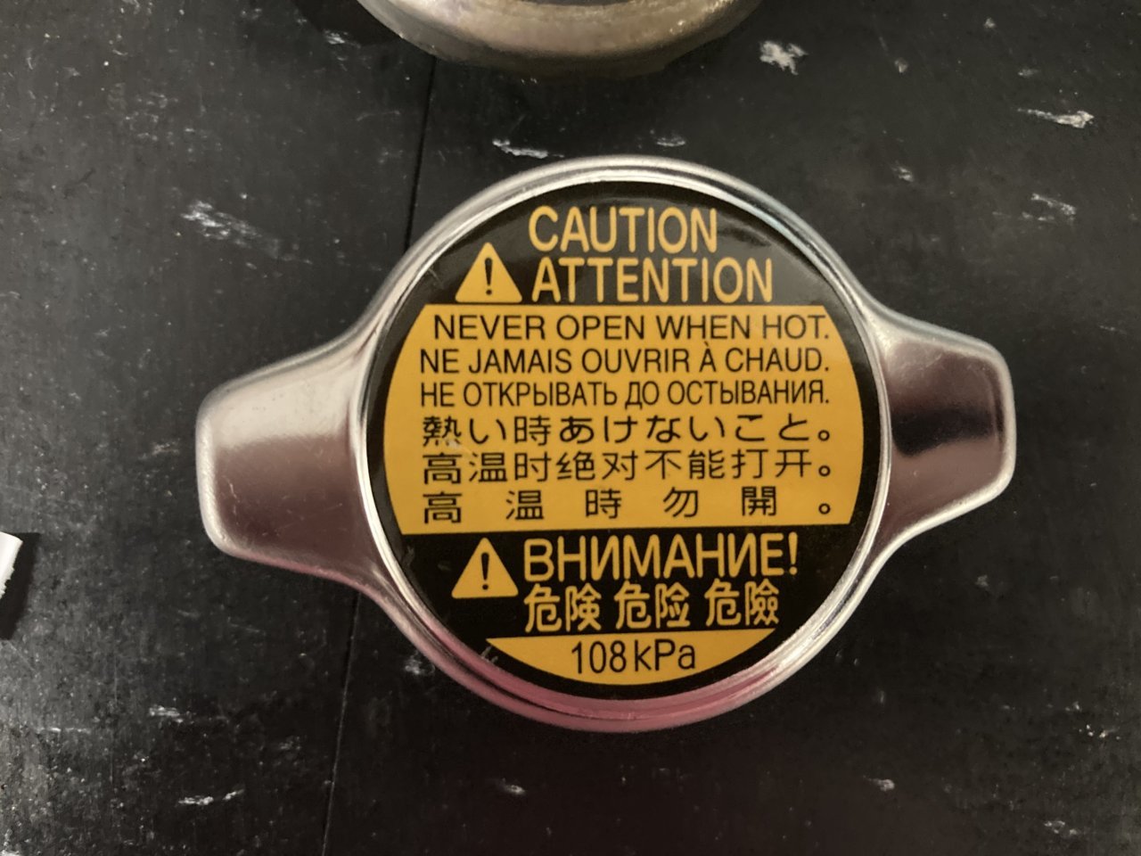

    Comparo...
  18. Jun 30, 2022 at 7:13 AM
    PennSilverTaco
    Jul 15, 2014
    #134007
    72,255
    Charlie
    Not much of a difference, except "ATTENTION!" is in a different language on the new one...
