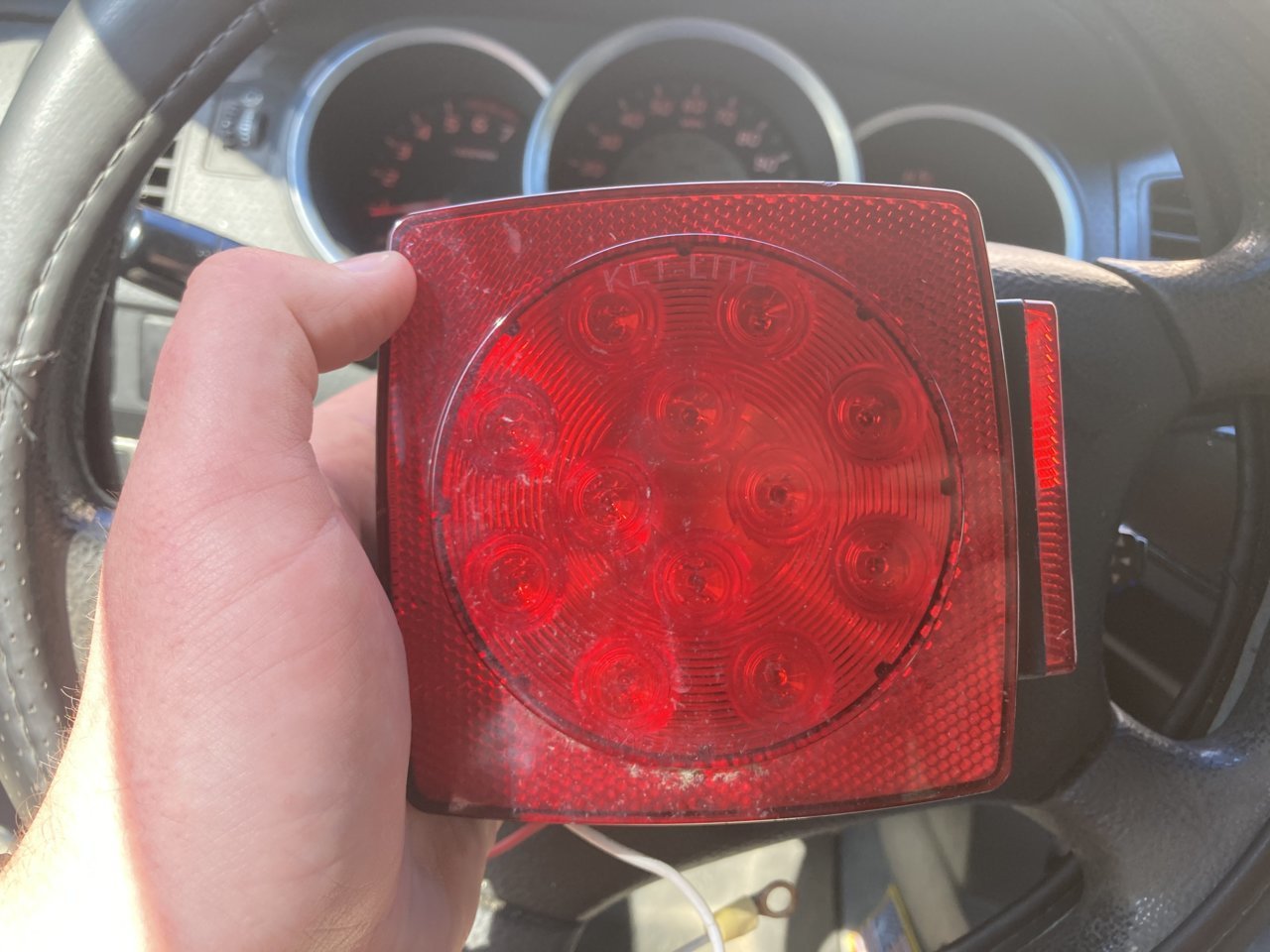

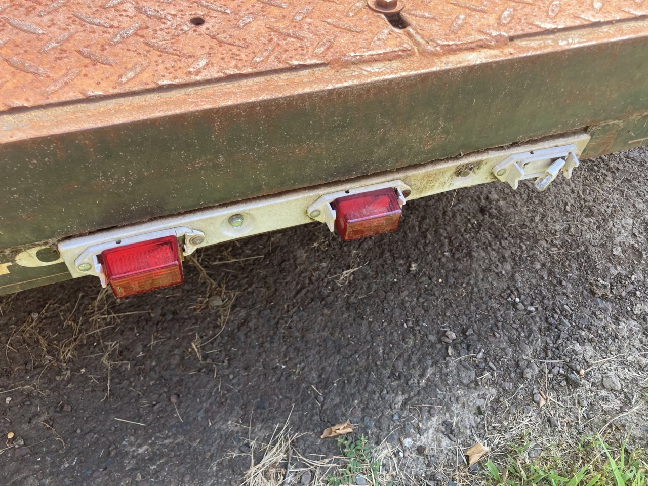

    Here is the passenger side light/turn signal that does not work; I was thinking that all I had to do was replace a bulb, but the thing is sealed, and gaining access to the bulb would require destroying the entire assembly. So, off to AutoZone I went with the trust corporate credit card in my possession...

    New taillights (They did not have a single passenger side taillight, so I bought a 2-pack)...

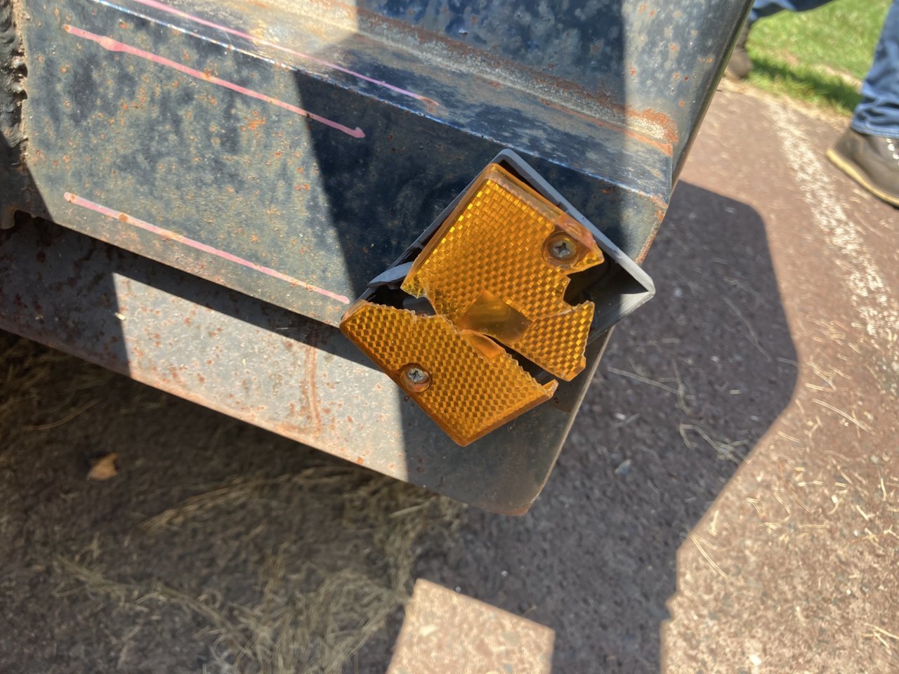

    The side marker works, but it's smashed, so it's getting replaced too...

    That right rear clearance lamp works, but has no cover, so it's getting replaced too...

    And no electrical project can be completed without the venerable butt connectors! :D

    And then you get to fix it again next year. :frusty:

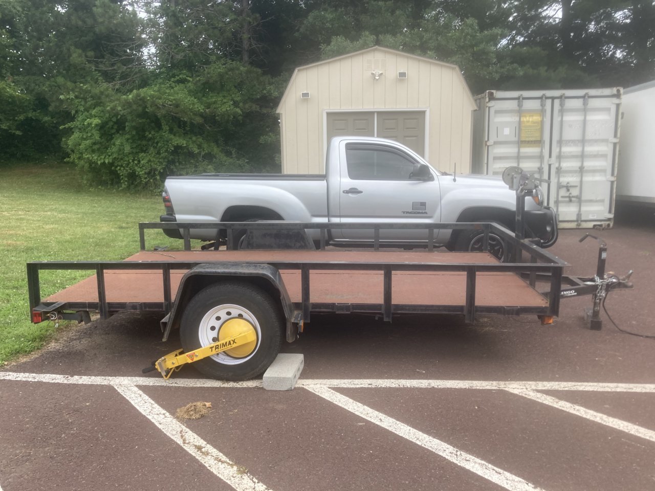

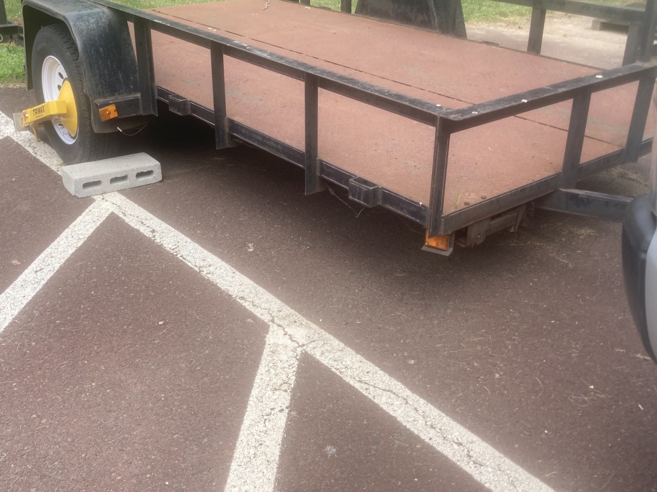

    Well, I'm getting paid to fix the trailer and my employer is paying for the parts, so it doesn't really bother me...

    What's more amazing is that after nearly 13 years and just over 154K miles, my truck is actually going to tow something, even if it is a short distance...

    The older one gets the less attractive repairing things a second time becomes.
    Water gets in the the butt connector and corrodes the wire -- the light quits working either far from home or just before you want to leave. You will do a better repair if you seal the connector with some RTV -- after you have tested your work.

    I would save those for temporary/emergency use.
