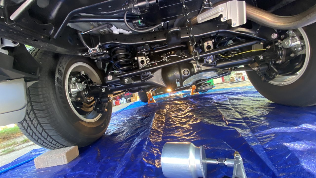

    You can save a LOT of money over the course of a few years by buying it by the [what passes for a] gallon and spraying it on yourself. I do mine each year, and am very liberal with the application. I would estimate that I get ~5 years from one "gallon" can. And as an added bonus, if you don't already have a compressor and/or undercoating gun, now you have a reason to buy them!

    6B839C82-E9DA-423D-973E-C34C4804A081.jpg I may have overbought last year. 1 gallon will go way farther than you would think. We hit 3 Tacomas and a 4Runner with 1 gallon and still had some left in the can.
