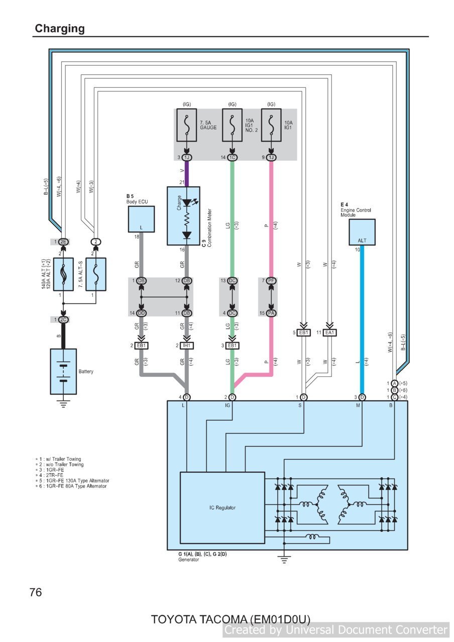

    I believe the battery light doesn’t actually come on with a weak battery. The battery light is basically a charge warning light. The light comes on when the alternator is failing to charge at an appropriate rate.
    It’s been a while since I actually studied the workings of the light. But best I remember, the battery light doesn’t come on just because of low voltage at the battery.
    There’s actually a terminal on the on the alternator it’s self that controls that light.
    @Dm93 or @Bishop84 can confirm this.
    As I’d actually like to know “for sure” if this is how it works. And if so, I think the battery light should be changed to a charge warning light. :rofl:

    Correct the alternator controls the battery light by grounding the L terminal, the only other things that could cause the light to turn on are if that wire is shorted to ground or the instrument cluster is malfunctioning.

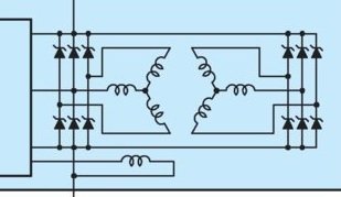

    the lamp positive is connected to a fused +12V source and the negative is connected to the cathodes of the diode trio in the alternator which provides the feedback to the VR. With a failing alternator the output of the diode trio falls further towards 0V and provides enough potential to light up the battery lamp which is actually a charge indication lamp in reality.

    Now, I just have to know what a diode trio is to exactly how it works. :rofl:
    But never the less, you and DM93 answered my question.
    The light doesn’t come on due to battery state, it’s charge state.
    Thanks guys!
    burrito782 and Dm93 like this.

    It's basically a rectifier bridge that supplies DC power to the voltage regulator for the field coils.

    In other words...
    This
    Equals
    This
    #science&stuff

    technically those are the output diodes, the diode trio is only a half wave bridge rectifier. But yes, science indeed

    Ahh, Now is see the problem. The squiggly lines and triangles are broke.
    Makes perfect sense :rofl:
