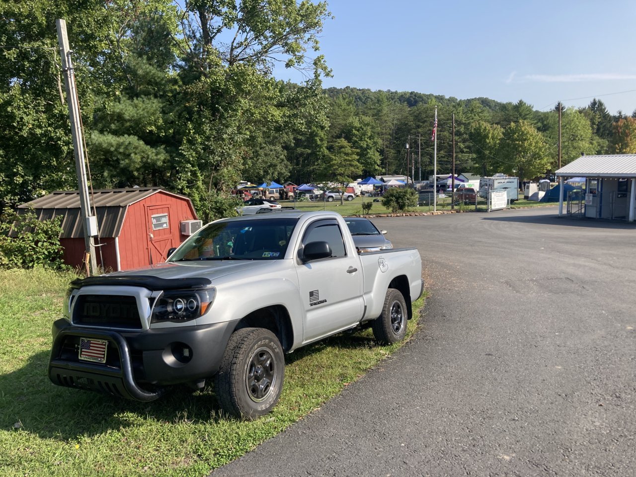

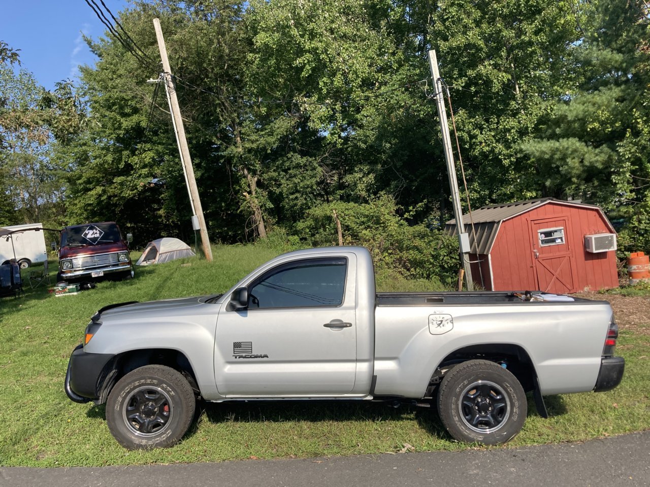

    Just arrived at one of the biggest van shows in the Northeast!
    9C2CC7BE-13DC-4CF3-AC1D-E7FF821E7658.jpg 3A62D49B-3257-43B8-9594-BA75D1B28A86.jpg
