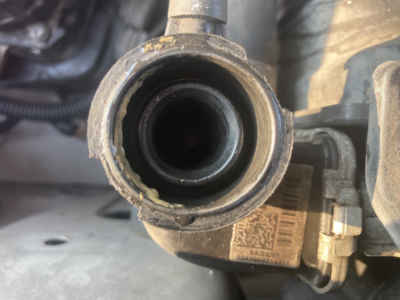

    But why did it have to do this right before we go to Massachusetts?!?!

    Man, I don't know, but that sort of thing happens to me too.
    If it is possible, it might be best to buy Jim's Ridgeline, and keep your truck as well. I know people hate on them here, but they are great vehicles, just balanced more for what people do 95% of the time.

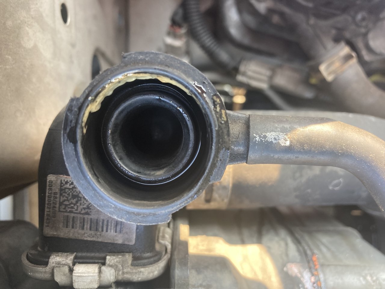

    I was expecting to see directly down into the radiator...

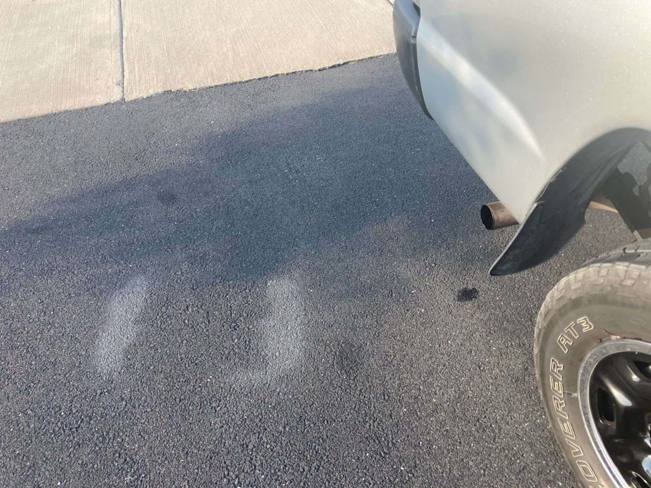

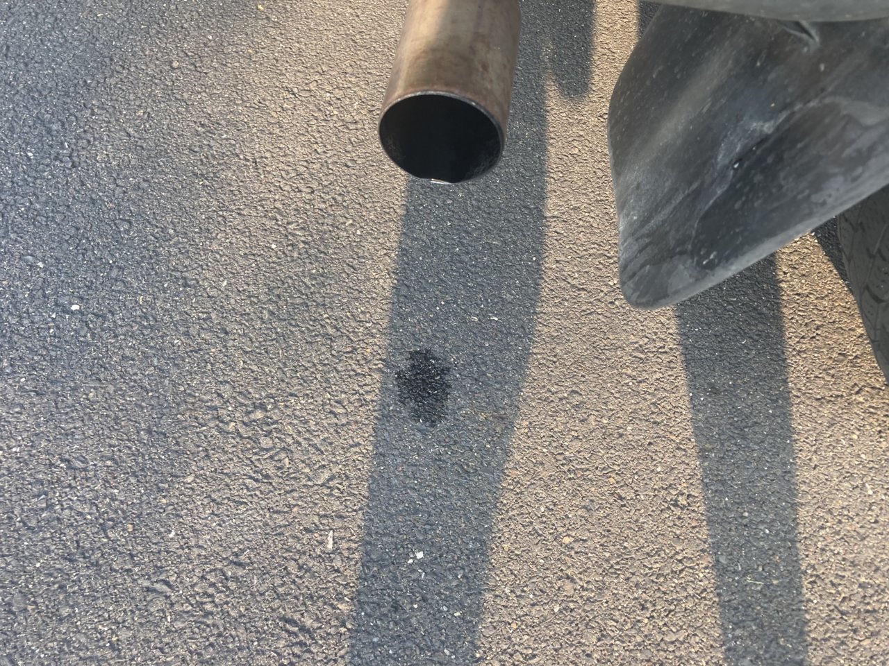

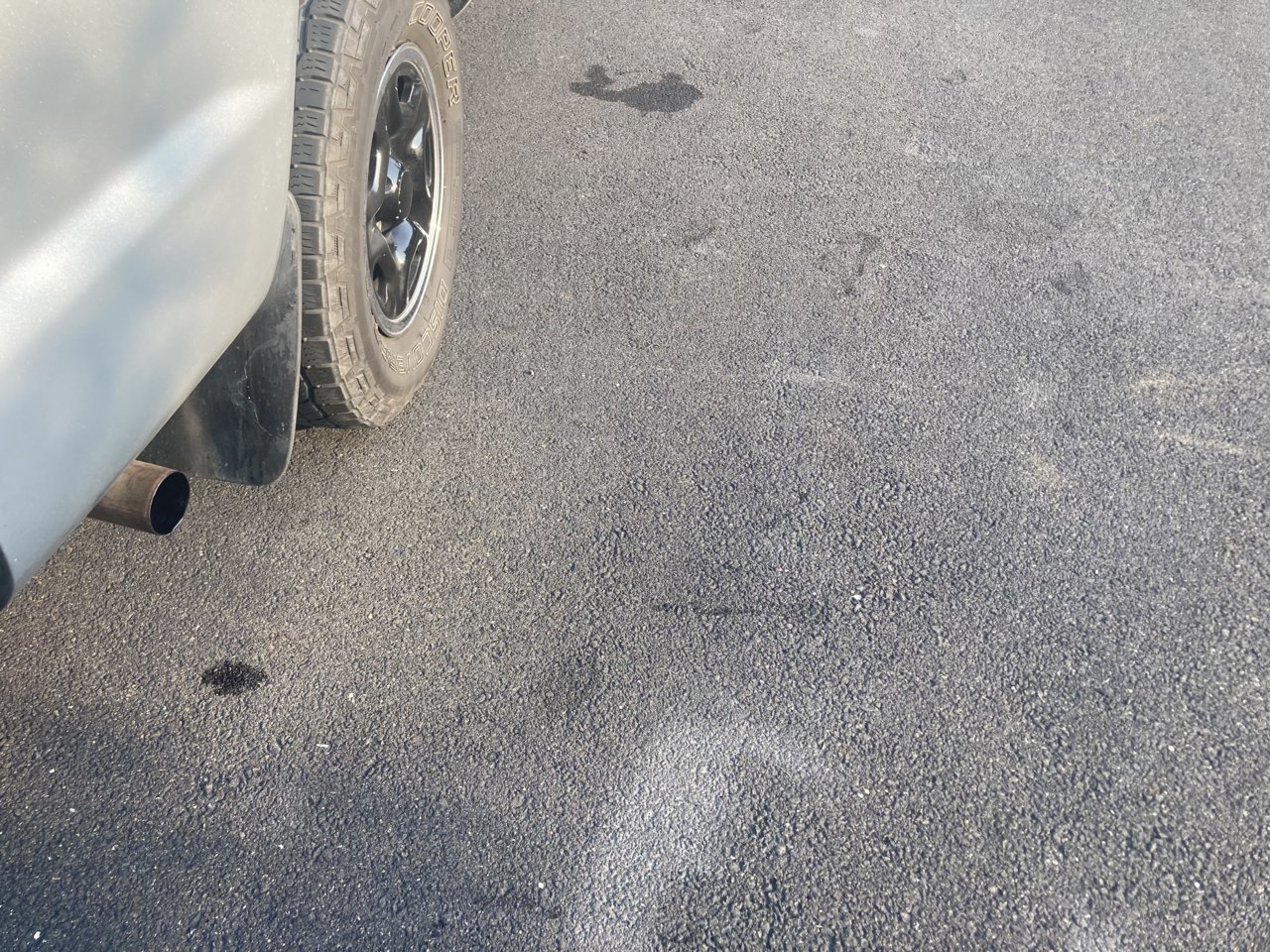

    I also don't know how well anybody can actually this, but my truck produces sorta white exhaust on startup...

    Aside from the fact that I am sitting in the truck with the door open and no seatbelt on, no warning lights...

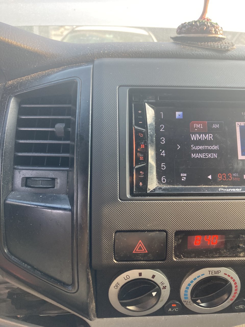

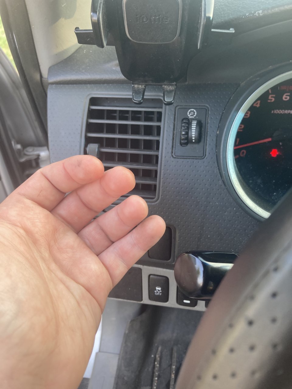

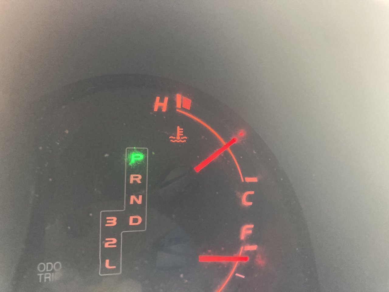

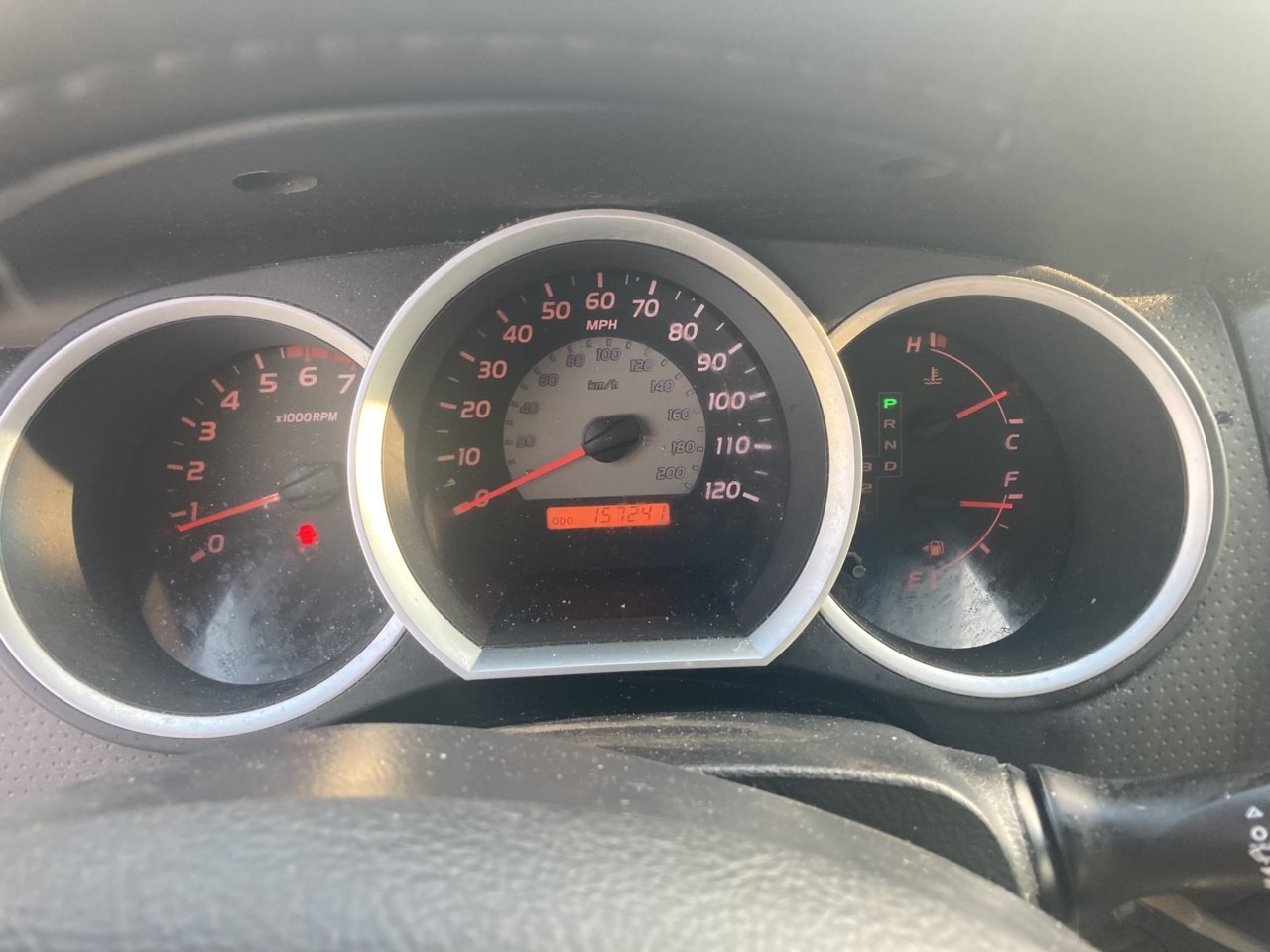

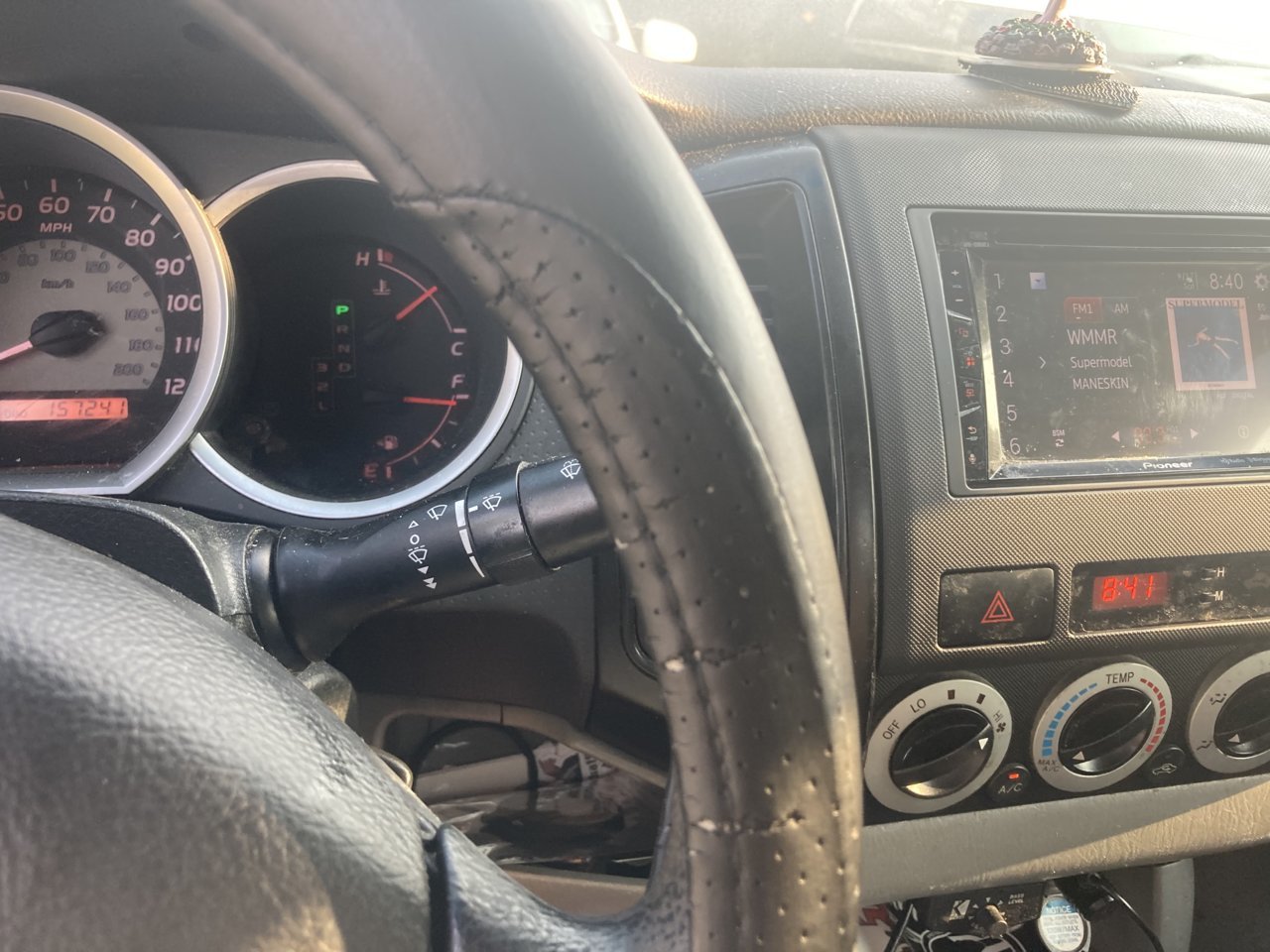

    Anyway, back to business. The truck is at normal operating temperature and the heat still isn't working...

    @ColoradoTJ
    Again, I can't see anything...
  9. Sep 18, 2022 at 5:40 AM
    b_r_o
    b_r_o Gnar doggy
    Nov 17, 2016
    #202672
    14,827
    Alex
    WA
    2015 DCLB
    The coolant level is low. Fill it up and see if the heat comes back.
    Then find where the leak is. If no external leaks are found then the headgasket is suspect

    I feel like the heater wants to work, as there's like a slight hint of of warmth, but it is just blowing cold humid air...

    Then, why is there a of coolant in the reservoir?

    Also, why am I able to idle with the A/C cranked and not overheat the truck? the A/C works just fine... :cool:

    get foamy engine degreaser and wash out your whole engine bay.
    this way, you can see if there's a leak (powdery white dried up coolant) you won't find a leak in a dirty engine bay.
    drain your coolant, fill with distilled water, add a spoon of dish soap after filling with water.
    idle until the guage is 1/3 hot.
    let it cool back down and drain.
    fill again with distilled water and same process. this way, you are fully flushing, better than any shop will do.
    fill and burp with pink coolant.
    residue could be stuck in your heater core. or whole system
    replace the radiator cap. it's only $20
    this should start your elimination of what is not the problem.
    do you have a misfire code or a wet spark plug? check them all .

    The overflow reservoir only works as designed if there are no leaks anywhere
    The coolant expands into the reservoir when it heats up, when it cools back down it gets sucked back into the radiator. But if there's a leak somewhere else in the cooling system it'll suck air instead of the reservoir coolant. That's why checking coolant level at radiator is more helpful when dealing with a possible leak

    There's obviously enough coolant in the system to keep the truck from overheating with the A/C on though?

    But when you get out on the road and start driving it's a different story

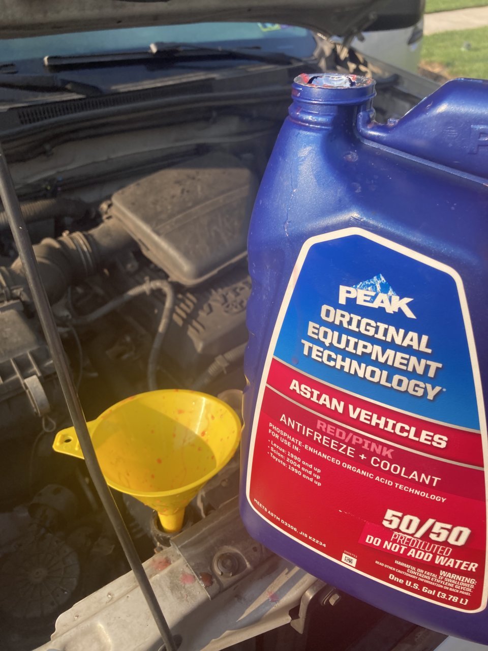

    Ok, coolant does slowly over time, just evaporate.
    If the reservoir was low, it could of sucked in air as it cooled over time on shutoff. Fill the tank with water, and the reservoir. It will need changed anyway, and if there is a problem, no need to worry about perfect mix today. Run it and watch.
