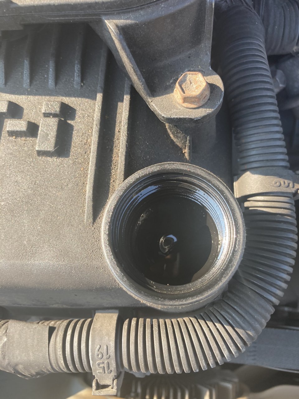

    small head gasket leak won't necessarily cause a misfire.
    look for wet spark plugs.
    check engine oil level and color/viscosity
    open oil filler neck and look for foamyness

    I checked the oil last night and it looks good. No signs of coolant being present...
