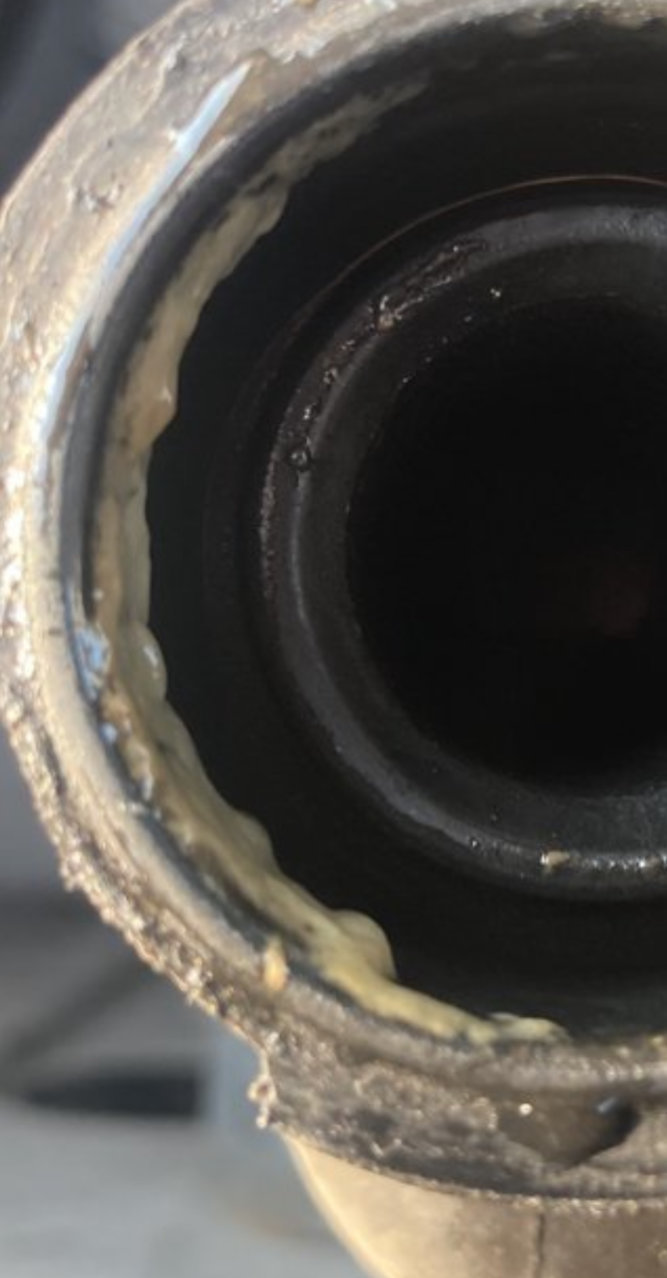

    Waasheem
    Waasheem The catholic radio bear
    Jun 26, 2019
    #297494
    2,819
    Waasheem
    2007 xrunner
    This could be the cause of that so possibly not a head gasket. Trying to think positive and send some good juju your way.

    TnShooter
    TnShooter The TacomaWorld Stray
    Sep 2, 2010
    #42625
    21,183
    Deogee
    07' TRD Off-Road, Auto
    STOCK
    Wow! Been a long day for me. I’ve been busy.
    Sorry I haven’t checked back in sooner.
    I would NOT pull any plugs, nor would I do a thermostat, or anything else other than a cooling system test. And at that, you should let your mechanic do that test.
    As for why The coolant was low, well there obviously a leak of some sort.
    Where the leak is, is to be determined by your mechanic.
    If I were you, I’d fix the truck. I would then drive the truck when ever I felt like it.
    There is no need in owning and paying for something, only to be afraid to use it.
    If you are worried about doing doordash and such, you need to sit down and take a look at the income it is providing you. If it’s not enough to cover wear and tear plus profit, don’t do it.
    The fact is, your head gasket blew (maybe).
    This isn’t common on a 2.7L truck with your mileage.
    It just happens. it’s one of those things that happened, and you weren’t going to control it.
    Again, I say you should drop that baby off and ignore the whole situation until you get back from your trip.
    Look at this way, sometimes it’s better to know it is broke, than to not know, and worry about “IF” it will break.
    I had an old guy tell me once, “Never worry about “if” things will wear out and break. Because they all do. Time kills everything.” Make the best of what you got, in the time you have it. :thumbsup:

  11. Sep 18, 2022 at 6:09 PM
    Delta09
    Delta09 Requires Supervision
    Apr 29, 2019
    #291677
    13,180
    Adam
    South Central PA
    2024 SR5 DCSB 4WD
    Hey Charlie, don't overthink or worry too much about this just yet. I had a Nissan Frontier with the 4.0 that was pretty damn sensitive to coolant level and heat. I'm wondering if there wasn't just a big bubble in the coolant system that just didn't rear its head until it has recently got cooler here in PA. I see you added coolant and the heat returned to "normal". Just keep an eye on it and drive on for a little bit. I highly doubt you have any coolant passages blocked as I can tell you're pretty anal about maintenance on your truck. Looks like coolant and oil isn't mixing so even if the head gasket is going, you shouldn't be in immediate danger and can get further diag down the line.
    wilcam47 likes this.
