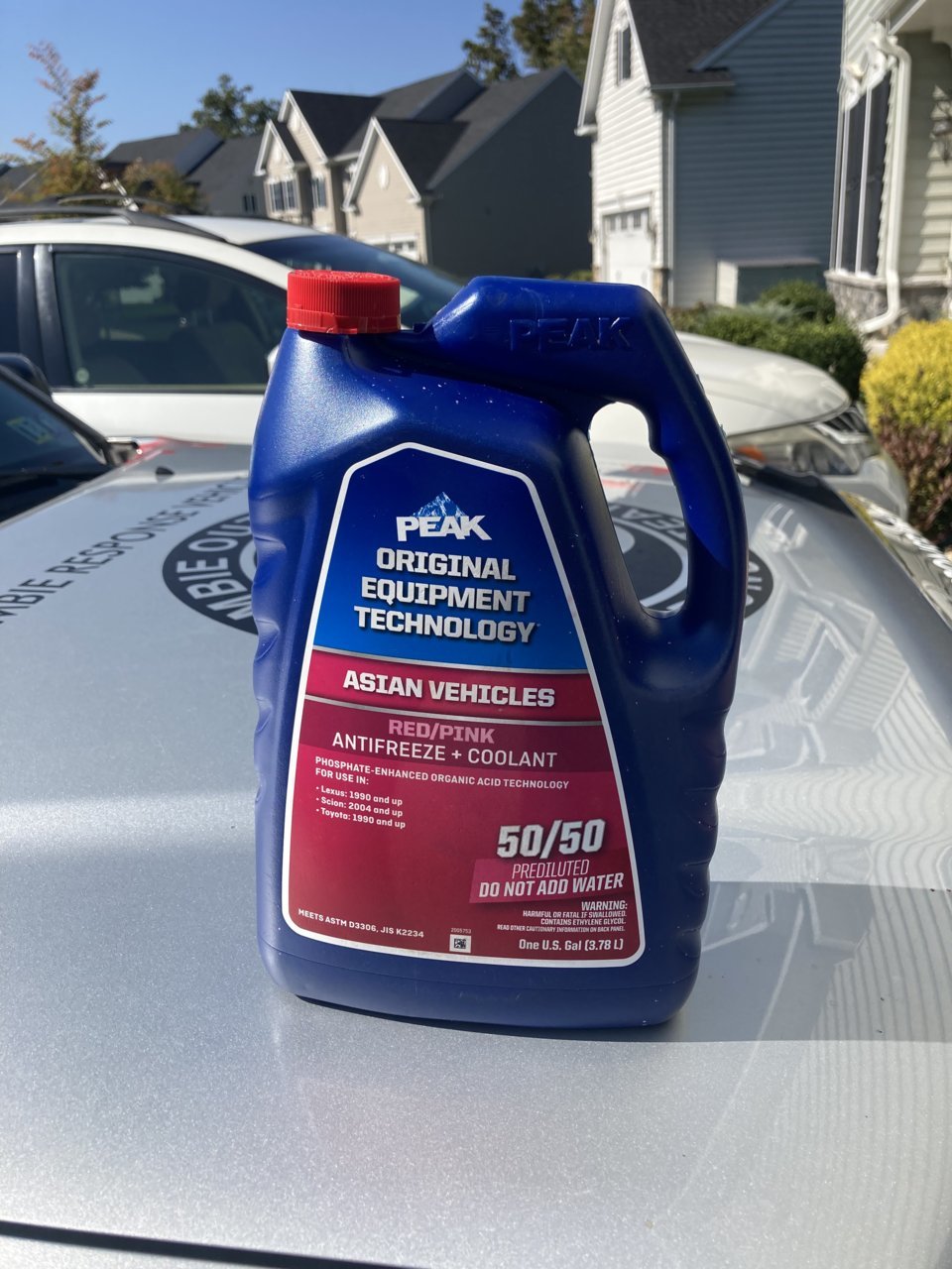

    @Plain Jane Taco
    Peak is what I've always kept on hand in case of emergencies...
    Plain Jane Taco and shakerhood like this.
