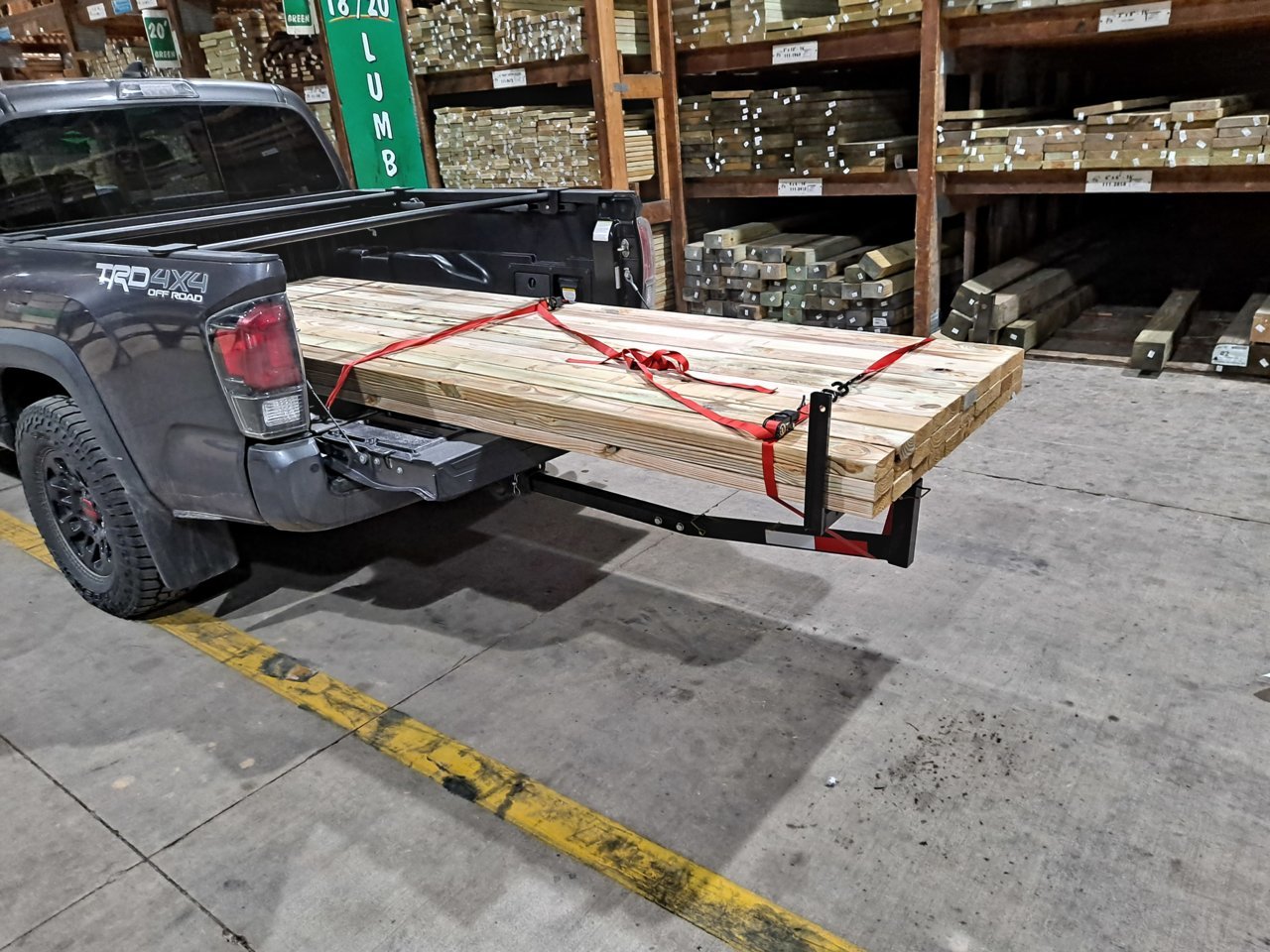

    Bill, what was your experience been with having a shorter bed? Access cab 3rd Gens are fairly hard to find, so I'm thinking that I might have to settle for a DCSB if it's a really good deal.

    I was a little worried at first but added a hitch extender and bed bars, so hauling has never been an issue.
