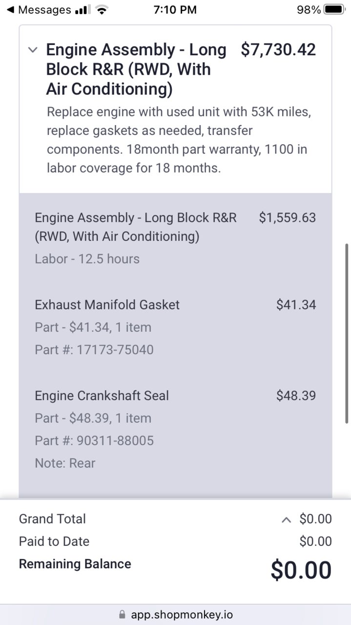

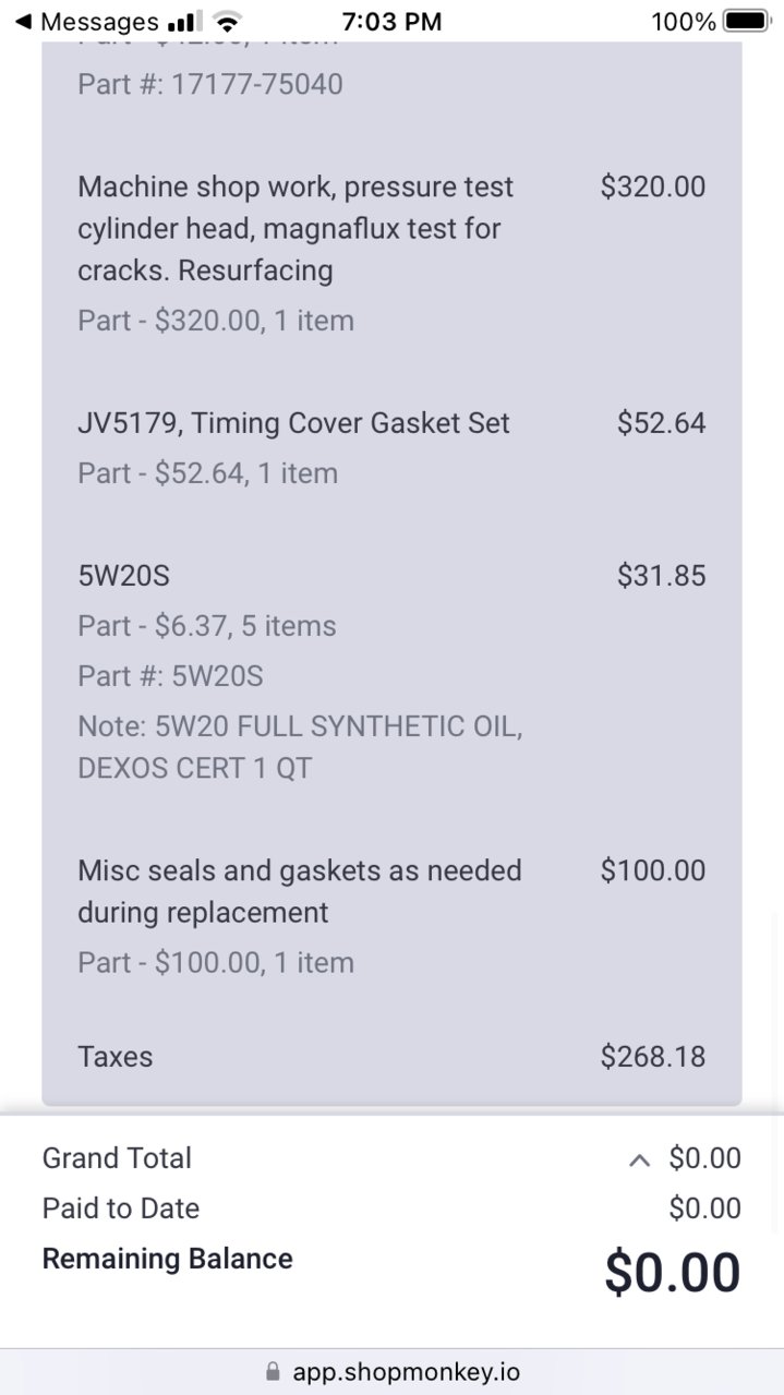

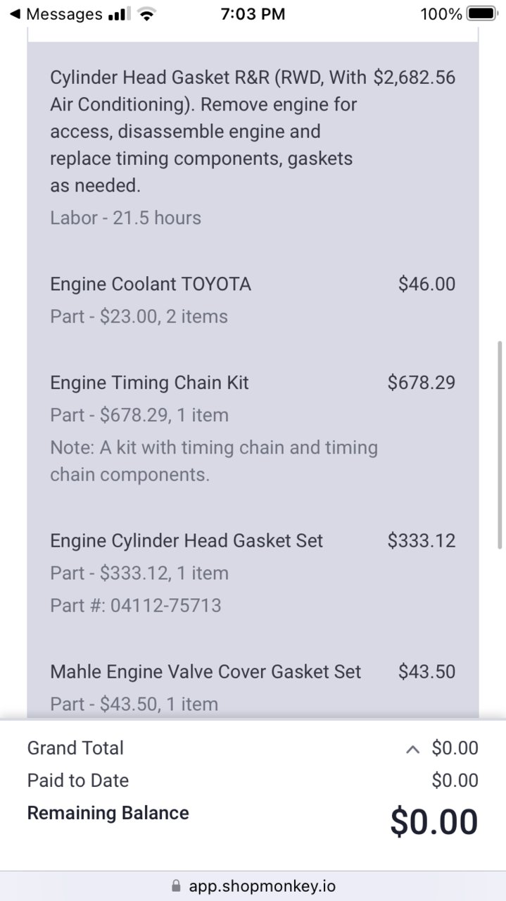

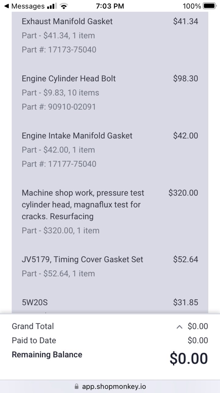

    Once again, this is from Pete...
    3817769F-33FF-4FA7-8669-D52ED1B5FA41.jpg 73E7ADE6-DAE1-4B9F-BA18-5DB3D326A852.jpg DFA98D82-41BD-427D-8B16-7F8D5C8C7605.jpg

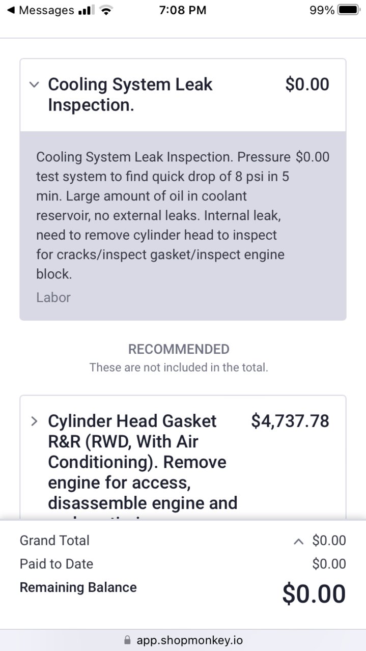

    This was the result of Pete pressure testing the system this past Monday...

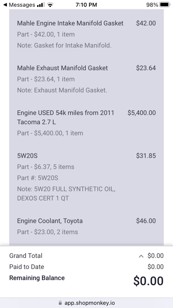

    This is just putting a used engine in the truck, and the only reason this is being considered is because the frame and numerous components were just replaced a year ago; I would not use the dealer for an engine replacement unless I could supply this engine and they could come close to what Pete is charging in labor and other parts. Note that the used engine is from a Tacoma one model year newer...
    38571710-023A-49F1-9668-2407D99BD47F.jpg 2A9FEA8F-7783-49F6-8D95-ABCC45D866C2.jpg 6C98EA66-9B4D-4F25-868E-111DEA8A9261.jpg
