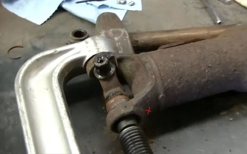

    A kit like this makes the job a lot easier:
    Use it like this:
    wilcam47 and TnShooter[QUOTED] like this.
