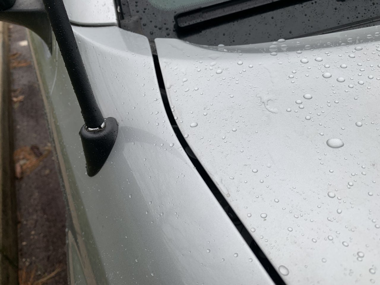

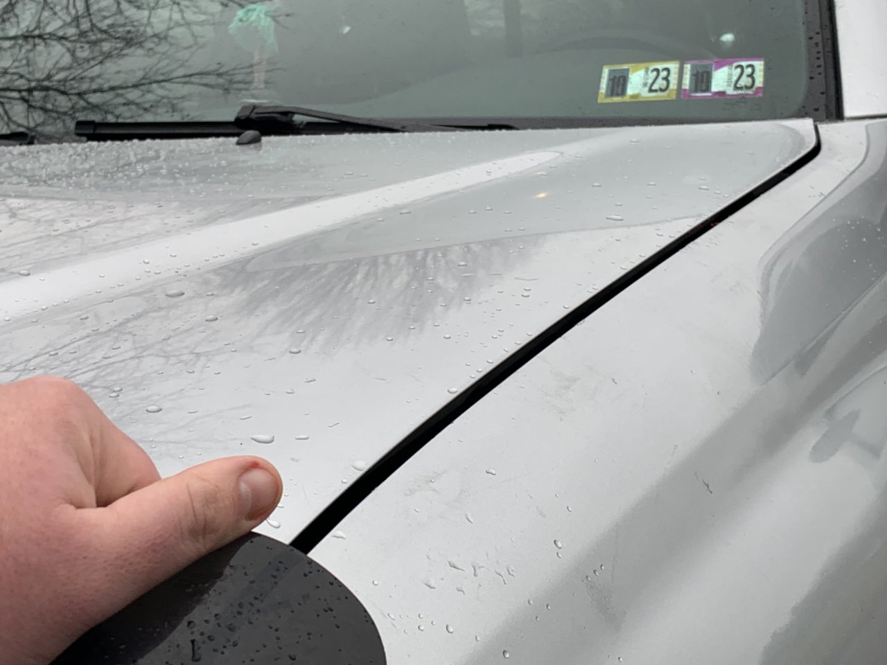

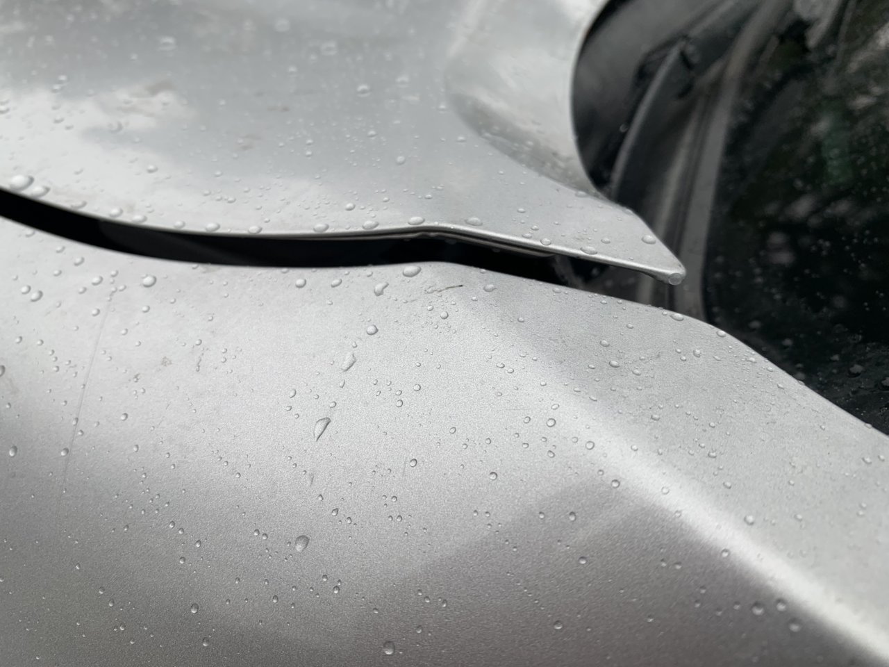

    I have had the "hood flutter" at high speeds for years now, but I just noticed in December 2022 (after I put the Christmas lights on) that the left corner closest to the windshield was jutting up...
    shakerhood and Taco critter like this.

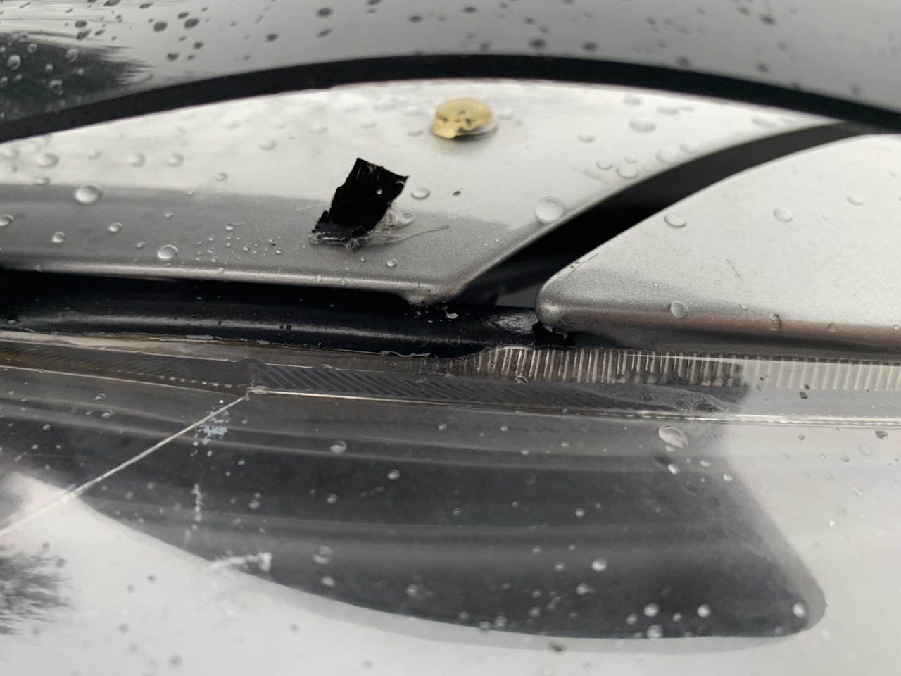

    The front of the hood is very loose...
    wilcam47 likes this.

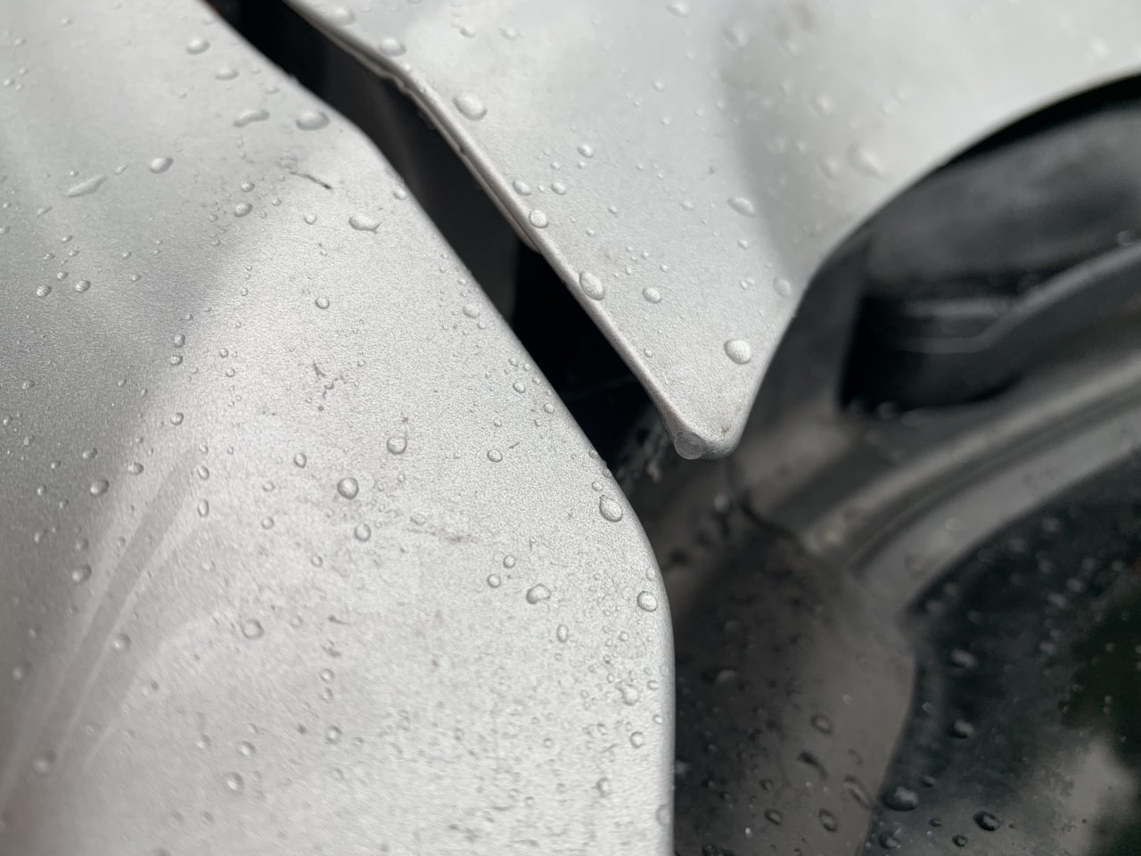

    Right upper corner for comparison purposes...
    shakerhood likes this.

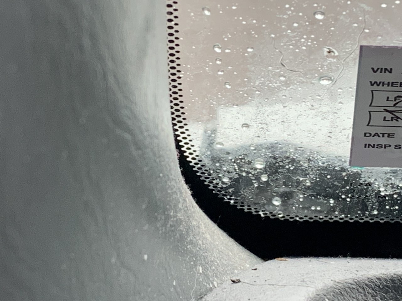

    View of upper left corner from inside truck...

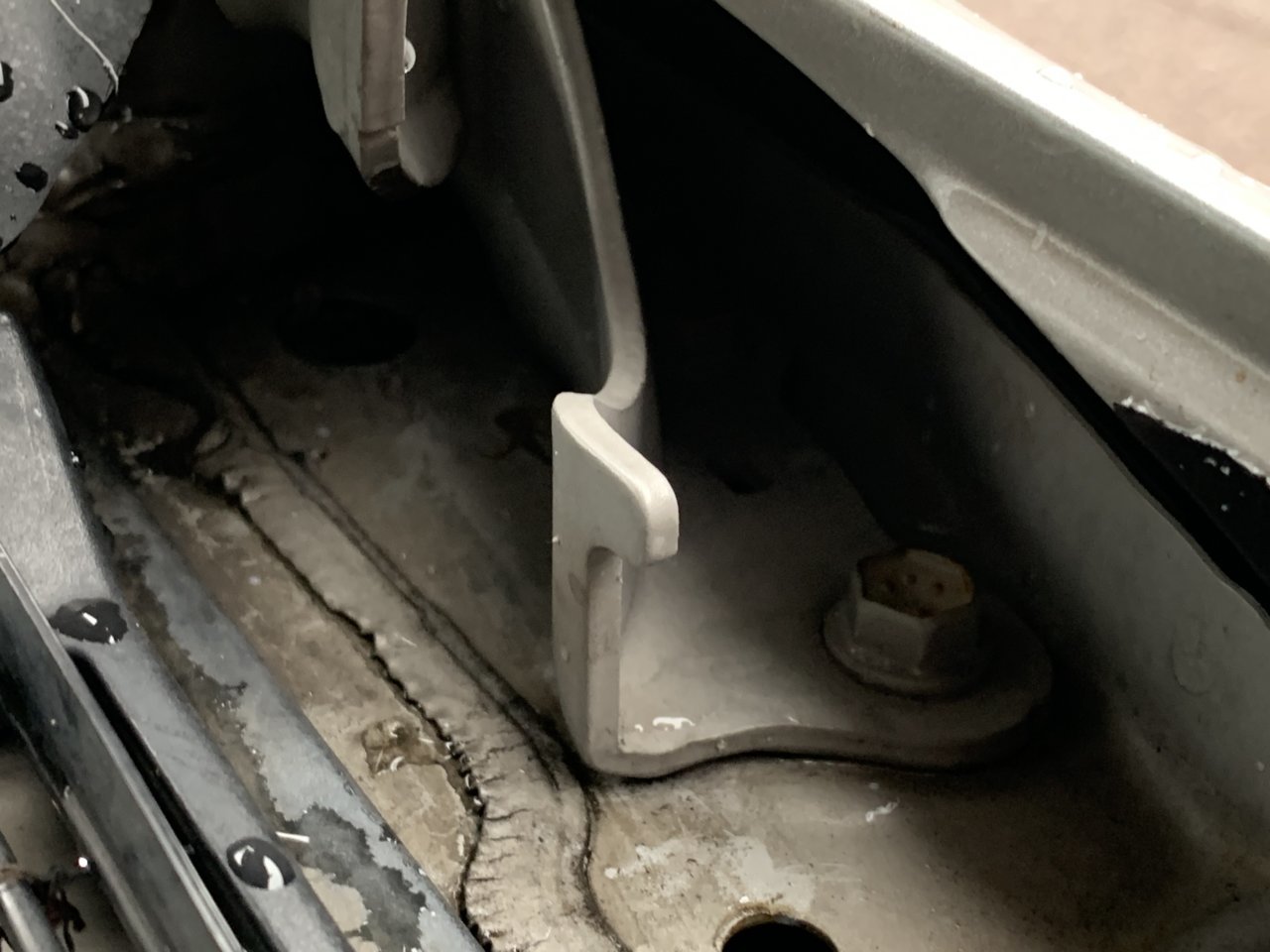

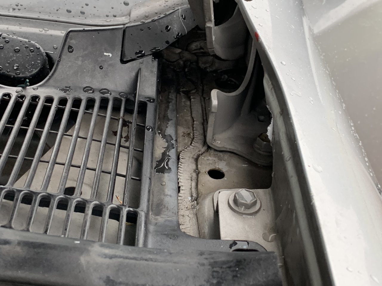

  7. Jan 3, 2023 at 11:38 AM
    PennSilverTaco
    PennSilverTaco [OP] Encyclopedia of useless information...
    Jul 15, 2014
    #134007
    72,797
    Charlie
    Central Bucks, Pennsylvania
    2010 Zombie Truck 2002 PT Cruiser
    Bolts seem to be fine...

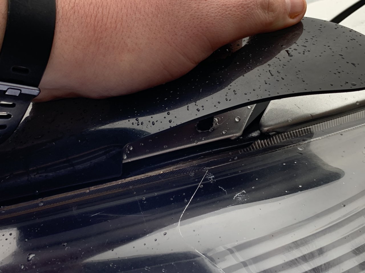

    Once again, the left side is very loose...

    They didn't feel loose, and the bracket is flush to the underside of the hood...?

    The hood was never damaged in an accident, and I literally noticed it after I put the Christmas lights on for the holiday season. There is a ziptie holding the grille together where I haven't gotten around to gluing it yet, but that definitely isn't what's causing this. I think something probably does likely need to be tightened, and I guess I'll have Pete do that. It looks like shit, but it does not seem to be a safety issue...

    Pete fixed it; I was afraid to push down on the hood, but Pete determined that the hinge was bent and just pounded on it until it lined up.

    If the hood is loose in the front you can rotate the rubber adjuster up a little
