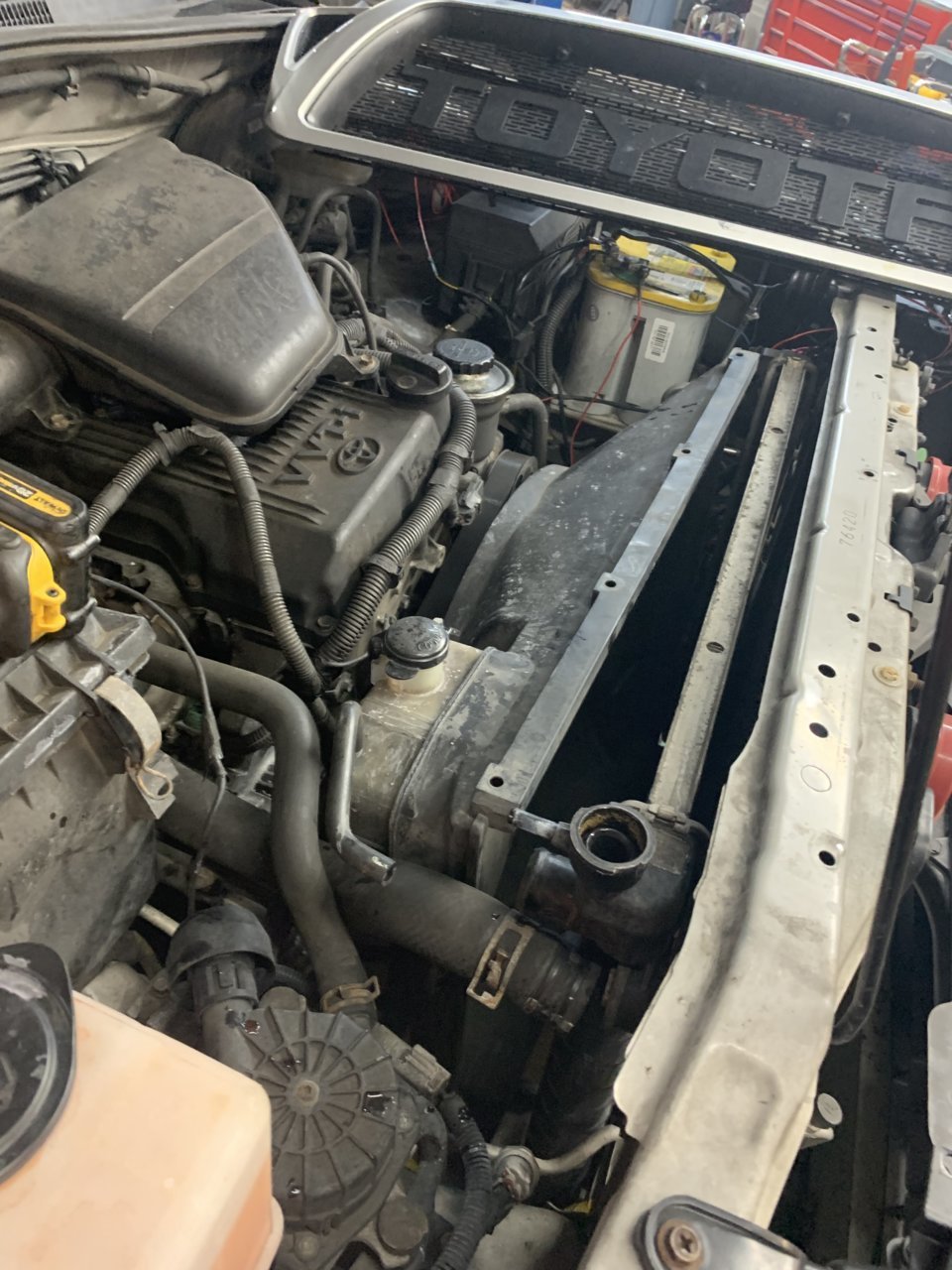

    We've definitely got us a problem, but thankfully Pete is gonna put in a new radiator tomorrow!

  15. Mar 31, 2023 at 6:44 AM
    PennSilverTaco
    PennSilverTaco [OP] Encyclopedia of useless information...
    Jul 15, 2014
    #134007
    72,822
    Charlie
    Central Bucks, Pennsylvania
    2010 Zombie Truck 2002 PT Cruiser
    85B136EC-565F-403A-A38E-FF2D010A2BCB.jpgAC9F3E93-C85B-4458-A77D-8666E33BC20B.jpg203503B9-EABF-4BB9-9F2A-A73088A795D3.jpg7E179473-04F4-45DE-ACCD-CC280AFE208B.jpgED923F4B-C23A-4250-88CF-E94FC7B099B7.jpg
  16. Mar 31, 2023 at 6:49 AM
    wilcam47
    wilcam47 Keep on keeping on!
    Jan 27, 2016
    #176243
    55,248
    Will
    Bourbon state
    Radiator cracked?
  17. Mar 31, 2023 at 6:54 AM
    PennSilverTaco
    Jul 15, 2014
    #134007
    72,822
    Charlie
    Pete discovered that a Toyota radiator is $25 cheaper than a Denso radiator, despite being the same radiator; I was willing to pay the extra money, but the Toyota radiator arrived before Pete commenced installation, so that's what it's getting...
    shakerhood, Taco critter and wilcam47 like this.
  18. Mar 31, 2023 at 6:55 AM
    PennSilverTaco
    Jul 15, 2014
    #134007
    72,822
    Charlie

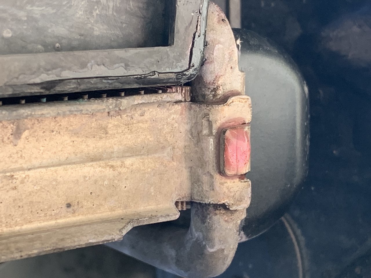

    Yup. Specifically, Pete believes this rubber gasket where the aluminum meets the plastic gave out...

    Old radiator...
    927B81E6-4978-45EB-84C3-CE1FD0BCBC72.jpg 6A7885C8-7D54-4BB5-A725-C5648810C99C.jpg 4204CDE0-4CDE-48DD-9C12-DAFE439414EF.jpg
  20. Mar 31, 2023 at 7:02 AM
    wilcam47
    Jan 27, 2016
    #176243
    55,248
    Will
    Bourbon state
    Yeah those arent very well designed, i had one that cracked, i just put a cheap replacement in it
