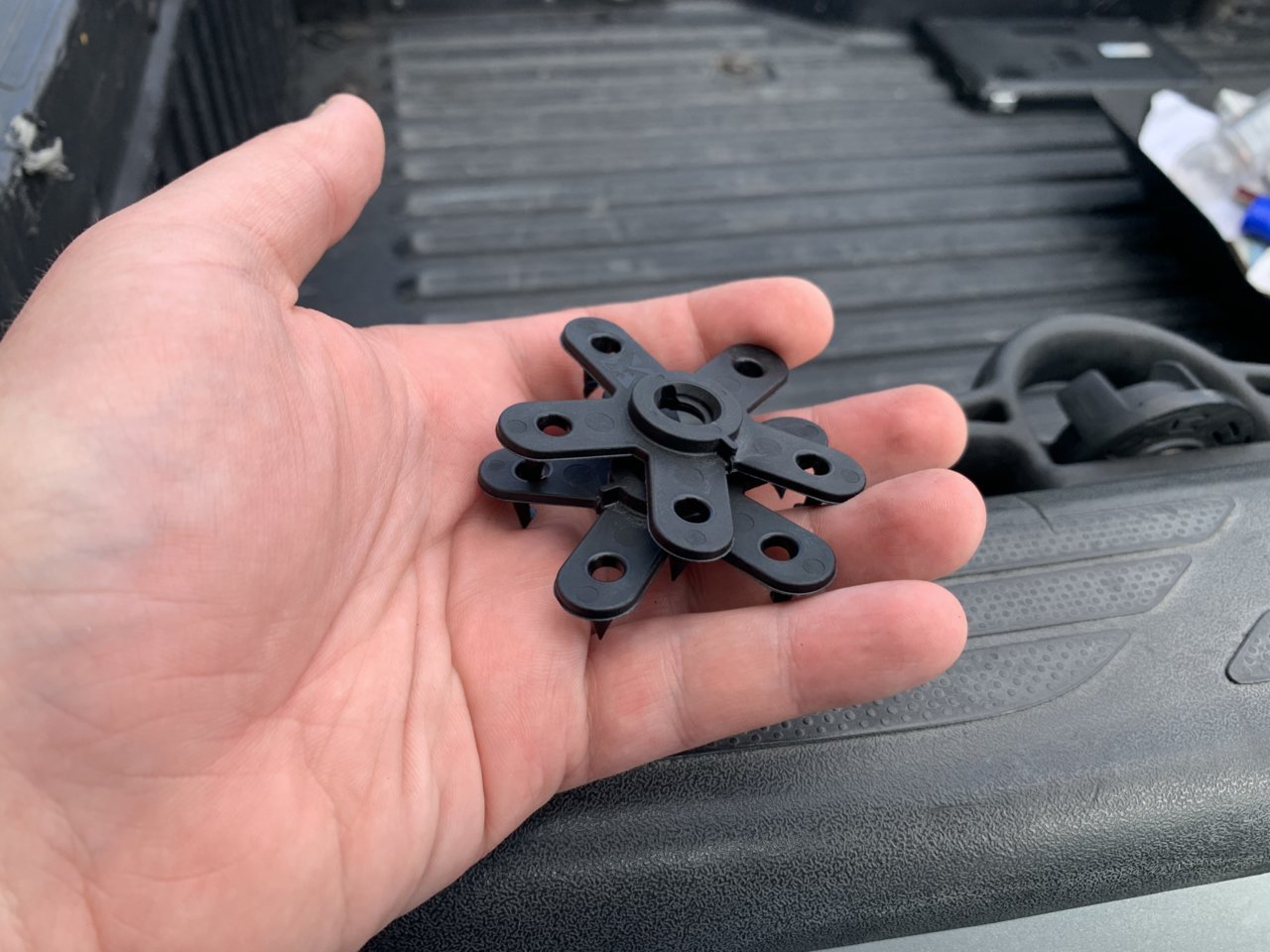

    I put these Eagle Klaw floormat anchors in yesterday...

    Girlfriend manage to kick the floor mat all over getting in and out?

    No, it had anchors but they ripped out and cannot be replaced without replacing the entire carpet; I plan on replacing the carpet eventually, but just the carpet alone is over $700...

    I would think there would be some less pricey carpet on the market, Tacoma's in general have a pretty good selection of aftermarket available.
