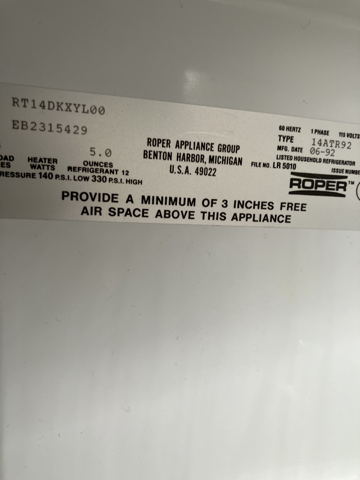

    I scored this nonfunctional mini fridge from one of my girlfriend's neighbors...
    65974688-943D-4E88-B19F-D0F0293235B2.jpg 092B4FA3-7398-480A-B9FD-437AF45352F8.jpg 9B06A5DF-A61F-4F58-8A44-EDCACCDEADA6.jpg

    It's less Tacoma and more mod
    Cyclopentane is really common, that is a hydrocrabon refrigerant, used in small/medium consumer appliances
  12. Jan 18, 2024 at 12:32 PM
    PennSilverTaco
    PennSilverTaco [OP] Encyclopedia of useless information...
    Jul 15, 2014
    #134007
    71,588
    Charlie
    Central Bucks, Pennsylvania
    2010 Zombie Truck 2002 PT Cruiser
    Would a full size freezer/fridge for the typical residential kitchen use it? We got our first fridge with R134a (and also our first fridge with a water and ice dispenser) in 1998.
  13. Jan 18, 2024 at 12:34 PM
    Speedytech7
    Feb 20, 2014
    #123587
    57,417
    3435 E Trent Ave, Spokane, WA 99202
    yeah for sure on the freezer, I'm not sure if a consumer fridge would or not. I'm sure some fridges do but I'm not sure the limit on size. Pretty much all freezer only units I see for sale are cyclopentane. It and R290 (propane) are nice because you can legally vent them to atmosphere.
  14. Jan 18, 2024 at 12:36 PM
    PennSilverTaco
    Jul 15, 2014
    #134007
    71,588
    Charlie
    R600a is legal to vent into the atmosphere?
  15. Jan 18, 2024 at 12:38 PM
    Speedytech7
    Feb 20, 2014
    #123587
    57,417
    yeah, the US allows venting of hydrocarbon refrigerants. R600a is basically the same as isobutane which is a common cooking fuel haha. Recovery equip isn't usually designed for highly flammables anyway
