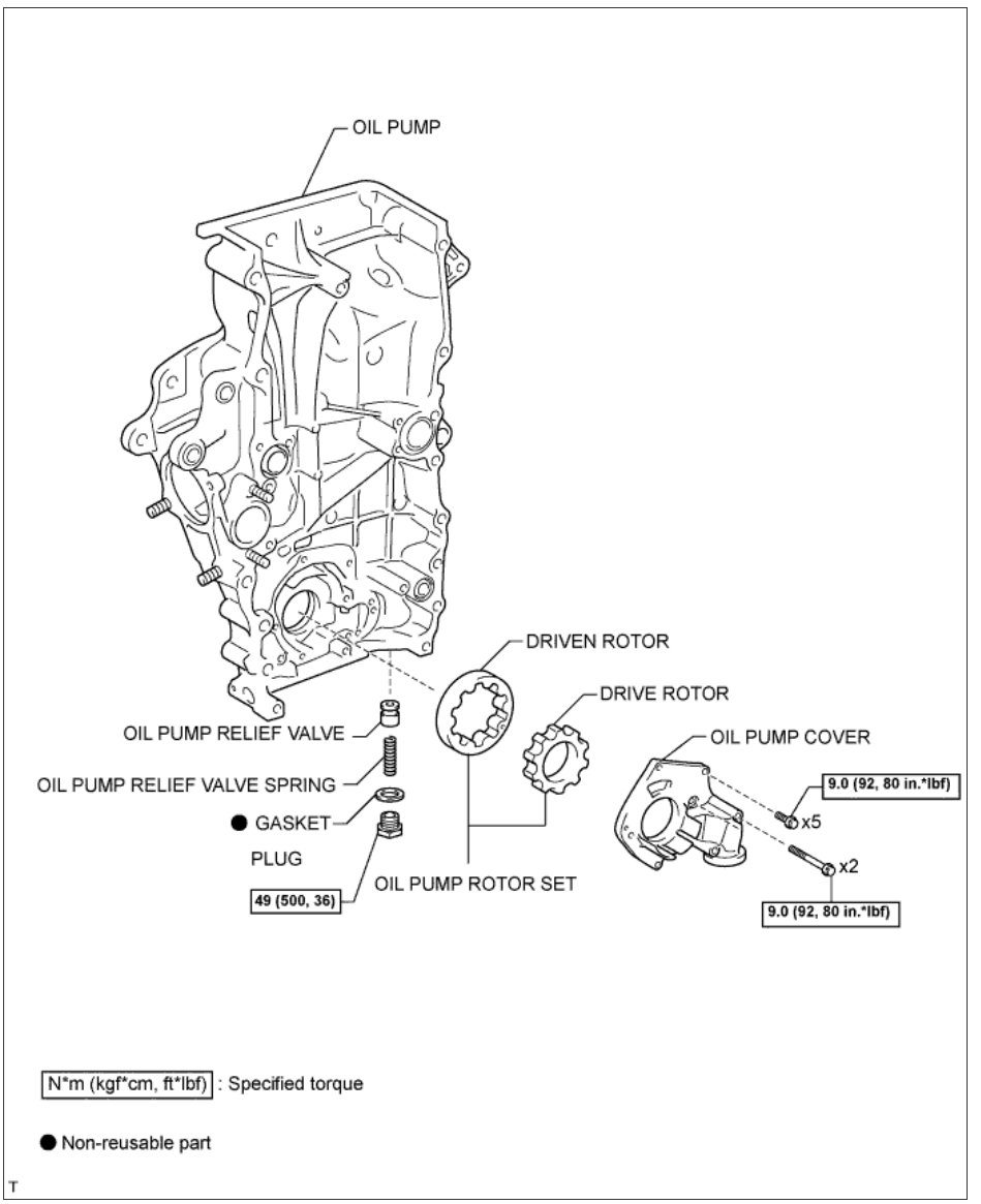

    It's behind the timing cover.
    So it's about the same time and labor as doing a timing chain.
    There is also a relief valve in there too. If the pressure is too high, the relief valve opens and lets oil bypass.
    Might as well replace that too.

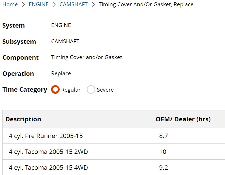

    Wow, Dealer book hours is 10 hrs for a timing cover R&R.
    That's going to be expensive. Unless you have a local shop that that will do it "cheaper".

    The timing chain was done when the head gasket was gone. Does the whole cylinder head have to come off for this? Either way, I think I'm just gonna run the engine until it's time for a new one...

    So, at that hourly rate, I'm looking at probably $1,300-$1,500...
