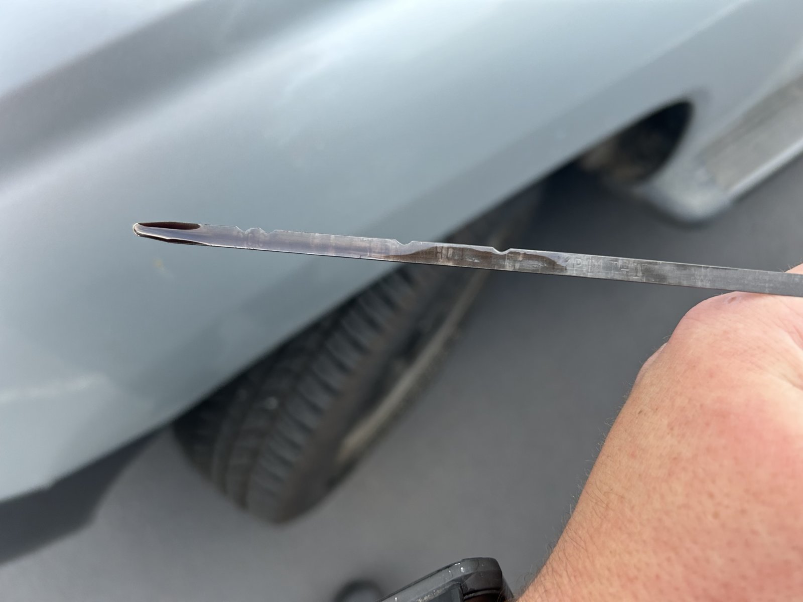

    I just checked the transmission fluid level, and she is definitely gonna need a flush; I can’t remember when I last had it done, but I swear it was in the last 50,000 miles…
    Black97v6MT likes this.

    @TnShooter Transmission fluid looks good in my opinion…

    Charlie, I do Not see a hint of red in that sample!!
    this transmission fluid really Should be drain & filled once a year or ~15k miles
    4qts for the D&F is less than 20$ for genuine Toyota T-IV on the holiday 40% off sale, so it's not a real significant cost output on parts
    a family member of mine has a 2o11 single cab 4wd AT with 96k miles that i am looking after the maintenance and upkeep... since they (Toyota) no longer make new single cabs in 4wd or otherwise, this rig has gotta last a VERY long time... they have had it since it was new like you have had yours
    and i am changing the transmission fluid every 12k to 15k with the Toyota T-IV stuff to keep it clean and red
    this '11 Taco is 4wd so there is enough clearance for me to squirm underneath to access the transmission pan drain plug without having to lift the truck off the ground at all
    you have a 2wd? is there enough clearance for you under there to access the drain plug or would you need to get it on ramps? these dealershops are wanting 200$ these days for a simple drain & fill... not sure what the cost is for a full flush with their special machines?
    have you ever dropped or had the pan dropped and cleaned out?

    I am definitely going to have the transmission fluid changed by my mechanic. The pan has been dropped before and the system completely flushed; I know it has been done since the frame replacement in November 2021, but I don’t remember when. Currently at mechanic’s…

    i find that fluid sample Exceptionally Dark for being completely flushed less than 3yrs and around 50k miles ago with a pan drop!
    how do these taco guys and girls with the fancy sealed transmissions ever get a sample peek?
    i love the checkstick right there in the engine bay! easy to monitor
