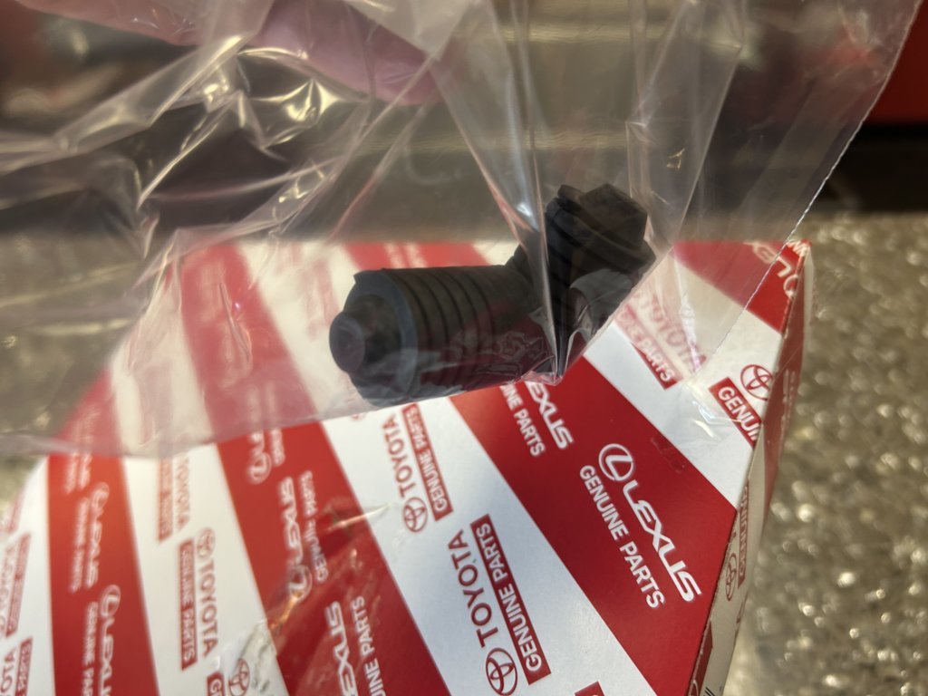

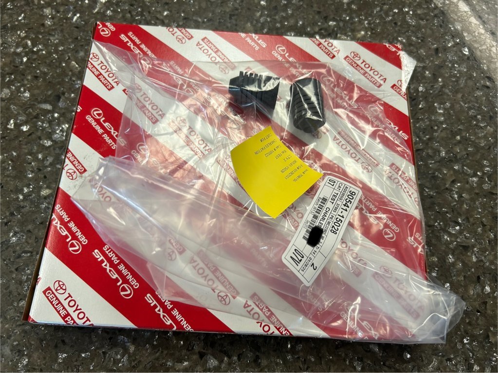

    I picked up the parts at the dealer yesterday…

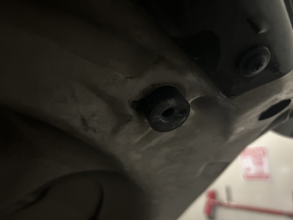

    I replaced the rubber bushings just minutes ago, and they seem to have corrected the problem!

    My hood has fluttered for years. I’ll try the rubber grommets as well. On a windy day I can’t focus on the road because I think my hood will fly off at any moment. Hopefully those grommets do the trick!

    My hood still flutters, but it doesn't vibrate as noisily as it used to. I think the windy and abnormally cold winter (even by PA standards) we've had contributes to the issue...

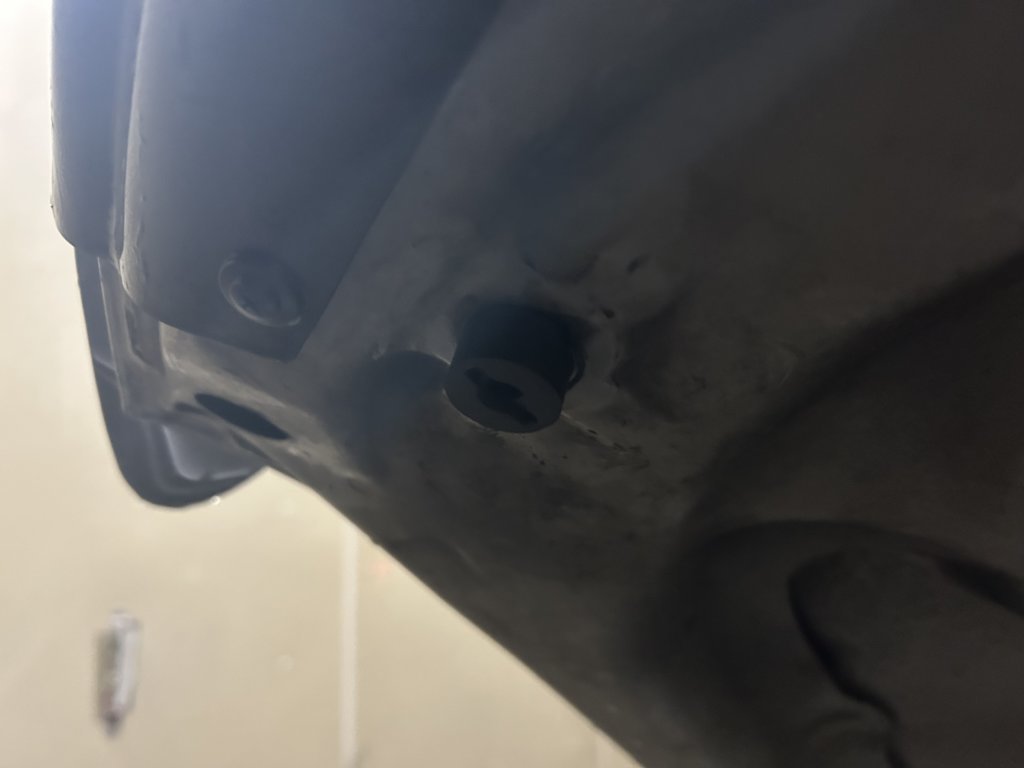

    The hood is not as noisy since I replaced the bumpers, but I am still hearing that metal on metal vibration at highway speeds; I think it’s because the bracing has separated form the hood panel…
