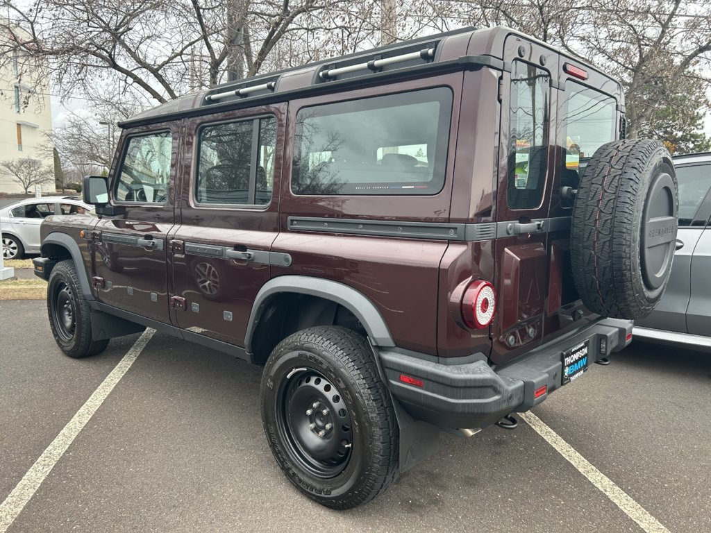

    It is obviously based on an older Land Rover Defender, but it has a BMW engine, and is built by a French company. I learned this from online research, and from talking to a sales rep at the Lehigh Valley Auto show yesterday…

    I saw one of these about 2 weeks ago When I saw it I thought it was a Grenadier but it didn't look the same as what I see on line. It was definitely like this one in your photo which is a Grenadier.

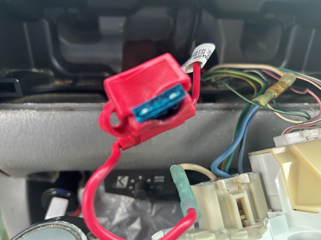

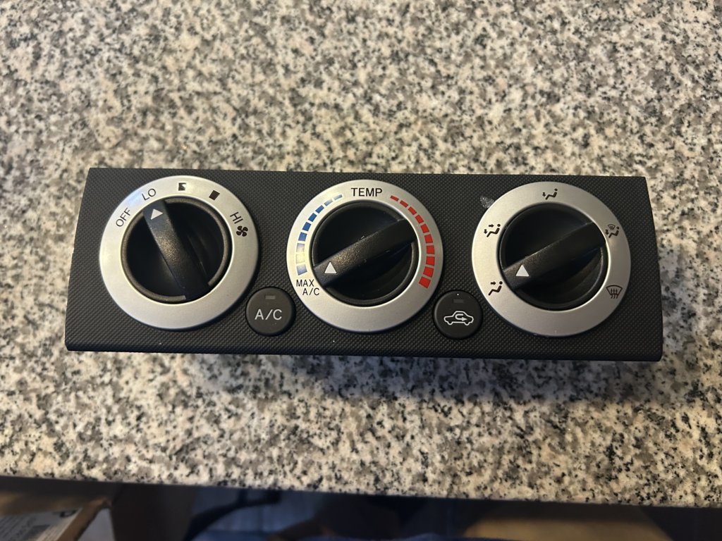

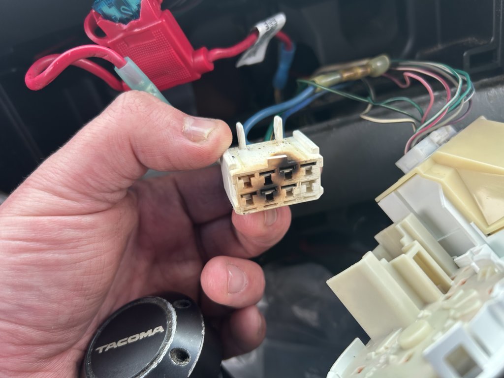

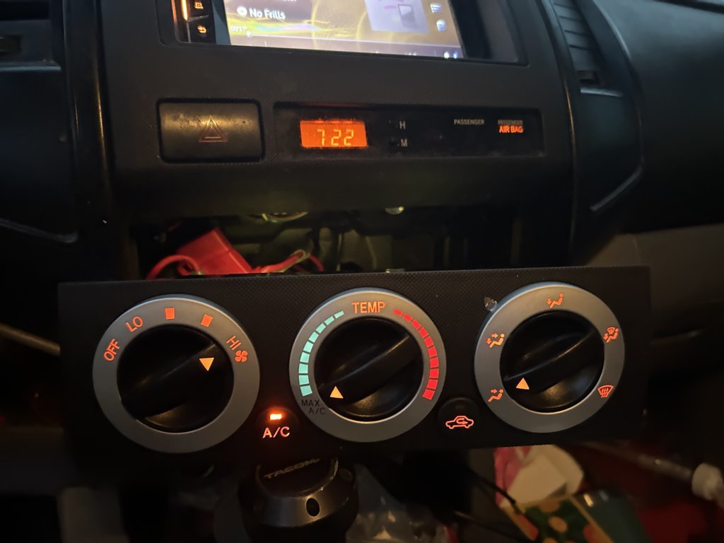

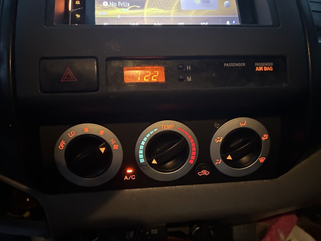

    I finally decided to buy a new HVAC module due to ongoing electrical issues with “used” (out of a totaled truck) units; I paid $720 dollars for the damn thing!

    My mechanic rigged this up earlier this year to keep wires from burning up. The A/C suddenly lost power while we were sitting in traffic, and this is what I found when I popped the module out in the bank parking lot…

    So, this plug was blackened years ago and my mechanic cleaned it up and put this special compound on it, in addition to replacing wiring. The HVAC module was no doubt part of the problem, but this certainly isn’t helping, and it gets replaced next week! The entire HVAC system has been rewired and a number of major electrical parts have been replaced, so I can’t see what else the problem would be!

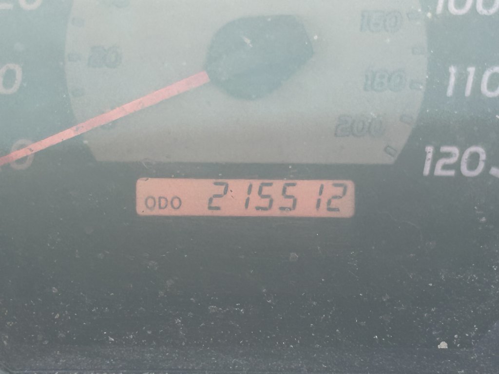

    I hit 216K on Saturday!

    Did you see the pics of my HVAC harness? What do you make of that?

    Good question, not really sure as I've not had anything such with mine.

    Replace both connectors. Loose connections =heat, that's definitely shows signs of heat. Max load also = heat but a good tight clean connection will minimize it.
