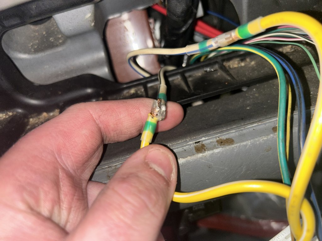

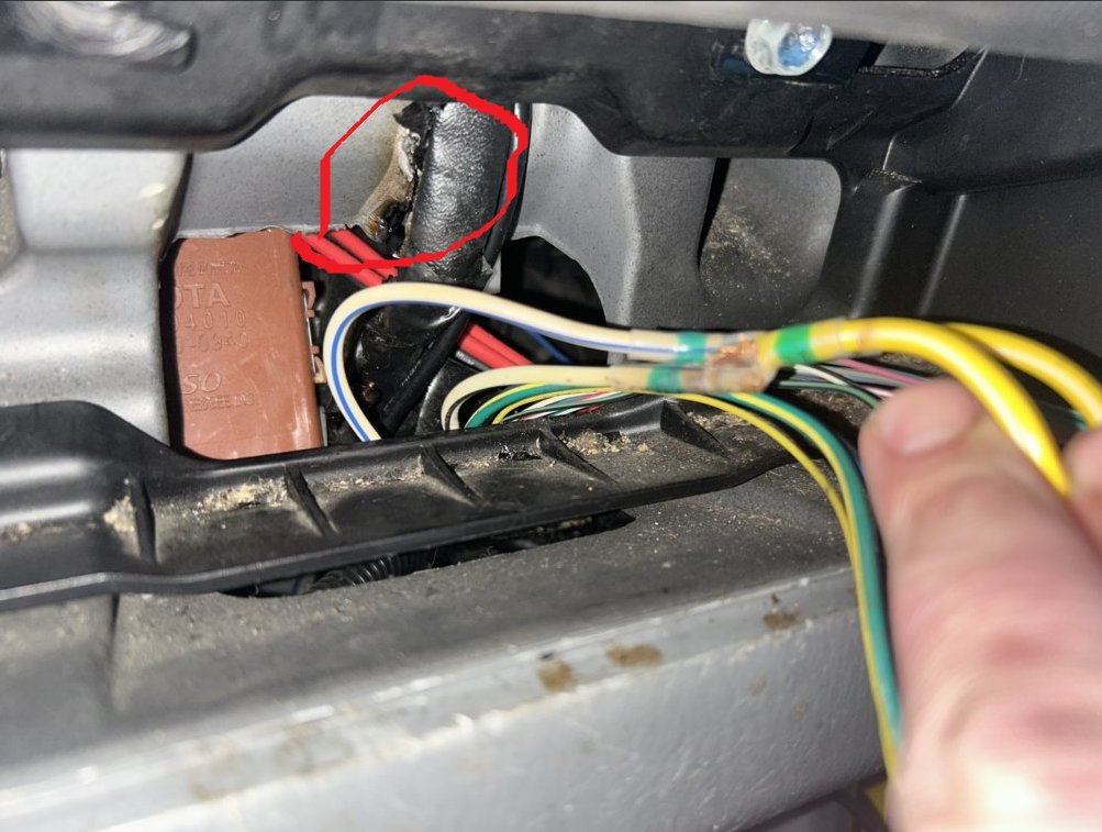

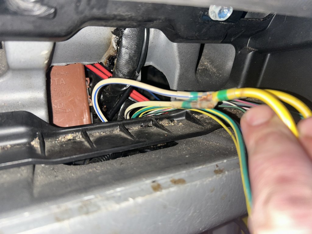

    I pulled the HVAC module out when I got home and this is what I found…

    Nowhere near as bad as what happened before, and I was able to piece it back together with electrical tape until I get it into the shop on Monday. Luckily, it will be warm enough to go without the heat on Sunday…

    I don't see any pics of the control head but from the pics I do see like I said it looks like the splice failed from a cold solder joint which is common with those solder seal butt connectors, the solder just globs over the wire instead of wicking into it causing a poor connection.
    Not sure what went on here though because those wires in your pics don't look that toast.

    That's because they're brand new. The wires weren't even hot like the old ones used to get; I agree that the butt connector likely got too hot and simply melted. I have it rednecked back together with electrical tape for the weekend, I will only run it on lower fan speeds, and it's going to my mechanic on Monday or Tuesday...
