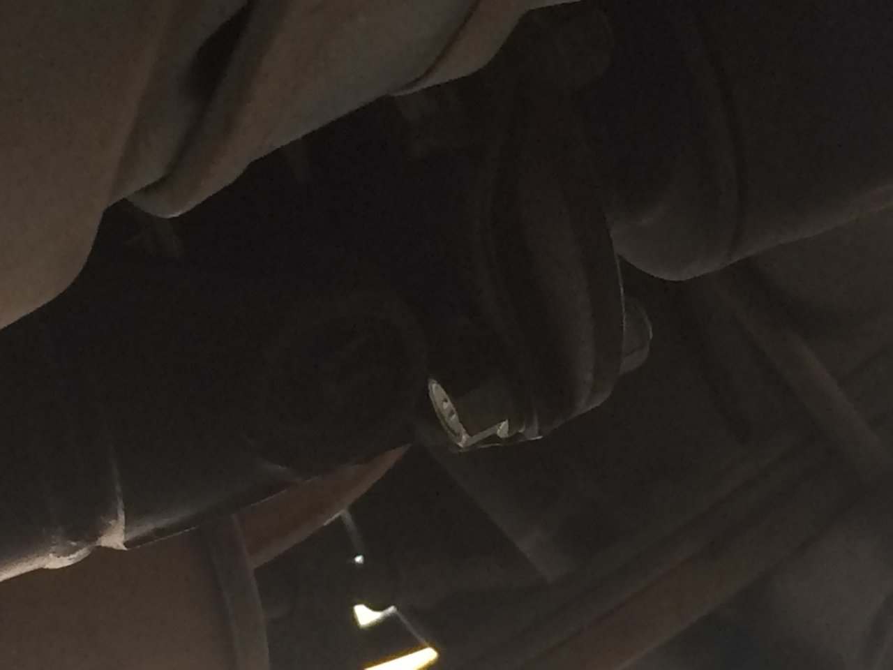

    We've got a huge rain/snowstorm with hurricane-force winds coming in tomorrow, so I think I'll wait until after the nasty weather to address anything.
    What really sucks is that I know how to do all this shit myself but I don't have a lift and I really don't feel comfortable getting underneath the truck when it's supported by a floor jack.

    So I do or do not have one of these?

    you don't need to get under it. i just jacked mine up and smacked the leaf with a rubber mallet. can't remember if i took the tire off

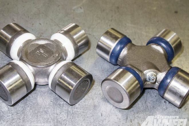

    you can go look at your ujoints. but from the factory, base trucks came with ungreaseable ujoints

    that could be a u joint. take a look at your ujoints and look at the area that is blue or white in these ujoints (your will be black) and see if they are in good shape.

    pulling the drive shaft is super easy. in your case, 4 bolts. if you can find a shop to press in the joint you should be able to get them changed for substantially less

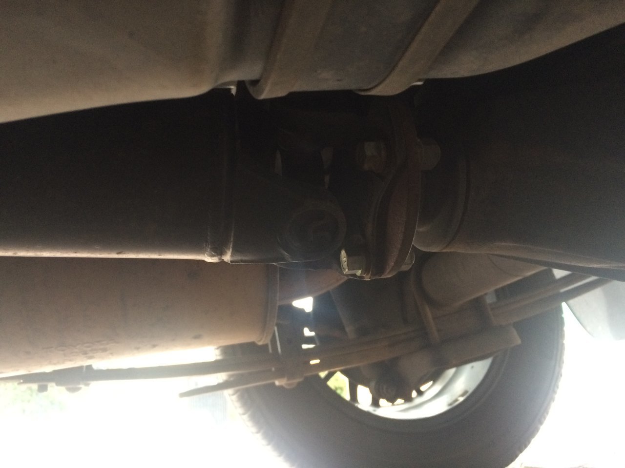

    I'm thinking of something different then...
    What's the thing that connects my driveshaft to the rear diff?
    Also, where are the U-joints actually located?

    Most likely the issue .Not a fix but a troubleshooting technic is to use liquid tire wet and spray liberally to the leafspring . If that works then pressure wash the leaf pack and apply fluid film or 3m cavity wax and it should stay gone for a decent amount of time . Repeat as needed.

    tool for u joint remover is under 60 buck at harbor freight
    I just youtubed for a tutorial and did mine a few years ago
