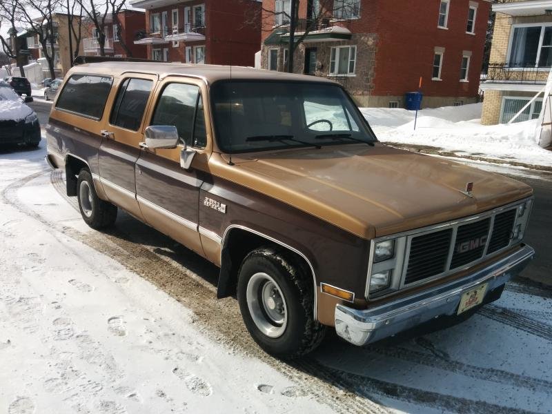

    Off the web, I’ve always liked these, reminds me of growing up.

    Was that photographed in the Borough?!?!

    I don’t think so, there’s another shot online of the back. Can’t make out the tag, and it may even be a temporary, but it doesn’t seem familiar.
