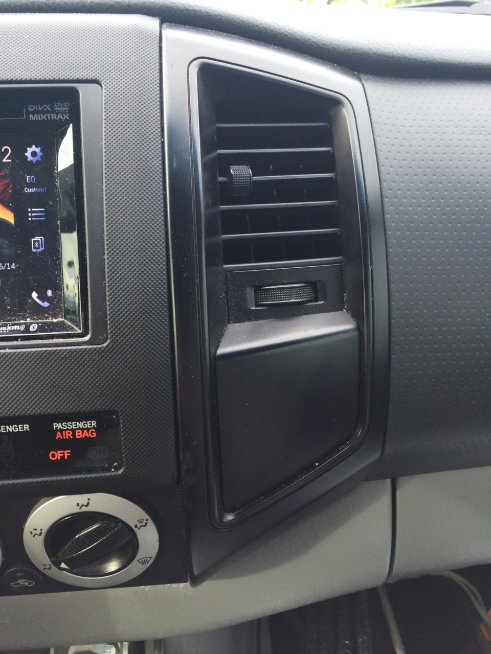

    What's really weird here is that my Taco's A/C had never failed entirely. I discovered the problem in June 2017 when I held my hand in front of the far right vent and discovered that it was just blowing humid outside air.
    My mechanic pressure-tested the system, found no leaks, and topped it off R134a. It worked fine for the rest of the summer.
    I really used the A/C for the first time this season during a drive out to New Jersey with my girlfriend, on April 14th, 2018. We discovered that the A/C was blowing warm out of the far right vent again.
    I took it to my mechanic, and while he again could find no leaks during a pressure/vacuum test, he put dye in the system this time when charged it. The A/C worked fine until maybe last week, and during this heat wave, I realized it was slowly but surely starting to get warm on the right side again. I made an appointment to bring the truck in this Monday, but this is starting to get annoying.
    The A/C blows freezing on the driver's side at all times, though it's colder when I'm moving and/or the recirc is on.

    This vent blows anywhere from cool to pretty cold...

    It's the far right vent that I've had the most problems with...

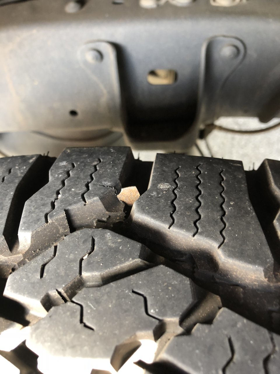

    July 6th, 2018:
    Doylestown, Pennsylvania
  20. Jul 6, 2018 at 7:20 PM
    PennSilverTaco
    PennSilverTaco [OP] Encyclopedia of useless information...
    Jul 15, 2014
    #134007
    72,798
    Charlie
    Central Bucks, Pennsylvania
    2010 Zombie Truck 2002 PT Cruiser
    What the hell is it? A jagged piece of metal...?
