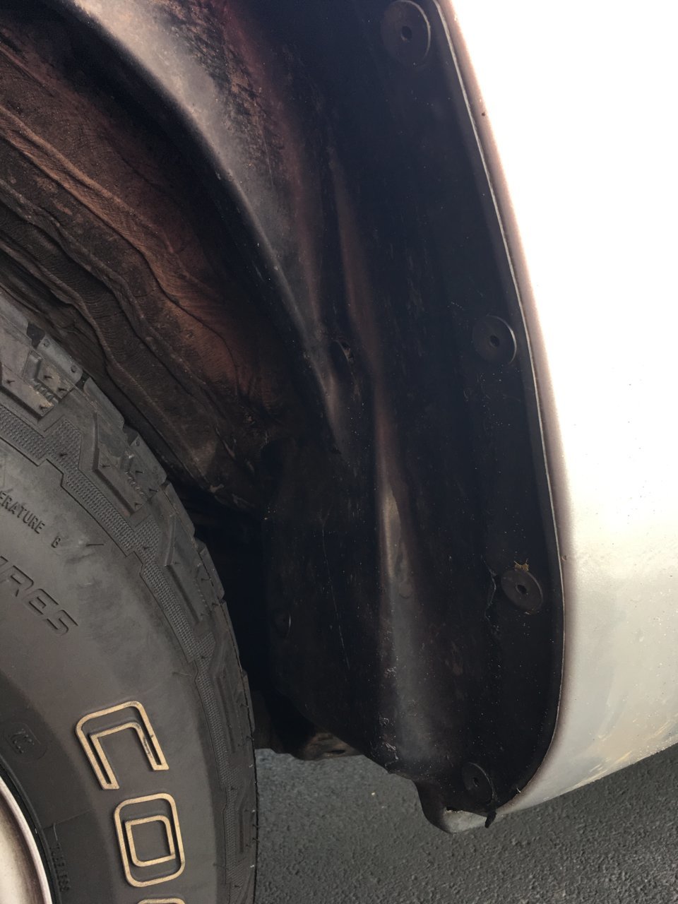

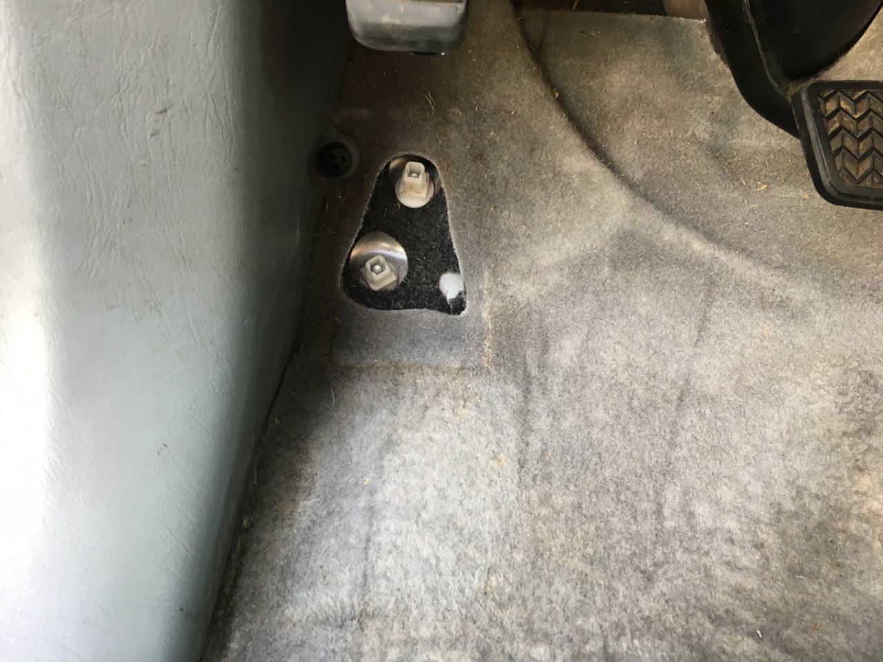

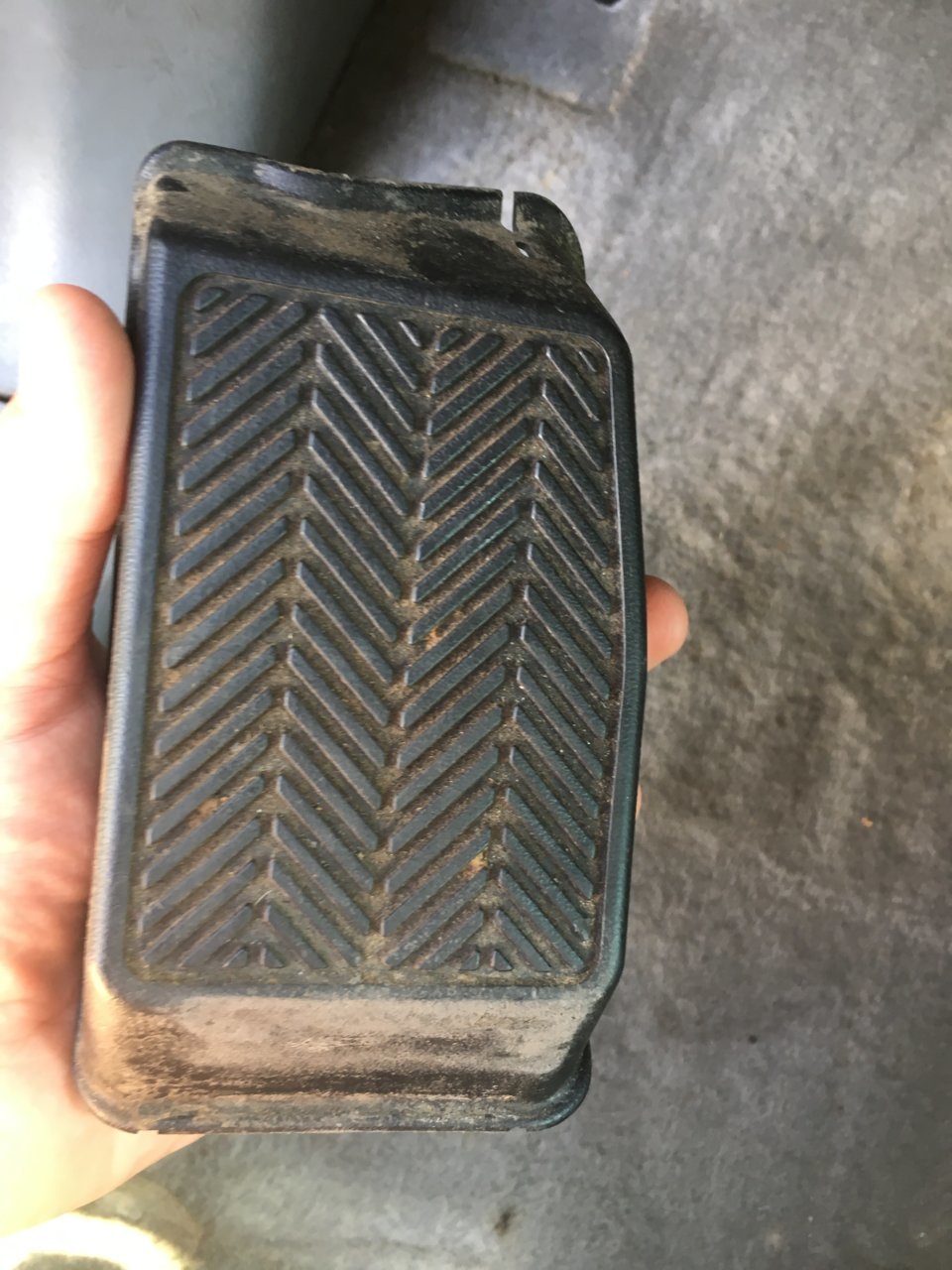

    The footrest thing underneath the parking brake on automatic models...
    This has only manifested itself in the last couple of days, and not only can I hear it, but I can feel it when I have my foot there as well.
    At first I thought it was something outside the cab and I tore open the left fender well with no result.
    This noise comes and goes, and is not constant.
    Does anybody know how to remove the footrest?

    Just grab it and pull.
    To put it back, unscrew the white plastic blocks off the threaded studs, snap them into the footrest, and then push the footrest back over the studs.

    There’s nothing there...
    What could be causing this?!?!

    I actually pulled all of this off yesterday...

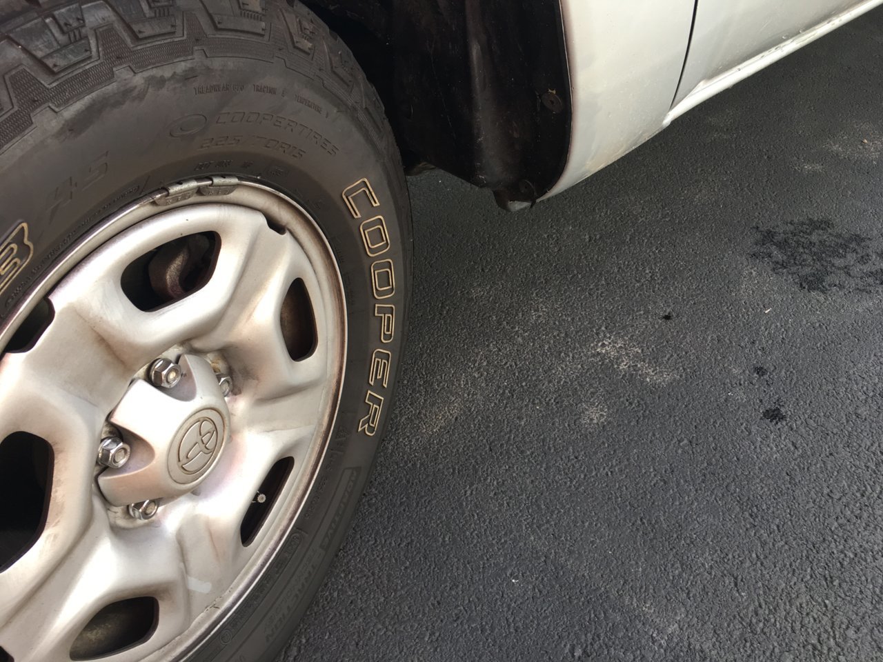

    I would doubt something is physically hitting the underside of the floorboard. I would more likely think its some sort of vibration. Whenever I get a bunch of mud in my DF tire that throws off the balance, I feel it quite clearly in the footrest.
    Hard to tell from those pictures, but it doesnt look like you've lost any wights on the outside. What about the inside of the tire?

    Yeah, sometimes they will add wheel weights to the inside of the tire as well as the outside to get a good balance

    As far as I know the wheels have been untouched since the manufacture date of 9/2009.
    I replaced the factory 15” wheels and Dunlop tires with 16” wheels and BFGs in October 2013, at about 31,000 miles. After destroying two BFGs within a week of each other on the same pothole, I went through two sets of tires at a rapid rate (Toyos and Michelins). Meanwhile, the factory 15-inchers sat in two different garages (and the storage space under the back deck) for more than five years.
    I decided to go back to stock in March 2019 and put Cooper Discoverer AT/3s on the factory wheels.

    your inner fender lining might be loose and the wind from driving at speed may be causing it to flap against the truck

    I looked into that. Doesn’t seem to be any looser than usual. This has not been an ongoing thing. It started like a few days ago!

    Is that a hub centric rim? Pull the center cap and make sure it's centered. Correct tapered lugs? Can't tell. You could have a stuck caliper piston. I had one that acted exactly like that. Is the brake getting hot? Check it with an IR gun. Should be no more than 150F after a normal drive.

    It might be worth sticking your head under the truck just to check. You would see a dirty / rusty spot on the edge of the rim where a wheel weight would have been - if one actually feel off. Or you could just take it in and have them balance the tires
