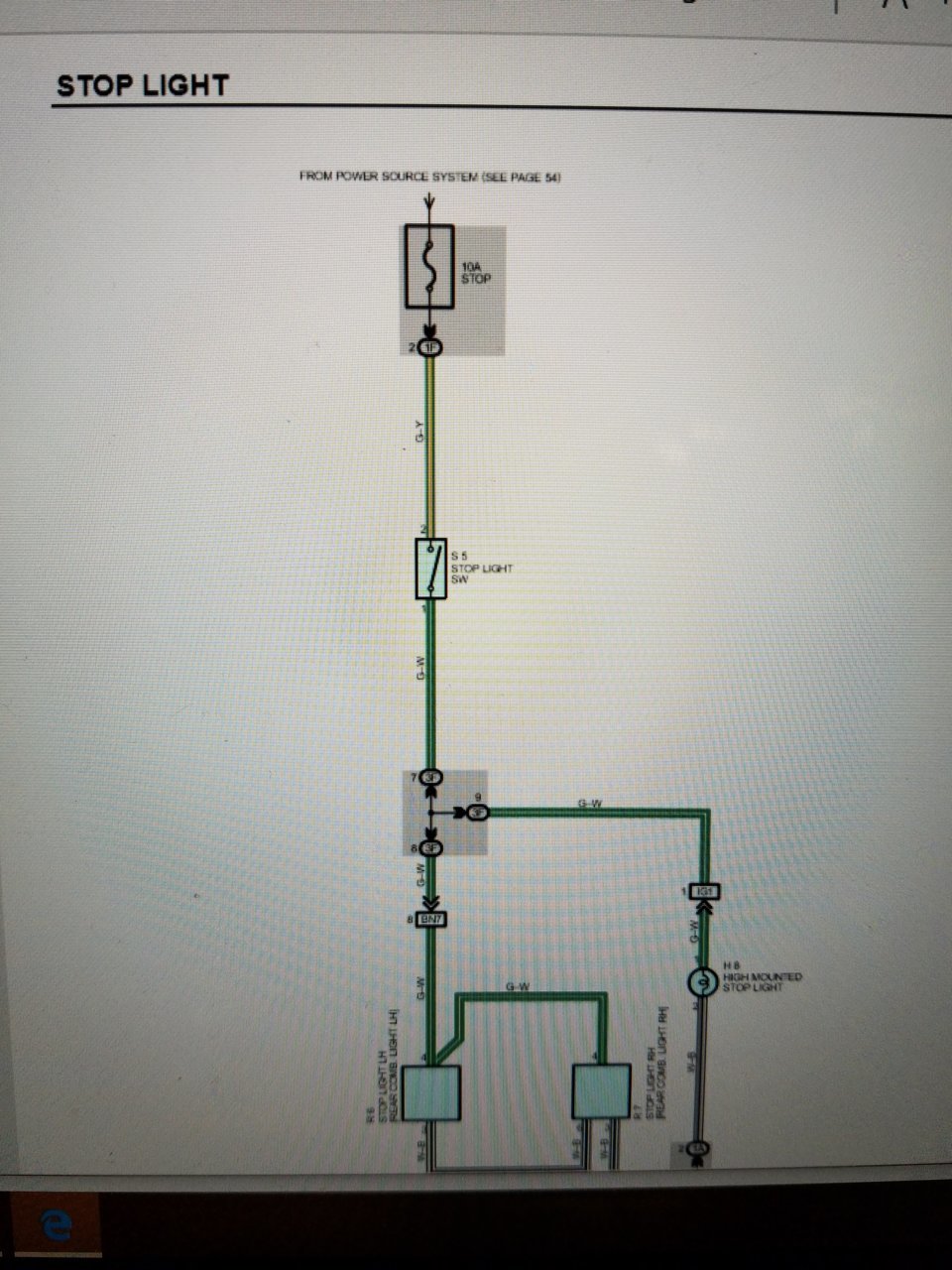

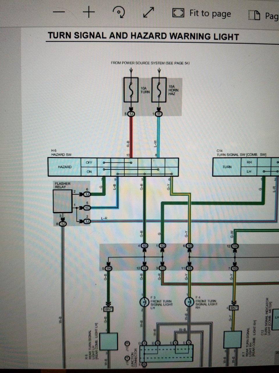

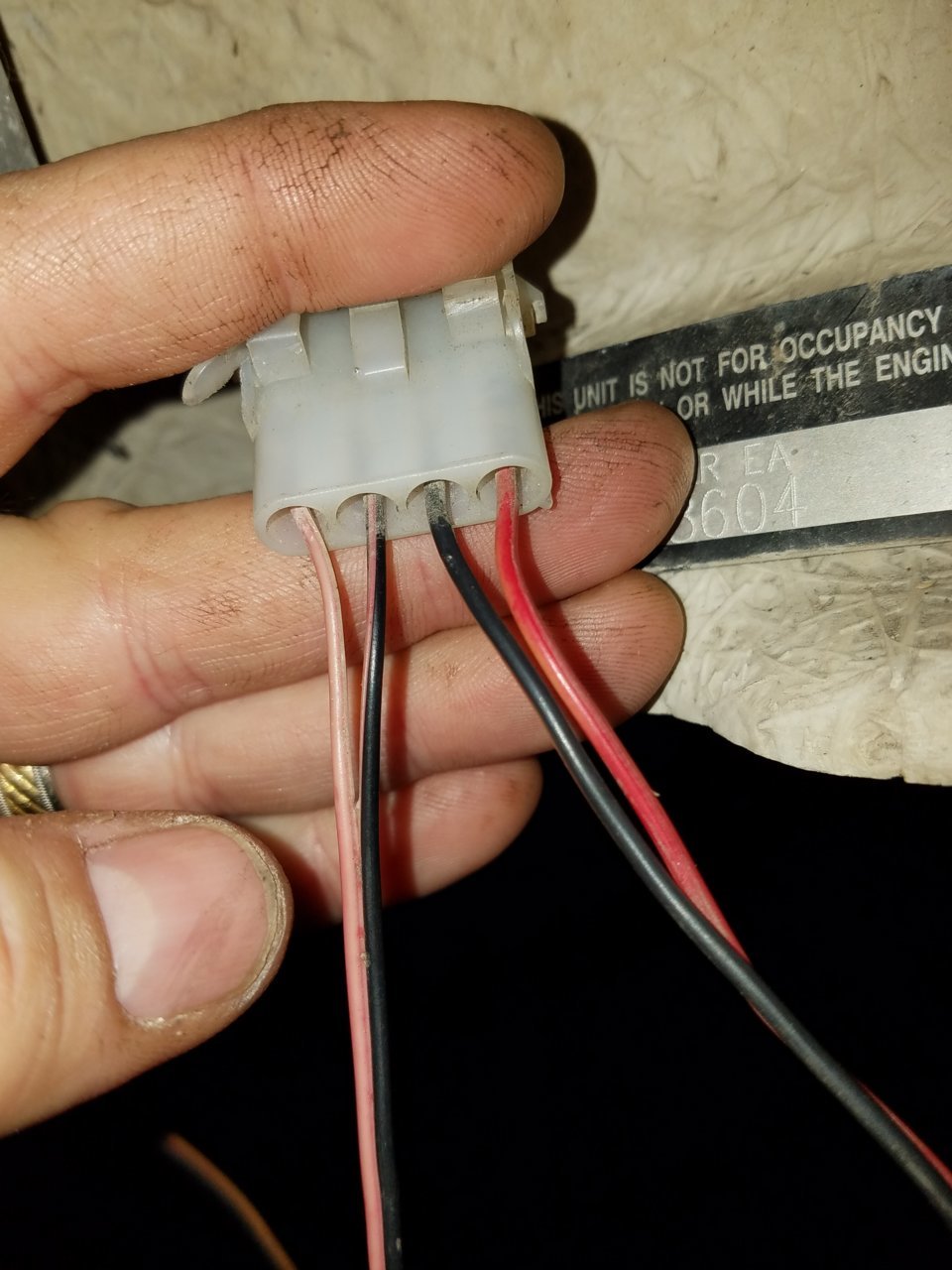

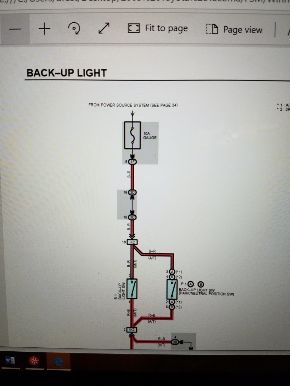

    Follow my logic here if you could please give me advice? Got some pics to show you as I try to figure out wiring my truck cap. I pulled out the FSM and am scouring the diagrams for what goes to the tail light to decipher the color coding. I don't have a volt meter and only want to pinch/splice once.
    That's the first gen wiring harness to the driver side taillight.
    My guess is as follows. Going upper left position clockwise around it. BW is ground. Double solid green as flashers/hazard, double green w/ black as left turn, double green w/ white is brakelight, Double Black/red is backup, Single green is running light?
    Here are the FSM diagrams that led me to think about those colors
    And lastly here is my cap harness. The left two go to the 3rd brake light and the right two go to the interior light of the cap.
    So if In correct... would I splice the he Black/White wire to the black 3rd brake, the Green/white to the red 3rd brake, the Black/White to the interior light Black, and run a line to the battery for the red interior light wire?

    Failure #1 to get the wiring of my 3rd brake light on the cap!
    Now I have to track down if my 3rd brake light itself is bad (maybe my wiring is correct, ya know?) and then I have to doublecheck if my assumption on which wire to splice was wrong.

    Yeah... that's the problem I was describing last night. No multi-meter. Some time ago my dumb cat chewed the heck out of the wires to essentially make it unfixable and I haven't bought another since.
