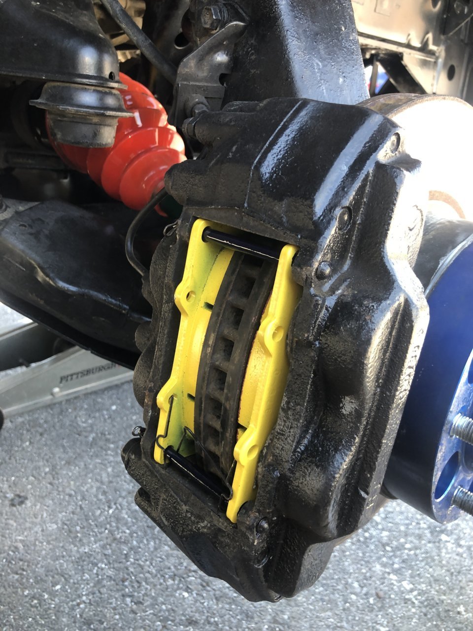

    New EBC Yellow Stuff pads installed. I got 30k miles out of my last set of Power Stop pads so I really can't complain. Especially with all the highway driving I was doing back then.

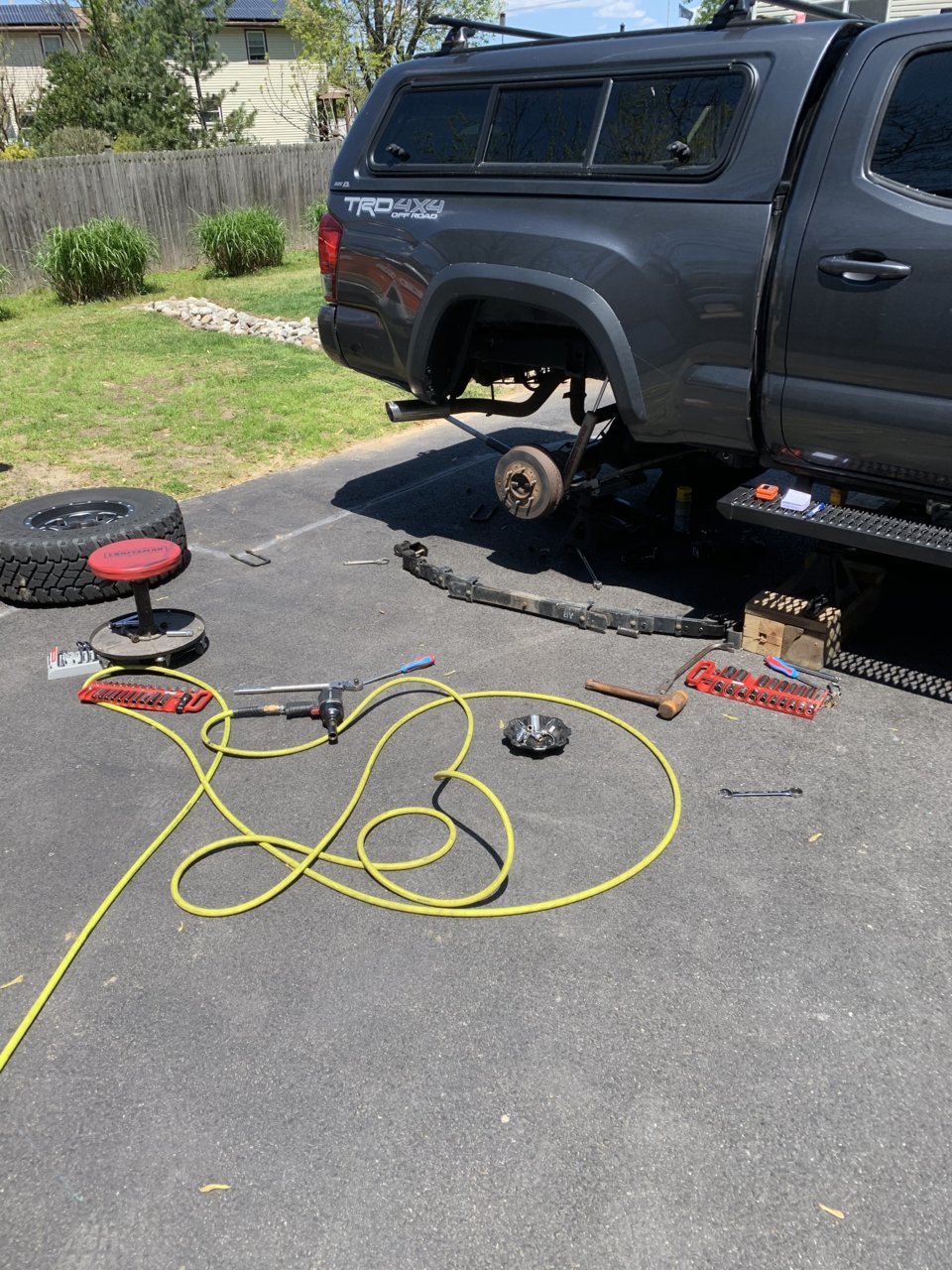

    Anti-seize: on the pivot part of your bolts for the shackle and leaf pack (3 per side).
    LockTite: Everything except the lug nuts.

    I'd only anti-seize the bolt that goes through the bushings, try not to get it on the threads though. Nothing you should be working on will have been loctite'd from factory.
    Best way I found to get the bushings into my leafs was to simply throw the bolt through them with a washer on each end and run the nut on with an impact. Pulls them right in with no fuss.

    I was able to get the bushings in by hand and a large set of channel locks

    They went in super tight to my Dakars.

    I called Deaver to confirm some things and they told me to lubricate the bushings very well, so that might have helped

    I can’t find the torque specs for the bolts that go through the bushings anywhere. Do you have any info on that? I know the ubolts are 52 ft-lbs

    86. Are your u-bolts bigger than factory? The Dakar spec is 89.

    I didn’t think about that. Factory is 19mm (3/4) but these are 7/8.

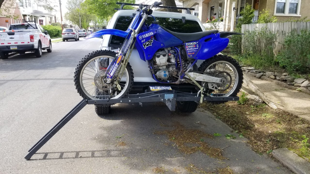

    Hey all!
    Any welders out there @Arcticelf or others?
    Having the ass end of my truck much higher in the air kinda renders the the little ramp that came with my hitch carrier useless...it's a little steep of an incline!
    Weld an extension on or build a longer one? What do you think?

    Yeah I think I have mine at 90.

    We can do something about that

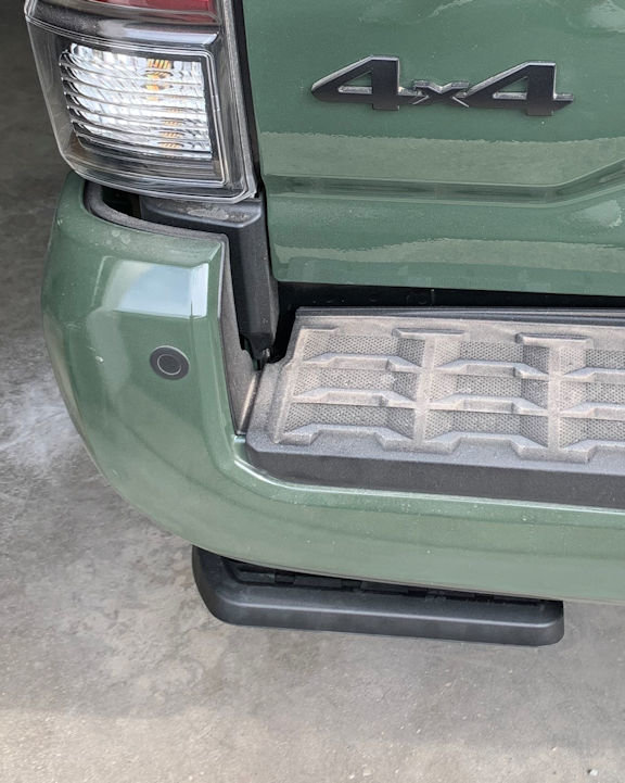

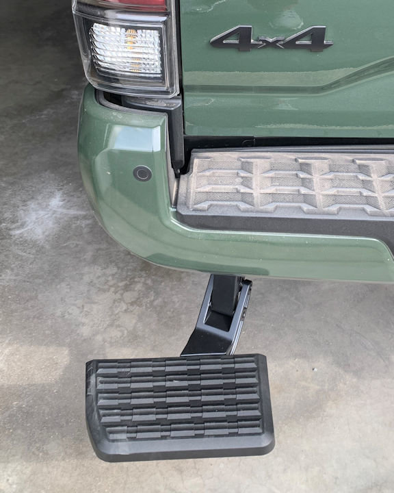

    Since the weather was so nice...and they are predicting 3-5" of snow early Saturday...I decided to put the bed step on this afternoon. I remembered seeing somewhere that someone recommended a 6" extension for the ratchet...and you need it. With it, though, it's a 20 minute job...and I didn't even need jack stands!!
