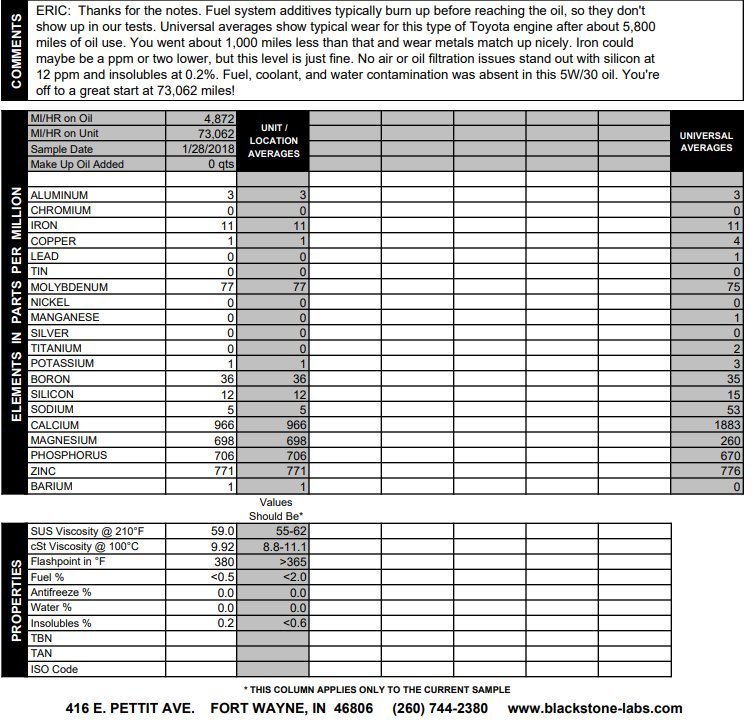

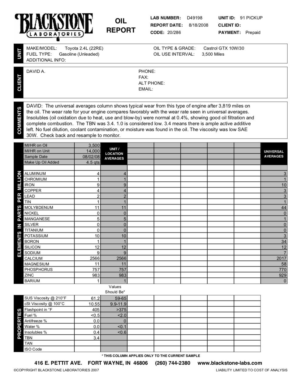

    @blefferd, an example Blackstone.
    BTW, I agree about Mobil1. It is good oil. But so are Pennzoil, Castrol, Valvoline, etc. I figure trying to say which one is "best" is really splitting hairs, especially when discussing synthetics. Run a few tests to see how the oil wears out, pick an interval that has enough margin, use good filters and you'll be fine. Back when we were lucky if an engine lasted 100K this stuff was more important.

    I wonder if they get the wear metal averages from Toyota or just there own historical data. I always figured the aluminum on these things would be pretty high but 4ppm seems low for having an aluminum block!
    We go off more trend analysis for each individual component being sampled, so samples are taken at regular intervals and the current and historical data is tracked by the lab and performing the sample analysis, the records follow the component. We rely heavily on hours since last sample, and if any new oil was added to make an accurate recommendation to them. The squadron tracks this info also and makes the final call on weather the component or engine needs changed, we only make recommendations to them. Some guys are shady and will sample new oil, which we will promptly pick up in the lab or have to ask if they did an oil change recently lol.
    We get our wear metal data from the manufacture, our pubs will tell you the likely cause of a high to abnormal wear metal or an abnormal trend.

    I am going to let you guys in on a little secret when it comes to oil analysis and trending wear metals when you change the oil you rebase line the trend every time, so unless you sample the same oil every 1000k or what ever number or miles or hours on your engine you are more than likely are not going to see a jump in any wear metals or your physical properties.
    I can tell you every time a squadron changes the oil in a gear box because the wear metals drop, metal in the oil does not disappear unless you drain it and replace it with new oil. Or add new oil to replace oil that has leaked out or burnt off.
    If a squadron wants to rebase a component they know is going to get an abnormal code from the lab they will change the oil and the trend starts over. Wear metals increase over operating time using the same oil.
    So only sending samples of oil you have changed really does nothing to help you other than give the lab historical data for that engine. You notice that “universal averages” change as the months wear on from the above posted thread that means they are using there own data gleaned from samples received by TW members.
    It would be awesome to see someone go 20k on an oil change and sample every 1-2k miles then you will really see how the engine wears and the oil breaks down.

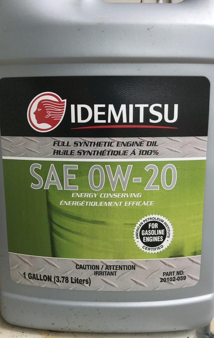

    Running this shit lately. It’s clear as waterAA3E2A52-41DB-4E2F-AFE5-445F554E76DB.jpg

    this stuff I use too, was clearance sale at Advance auto for almost nothing, runs very good in my 2.7l

    Wish I bought a truck load

    Never heard of that before, good to know!

    I got all I could find I my area, what a deal, they just changed the formula over to a DEXOS that's why they clearance out the old formula stuff

    I should have put 5/30 in for the summer and saved the 0/20 for winter but it is what it is. Ya, that is some thin shit!

    5W20??? summertime
