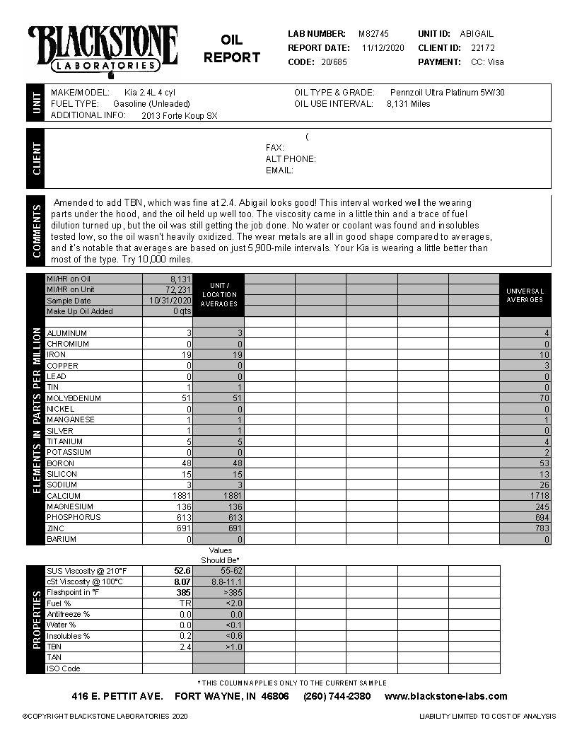

    That is a great report....but oil is still cheap. It seems like you've got a keeper and I would keep that OCI where you have it. But that is just me.

    You're keeping an open mind . . Good! Now if you knew you could safely get to 7 or 8K miles, wouldn't be that be worth the time/money savings? You still have "peace of mind" b/c you can see right before you the engine is not wearing!

    The report was for a Kia...

    The most important part about the oil analysis isnt what they say the oil life is but what they find in the oil, you can see the trends in contaminants and sorta get an idea of how the engine is doing over time and maybe fix a small problem before it becomes a big problem. Start seeing some coolant or higher levels of bearing material, plan for a more indepth look before a piston says hello world. Fuel contamination is high or starting to trend up, faulty injector or running too rich maybe.
