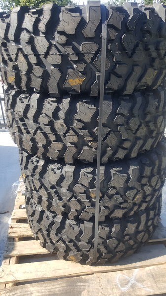

    I will be running 35" with an aggressive thread that is 0.6875" tall for the following reason below.
