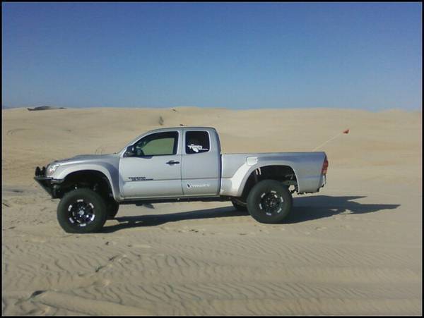

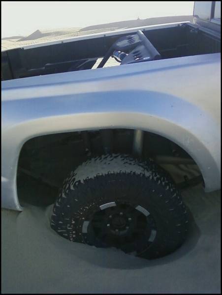

    i just got mine done a couple of weeks ago, I went to huck fest in pismo. It is a night and day diffrence. i just need my drive shaft adjusted :eek:
    heres a pic of me in pismo
    heres a pic of me stuck haha
