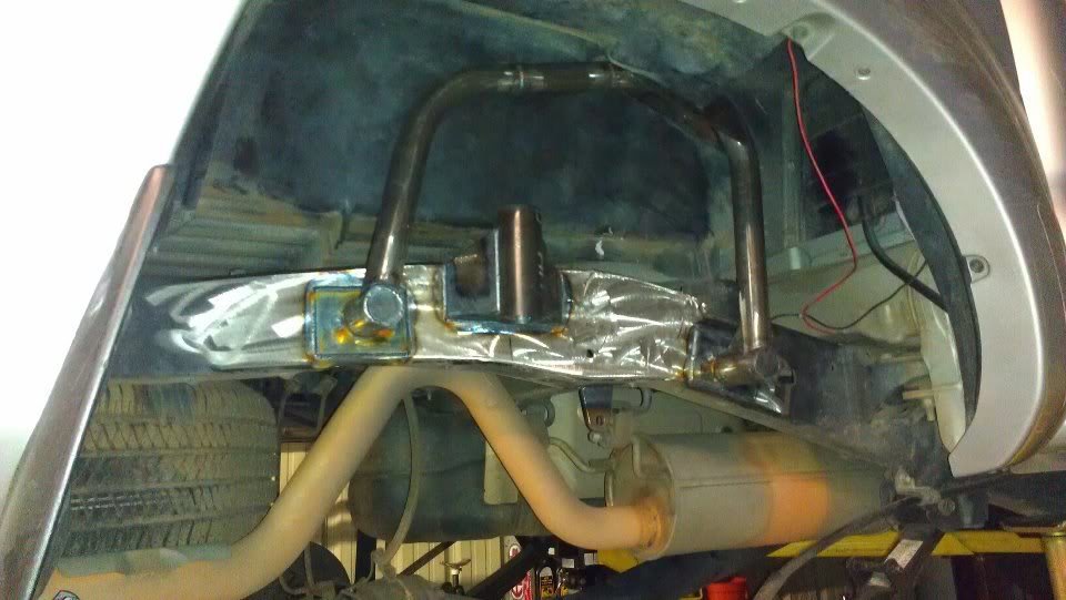

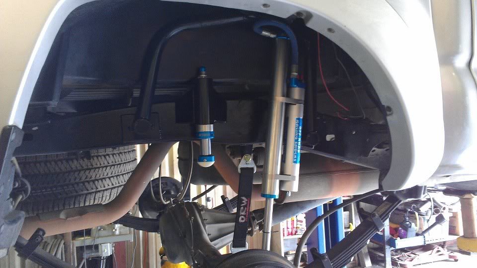

    Ive had the set up for a while now and its been awesome. The increase in bump travel is the greatest gain in noticeable performance. I ran it for a time with stock length fox 2.0's and and LR jounce and then sold the parts off for;
    14 inch King 2.0's with the 7/8 shafts and shorty bumps. kept the shocks and bumps outside the frame rail with a hoop. no deflection in the hoop or any other issues. I've been totally pleased with this set up and now im wishing the front would perform as well as the rear. strapped at 13 1/2 inches.

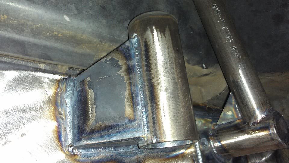

    ^ Nice work Kellen. Like how its all Tig welded.

    Ah I wish I had these skills. Thats all the work of my friend Matt. He owns San Diego Auto Fab... builds drag cars and customs primarily... but pretty much anything else you can bring him.

    This is something that I am interested in. Did you go with 2.0s for clearance from the frame or just personal preference? Who did the work? I need to get an estimate. You havent had any issues with the current set-up right?

    can we get a pic of the bump strike pad??
