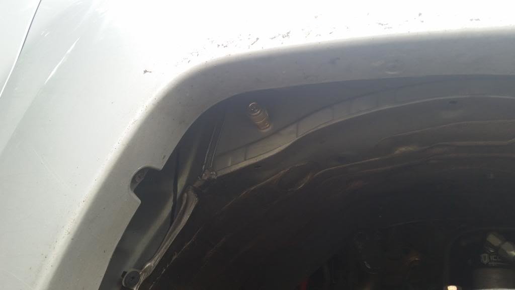

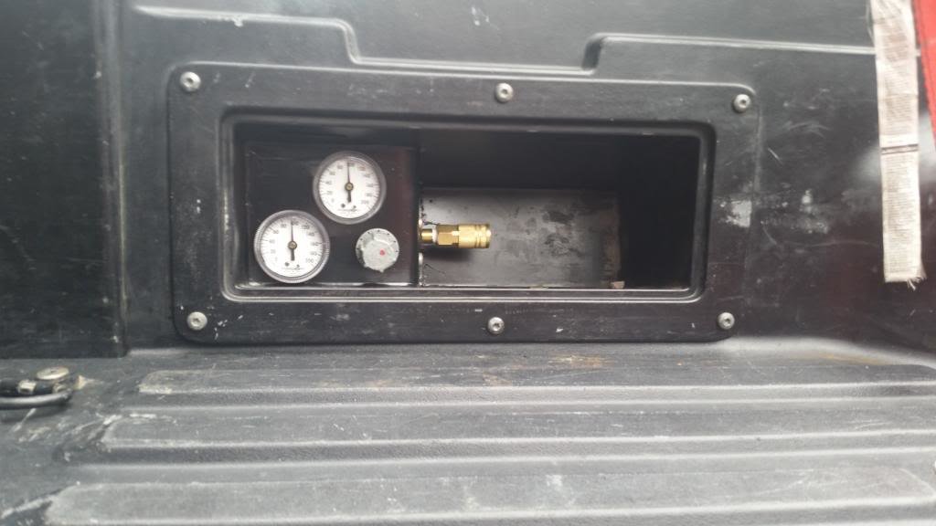

    Just about finished my OBA. I am trying to fine tune the it now. I would fill the 10 gal tank to 100psi in the evening and by morning it would be empty. I have been slowly going through and tightening all my connections. I am now only loosing about 5-10psi in a 24hr period.

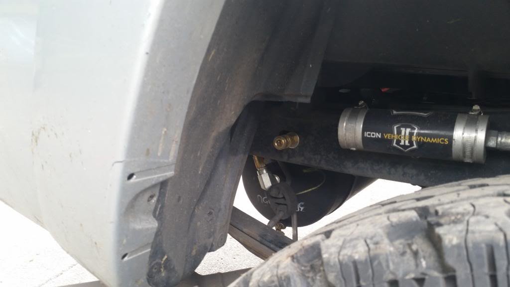

    I am planning on adding a small gauge in the cab so I know how full the tank is but wanted a nonregulated and regulated gauge in the bed for tools. I won't be doing it any time soon but I am doing a bit of research on pneumatic helper springs too. I am thinking I could do a softer leaf pack for off road but have a pneumatic helper spring for off road. I need to look again but I think I am at 11" of travel and these bags are good for 15" and have internal bump stops:
    http://www.truckspring.com/Products/...-358-5429.aspx

    If you haven't already, use plumbers tape or something to that effect on any threaded joints. I used some blue stuff on a job at work recently that is a little thicker than the white stuff, but it goes to seal the threads themselves as well.

    I used the tape on all threaded joints from the beginning. I have a few barbed joints though. I am thinking it is probably those or maybe I didn't tighten all my threaded joints down enough.

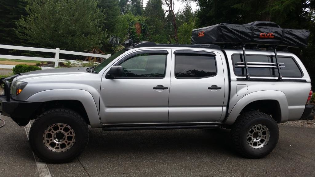

    I picked up a CVT Mt. Rainier this morning:
    yote, Tayoflor and TheBlackTaco like this.

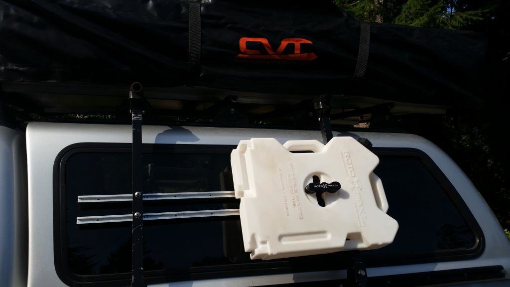

    Finished working on the Rotopax mounts (now I just need to buy more Rotopax) and started looking at how to mount the basket with the RTT. I think I need to move the RTT back more but I didn't want it to over hang in the rear too much.
