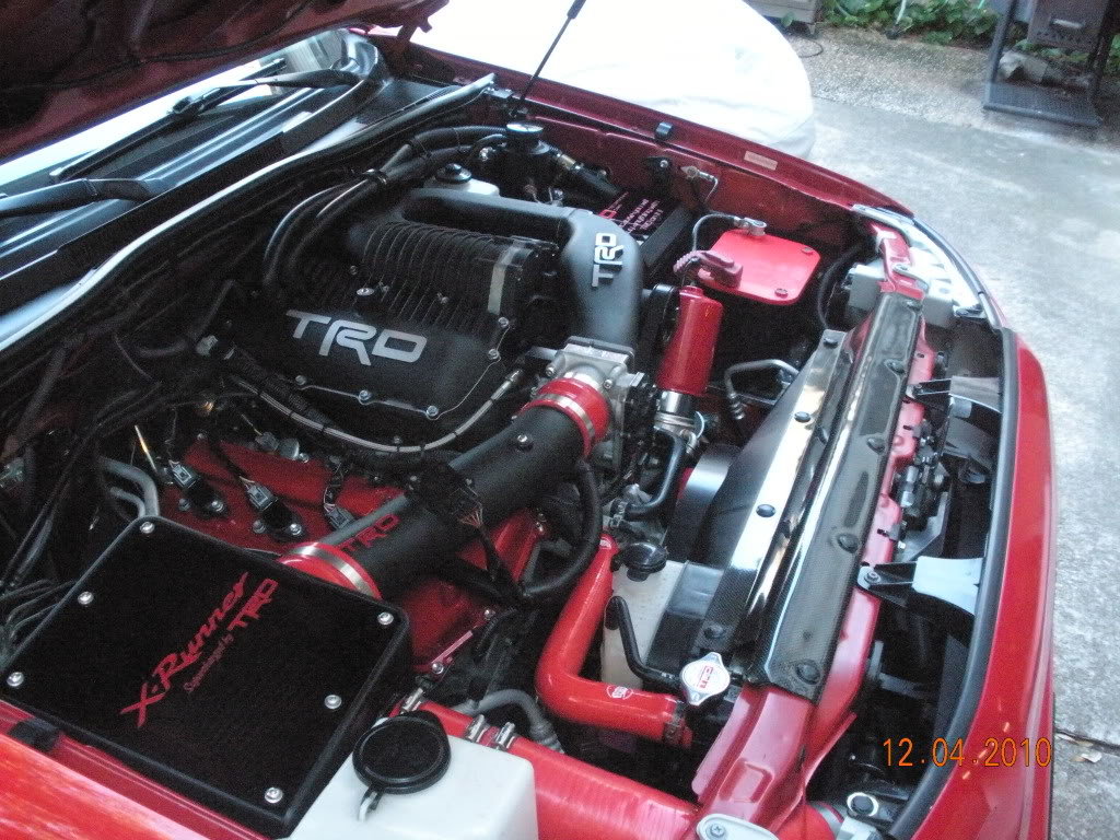

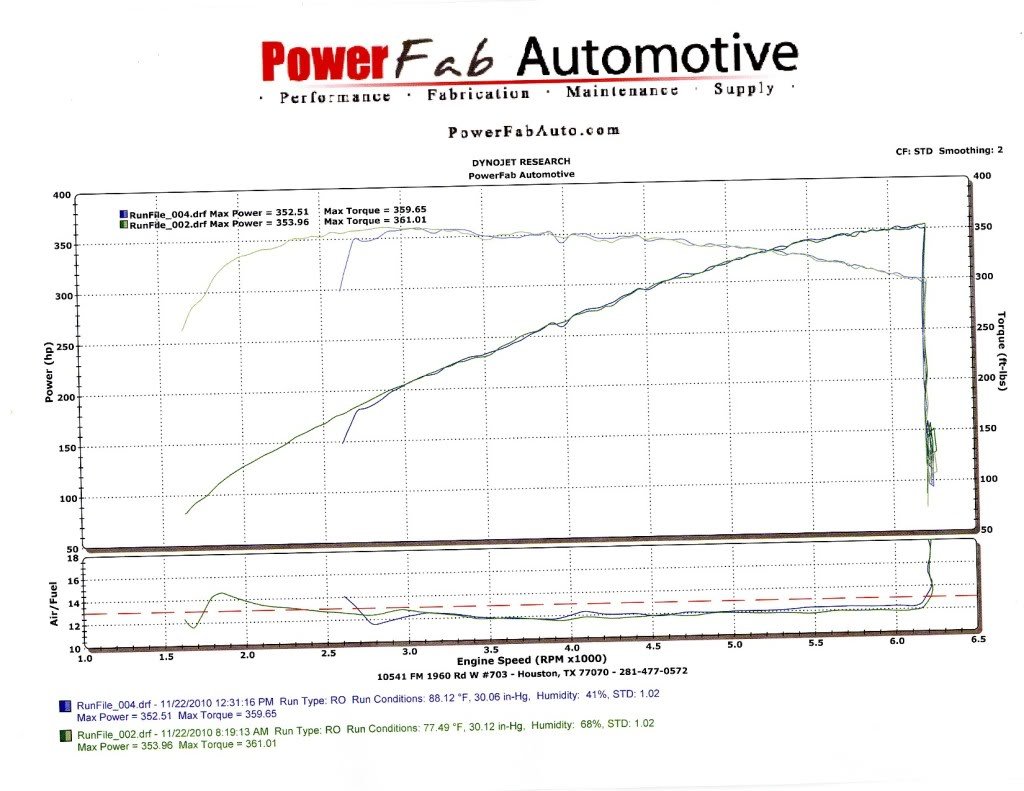

    I have a TRD S/C with a full set of NST pulleys, including S/C pulley. DTLT, APR Y-Pipe, with 3" URD catback. First generation TRD CAI. APR X-1 ecu ( URD U-con also an excellent choice), APR 7th injector. Factory oil cooler.
    This was my last dyno pull.
