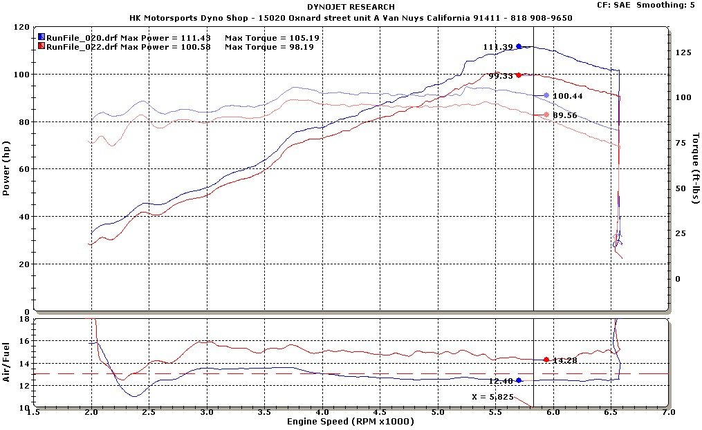

    It might depend on the vehicle... I dyno tested my Toyota Yaris with the stock exhaust and with a MagnaFlow axleback exhaust...
    ...and there was a pretty decent difference...
    Both runs were done with the same intake and with the same Weapon R header...
    Although I don't know for sure if you can extrapolate that kind of improvement to the Tacoma, as so far I've only done dyno runs with the stock exhaust. I have a custom fabricated MagnaFlow exhaust on it now...
    ...and might do a run one day just to see for myself. ;)
    Greg
