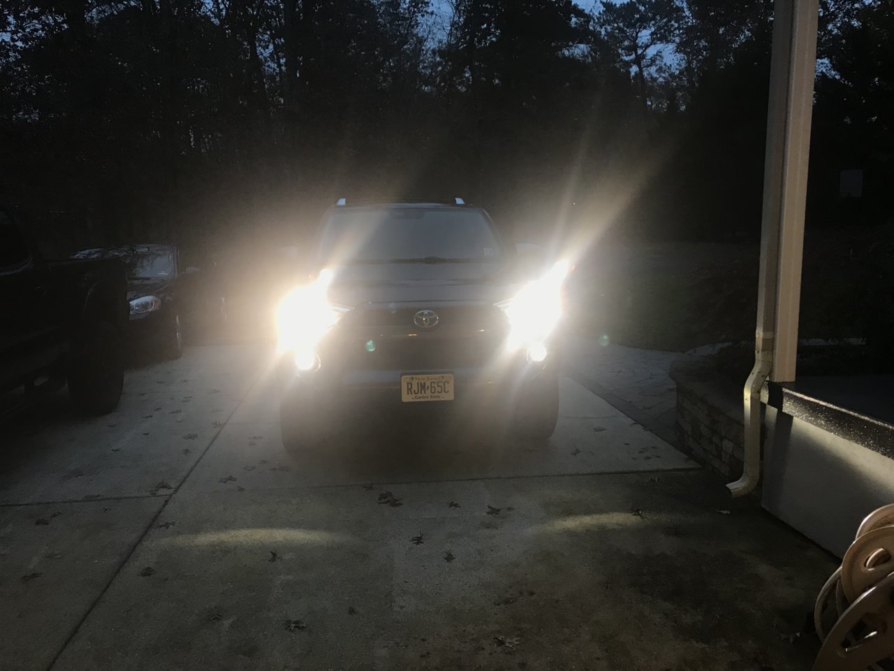

    Here is a great quality HID kit that I have installed in many vehicles and quite a few 4Runners with projectors. You need H11B bulbs And I would recommend 4300 or 5000k.
    Here is my T4R with 4300k bulbs. So much better than the halogen bulbs, good cutoff, nice spread, and decent hotspot area.
    If you want a little whiter do the 5000k. IMO the 5000k look a little better and run around 4700k with the 50w ballasts in this kit.
    I just swapped to the 4300k bulbs because my 5000k’s were 4 years old and I only had the 4300’s on hand.
    https://www.ebay.com/ulk/itm/282591853710
    D73E81C4-D3B4-4C9E-AB12-E166E64E8934.jpg 3C49799F-6C17-489B-9724-5D17CFB2812A.jpg

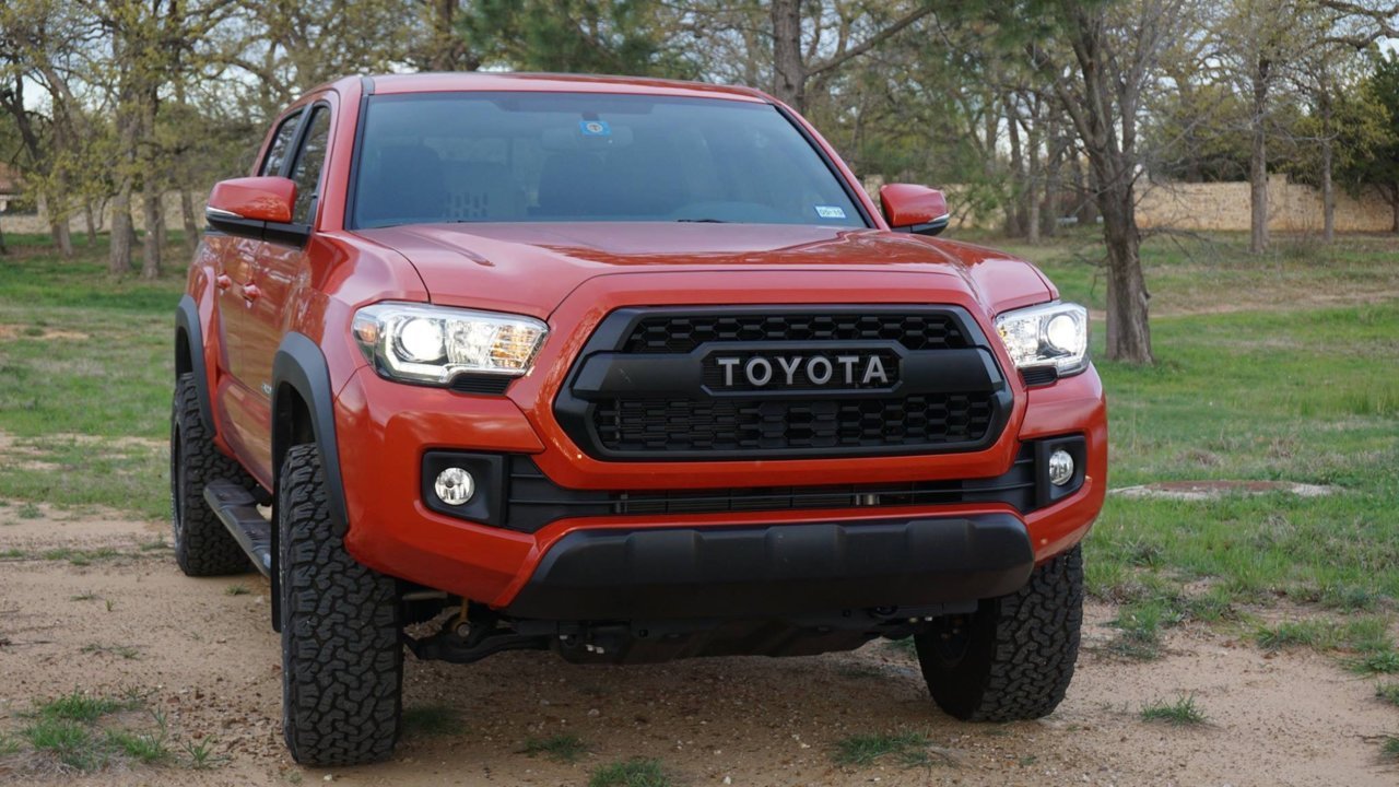

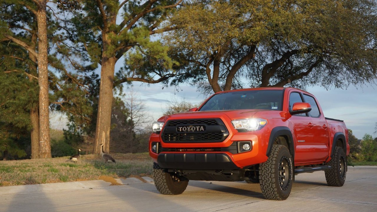

    These are the Morimoto 4500k HIDs.

    That looks good!
    Tacoma2020[QUOTED] likes this.

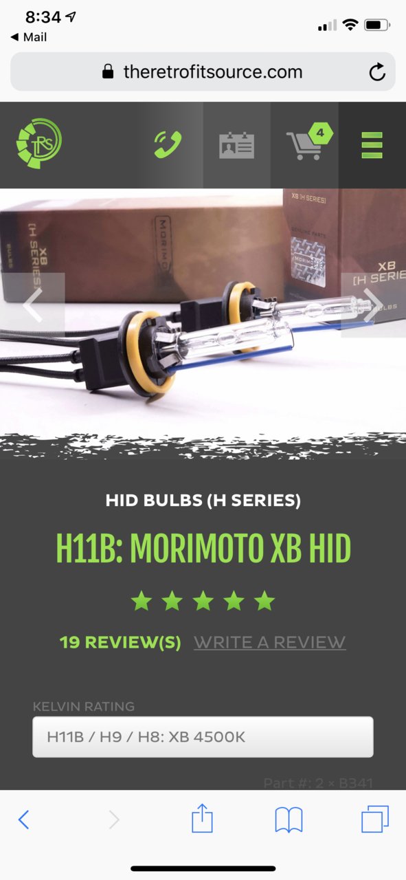

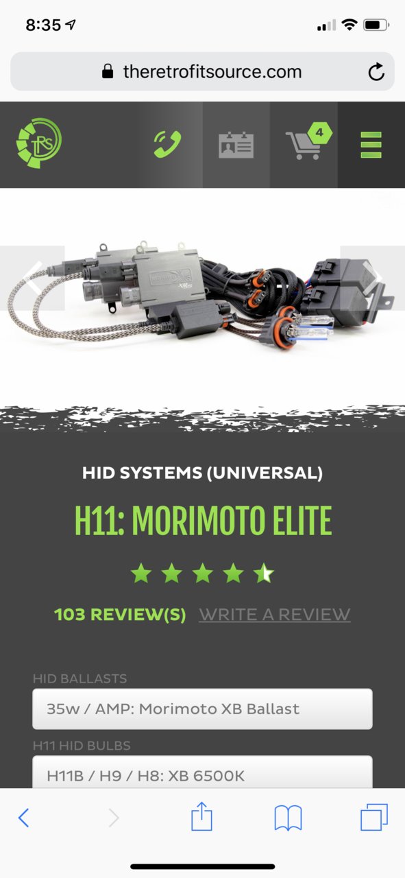

    With Morimoto what’s the difference with these hid bulbs https://www.theretrofitsource.com/h11b-morimoto-xb-hid.html compared to the hid kit bulbs? https://www.theretrofitsource.com/h11-morimoto-elite.html?preselect=51812,54419,47309

    They are both h11b, but if you look closely the one with the yellow rubber ring has a different looking connector vs the red rubber ring.

    Your missing the point. On this one (1st pic)
    the yellow rubber ring has a different looking connector. Vs what comes in the HID kit. (2nd pic).
    Is the 1st one more heavy duty or?

    I didn’t miss the point, watch the video to tell you the difference, it explains your initial question, your welcome.
    IDK about the color of the rubber, I doubt one is heavy duty.

    I understand the concept of h11a vs h11b which is all the video discusses, but that wasn’t my initial question. My question was (if you checked out my links) why the plug in adapters look different on the bulbs.
