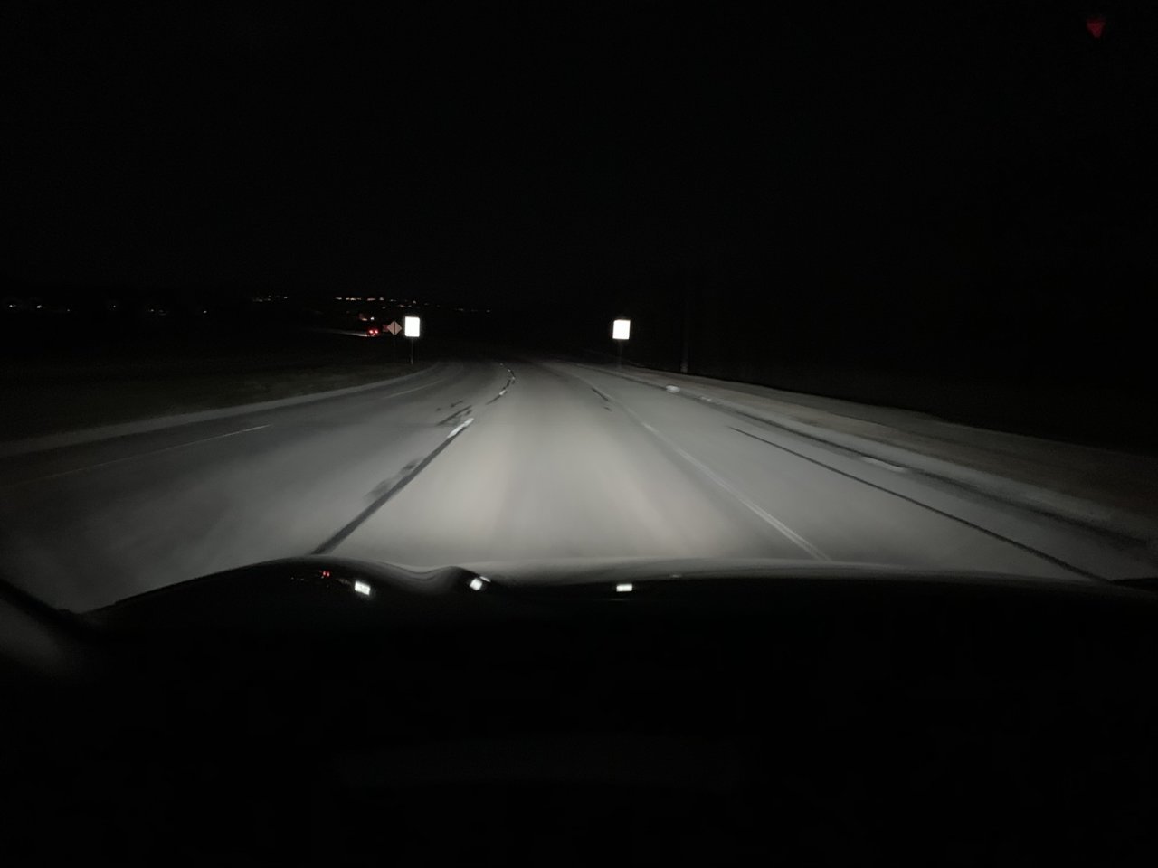

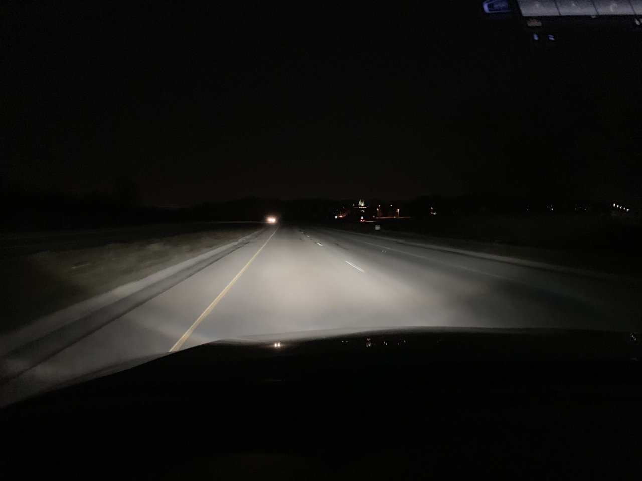

    Since I wanted to support a USA company (no hard feelings Xenon Depot) I ended up going with Morimoto’s XB HID and the latest generation AMP Morimoto XB35 2.0 ballasts and 5500k/6500k bulbs for 2 of our vehicles.
    Here’s my opinion:
    -No shaking
    -Very bright and stable, fog lights not needed now. I kept my stock fog lights and will use them when needed in bad weather.
    -Foreground lighting much better than any led’s I’ve tried.
    -Great quality products
    -Distance lighting is awesome
    -HID is MUCH better for halogen projectors after many countless hours and many led options I’ve tried. This will not only be safer, but possibly save lives. Believe me stay away from led bulbs in projector halogens. It’s simply not worth it.
    Keep in mind these pics are from 2 of our other vehicles.
    @TRSAndrew your Morimoto HID bulbs and ballasts are top notch. Thank you for allowing me to rest easy at night now. :)

    Man those look good, nice output! That's the way to go with projector beams....

    #272494
    22
    Thanks! They look unbelievable on the road. Great color and output! I just can’t believe I didn’t do this earlier. LED’s just cannot complete. Plain and simple. I’ve tried so many of them and still can’t believe I wasted all that time vs just going this route.
