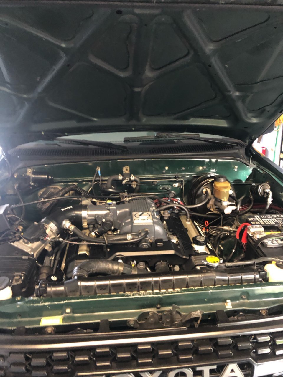

    OLDHMECH61
    OLDHMECH61 Well-Known Member
    Apr 24, 2020
    #325669
    216
    Andy
    Odessa FL
    99 Prerunner Std cab green
    1UZ swap, trutrac diff, tundra brakes, 3 lift, FJ rims
    This will give you 100 more hp than the 3RZ, only weighs 30lbs more, and weighs a lot less than the 3.4 V6, its a lot more work than a super charger, but the price point is close, about the same cost.This swap will make your lifted oversized tire 1st gen feel somewhat nimble and fun to drive, gas milage will be about the same, i just drove from Tampa to West Palm Beach (227 miles) average 75mph air blowing cold got 19mpg with cruise on, it takes alot of control to keep your foot out of it, you can pass other cars at will any time. IMO best power option to replace the 4 cyl.

    #40
    OLDHMECH61
    Apr 24, 2020
    #325669
    216
    Andy
    Odessa FL
    Yeah i really should put something in the build thread, its been done (road worthy) for almost a year now, didnt want to do the actual day to day build post......what if it didn’t work? thought i would put some miles and time on it before posting a build. Here is some info, the 1uzfe is an aluminum v8 developed by Toyota in the late 80s for their Lexus line of sedans (LS400)&(SC400) to compete with BMW and Mercedes, they spent millions in developing it. HP is around 260, with lots of room to grow, it has steel forged crank, H-Beam style rods, hyperutectic pistons and is an FAA approved power plant. There is a lot of information for swaping this engine on utube, Lextreme, Cartunes and Northwest Toys in Oregon, its a fairly common swap, and knowing what i know now, not that difficult.
    More later
