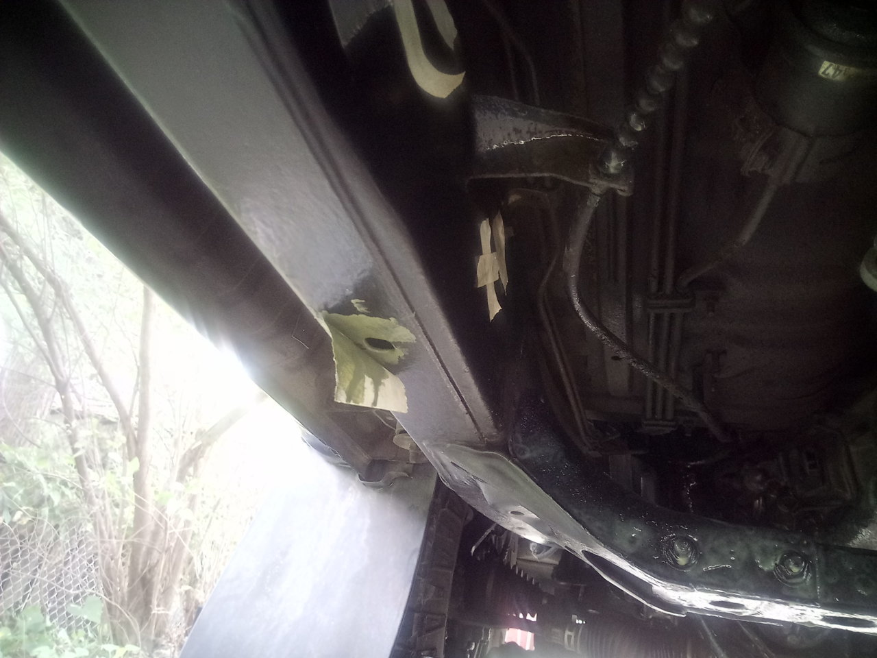

    this green internal frame coating was quite interesting!, it ran down dripping on the new paint outside (easily wiped if immediate) the access holes and dried INSTANTLY on the crusty parts not yet blasted/re-coated deep back behind the muffler on the side
    should've worn a long sleeve shirt because that product burned my arm skin dripping down on me, safety goggles were worn as a precaution
    i need to re-scope it for full coverage achieved (why i used the green product) and then do the black internal spray

    here's a few lengthy short videos of poking around the rear spring perch area on the passenger side
    I used quite a potent magnet stick and a 100 psi air hose to blow out any loosey goosey peeling coating before applying the eastwood green IFC to convert & seal it up
    time taken probably a good 10 hours over several days, in just this one area :(
    there was also quite a bit of black aluminum oxide grit the magnet pulled out from getting in there from the exterior sanding several months ago...
    https://www.youtube.com/watch?v=RWoUvohC6Sg
    https://www.youtube.com/watch?v=Qf_NxZWyT_Q
    https://www.youtube.com/watch?v=P4-BV44fW2Y
    i used the green coating initially to see if any spots were missed, which there seemed to be with the black areas, and will do another black IFC coating on top when the weather gets more conducive for this task but it would seem i mentioned this previously

    black IFC on 10-10-2020 in the far rear passenger side behind perch
    looks like i have some more labor to do on getting this internally coated better with the black
    good thing i did the green FIRST so its much easier to see the spots missed (1:30ish TS) with the borescope because this black spray sure makes it difficult to see well inside its so dark
    i'm not sure if there is a convenient hardcore light small enough to fit inside the frame holes and light it up inside better than the led on the scope does
