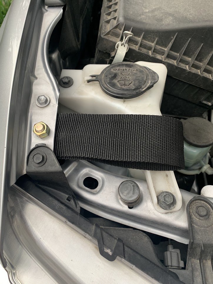

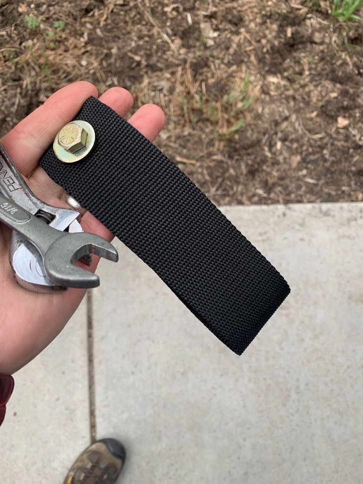

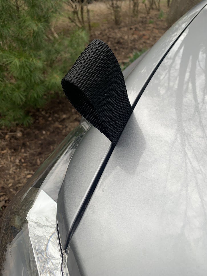

    I'm sure most of you have seen this, but I thought it was kind of slick. Thinking about ways to tie down the front of the canoe / kayak.
    FdrGuQ8PwsJOJI2THcvNVnmQ8QWk9vWwu4mLi8Ab_5739d8a854799174625ce35b9c41eac41cca4b8b.jpg
    0t7u0eyp_uDkd5ab0XfDwl3BSEsR0958j9eCMdsc_aff862ee58f0eebc88ebbb48855bf64aaaac5b26.jpg
    1VBEq2HjC-SlUfG48eseT6XtQkl3fn_CsiPAIdGt_973a204351662642a07fb90d9064076e16dc3b96.jpg
    Voila!

    I was going to do grommets too, but I thought the pressure from the washers was enough. They are plenty strong for the application. I have two loops close to the windshield and two loops by the lights. Holes already there!
    This is the webbing I used. I had a ton of leftover from a chair project.
    https://www.amazon.com/gp/product/B01HHMIVUY?ie=UTF8

    Ditch light brackets work well for the tie down point, too. Plus they don’t rub the paint like webbing can.

    That webbing is going to wear through the paint on the hood in no time. Put some rubber or something between it and the hood

    Can I offer an idea? Get a washer/tab like below and put it on top with the flat side towards the fender. Run the webbing under that washer with the exposed part towards the fender, then run the strap around the sheet metal and bolt it on the bottom. Basically take yours but bolt it on top as well, with a washer/tab with a flat side.
    This doubles up on the mounting and pinches the webbing, helping to prevent the hole from ripping out and prevents the sharp sheet metal from wearing on the webbing. The flat side of the triangle washer then holds the webbing across its whole width spreading the load. Running it towards the fender side also lowers (but does not remove) the pressure against the hood.
