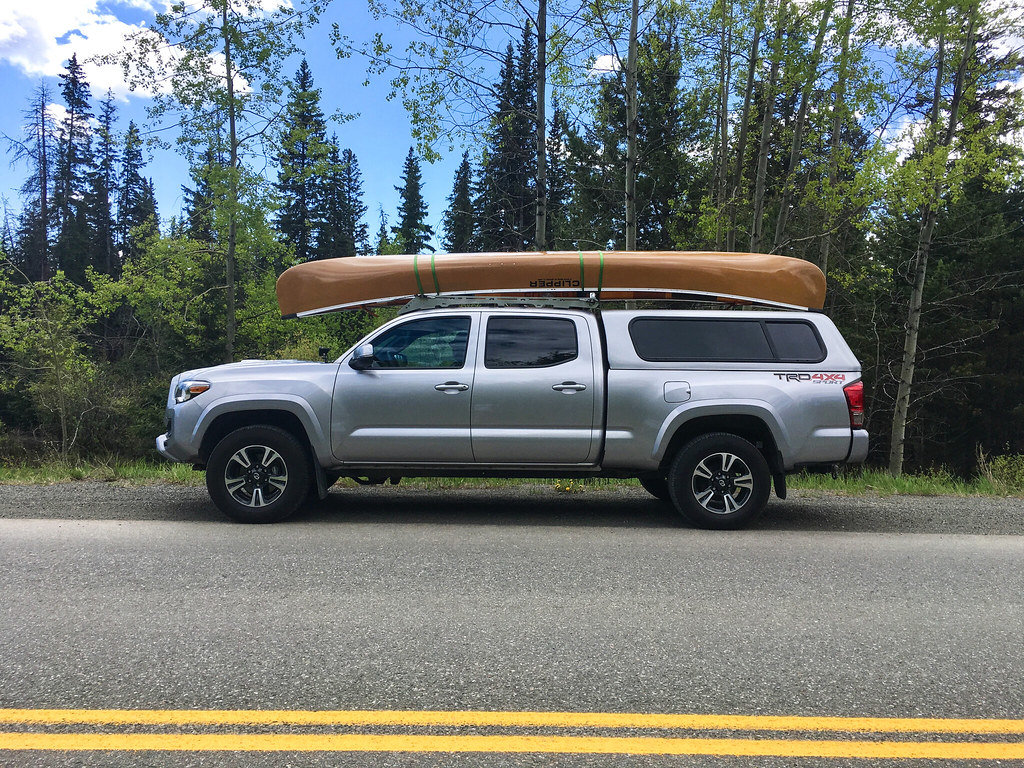

    vicali
    vicali Touch my camera through the fence
    May 20, 2010
    #37503
    2,675
    mike
    Kam,BC
    2017 TRD Sport 1D6
    16 Prospector on the Prinsu;
    -Rorschach- and manderle[OP] like this.

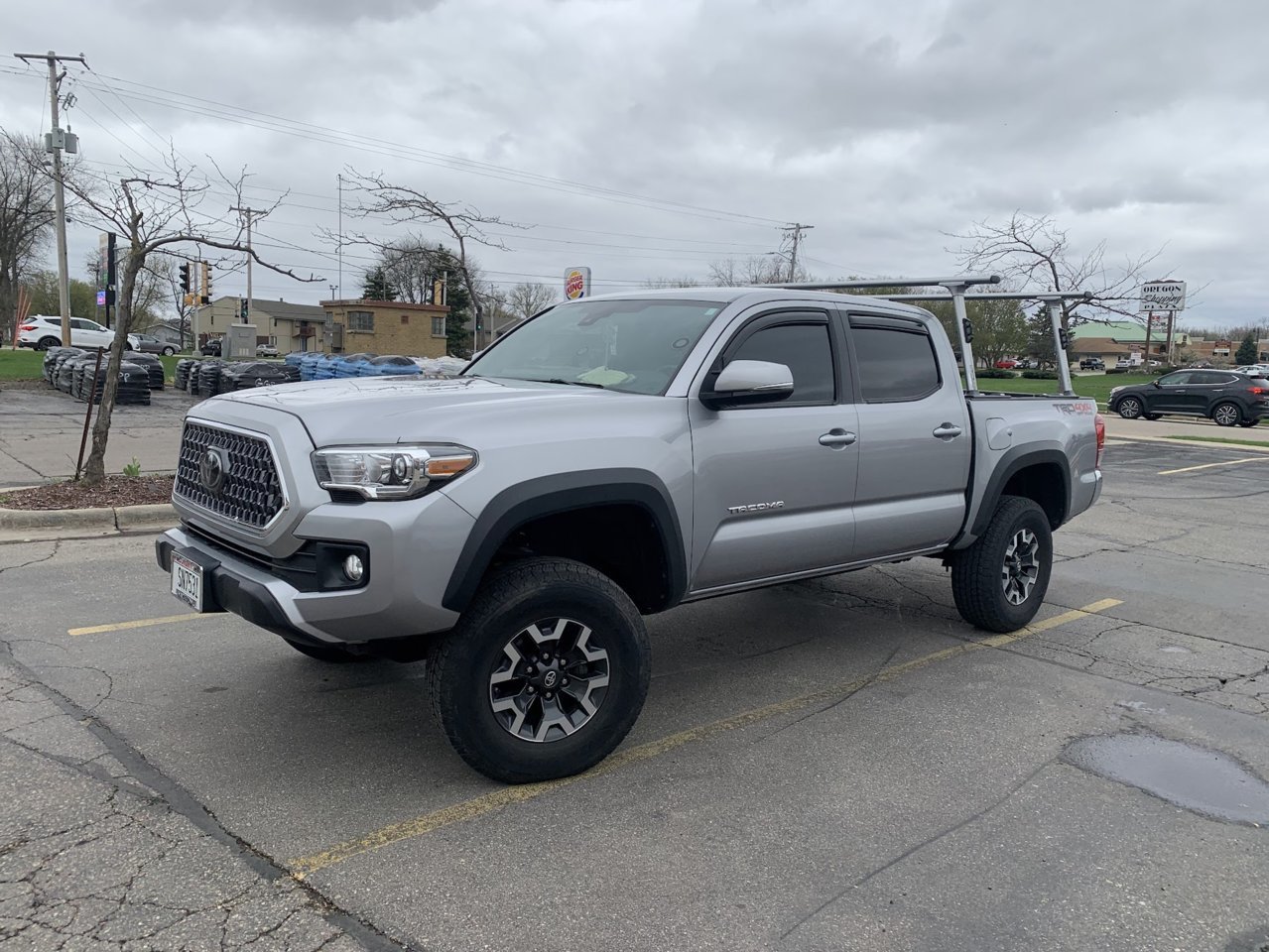

    manderle
    manderle [OP] Taking my time.
    Jun 13, 2021
    #368535
    121
    Michael
    Oregon, WI
    2019 Tacoma TRD OR
    3/2, on the level

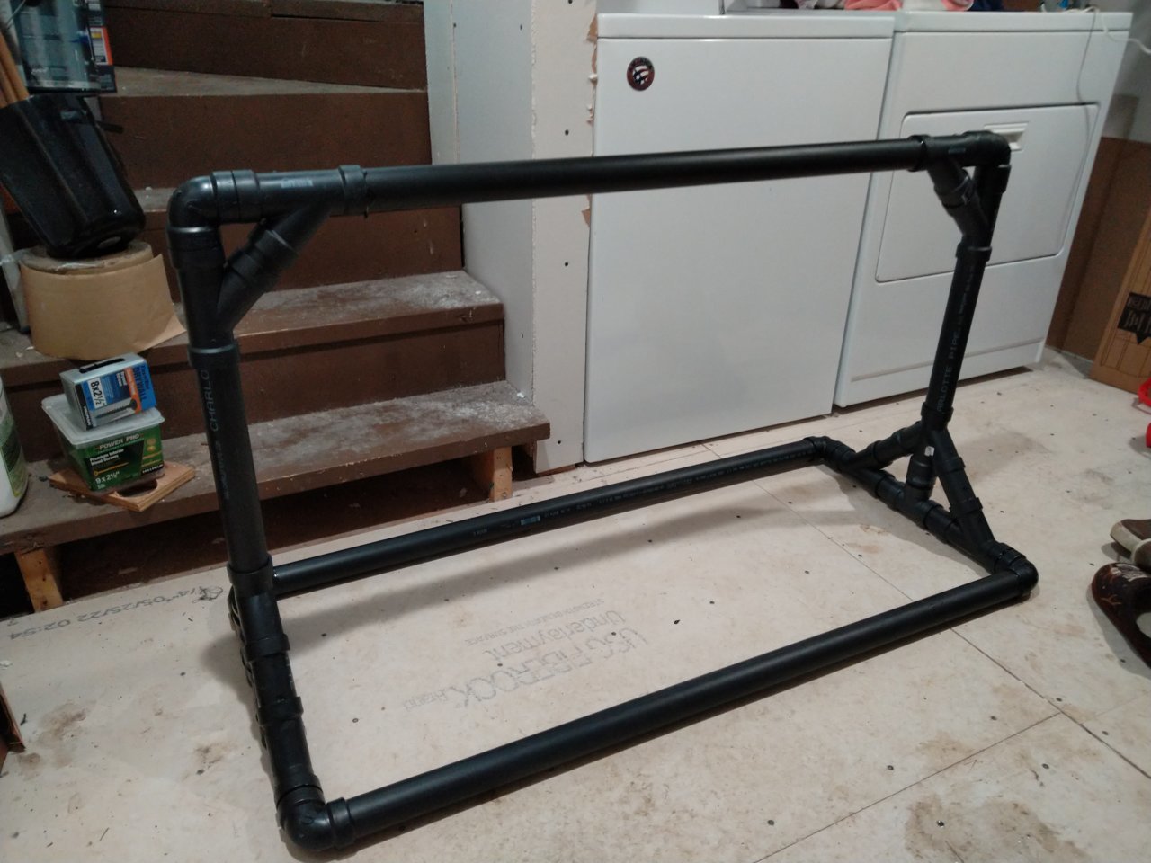

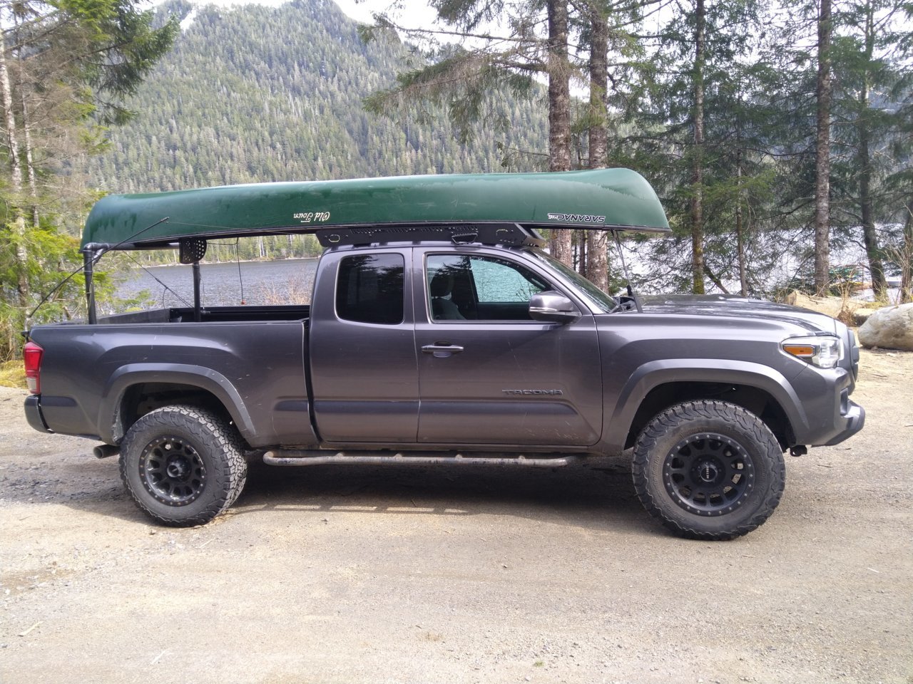

    MountainMike68
    MountainMike68 Well-Known Member
    Aug 20, 2019
    #302824
    141
    55°N
    2016 TRD Sport AC/MT
    Big fan of front and rear straps. The back in case anyone is wondering is 1.5" abs. The vertical pipes are unglued for ease of storage and the raised horizontal is reinforced with 1.5" aluminum flat stock for rigidity.

    I have the exact setup you have…truck is even the same color. Racks work great with my kayaks. Longest one is 12. However, I just bought a 14.5 Saranac just like the one in mountainmike’s post…haven’t loaded it yet. I’m a little concerned about how far it will be unsupported over the cab. I’ve never used a bow line on the kayaks but feel like I need to use one with the canoe. I see your racks have tie down cleats. Mine does not but I feel safer attaching to the bed tie downs anyway.
    I really like MM’s setup. May consider getting the roof rack and going in that direction.
    manderle[QUOTED][OP] likes this.

    @manderle Those straps look pretty beefy. Nice to have good straps.
    Looks like some here are using just the roof rack and that seems to make a big difference on needing the end straps. Makes sense.
    With the bed support some are using, your getting much more support across the whole canoe. MountainMike that ABS support is pretty dang stout. Pretty handy.
    I used these,
    Amazon.com: MAXXHAUL 50241 Adjustable Steel Pick Up Truck Ladder Utility Racks-Pair, Black : Automotive
    They are quite strong. I cut it down and rewelded it to be same height as my roof rack. Also I made 3d printed supports to put on my roof rack that craddles the gunwales and doesnt let it slide forward. My roof rack is about 21 inches off the bed rails. I think the stock height of these racks are at 26 or something like that.
    The racks come with some funky hooks that are made to grab the bed rail. Instead of using those I welded a unistrut washer (1/4" thick) to a bolt head and then mount it to the tacoma bed tracks for easier relocating and removing. Works good for lumber and other junk too.
    manderle[OP] likes this.
