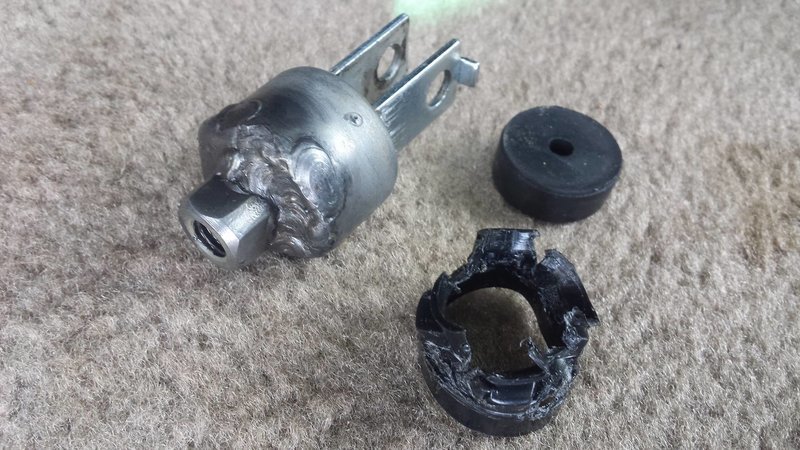

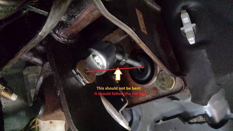

Permanent Clutch Pedal Clevis fix
    It's now like Baby Shampoo ~ No more tears!
