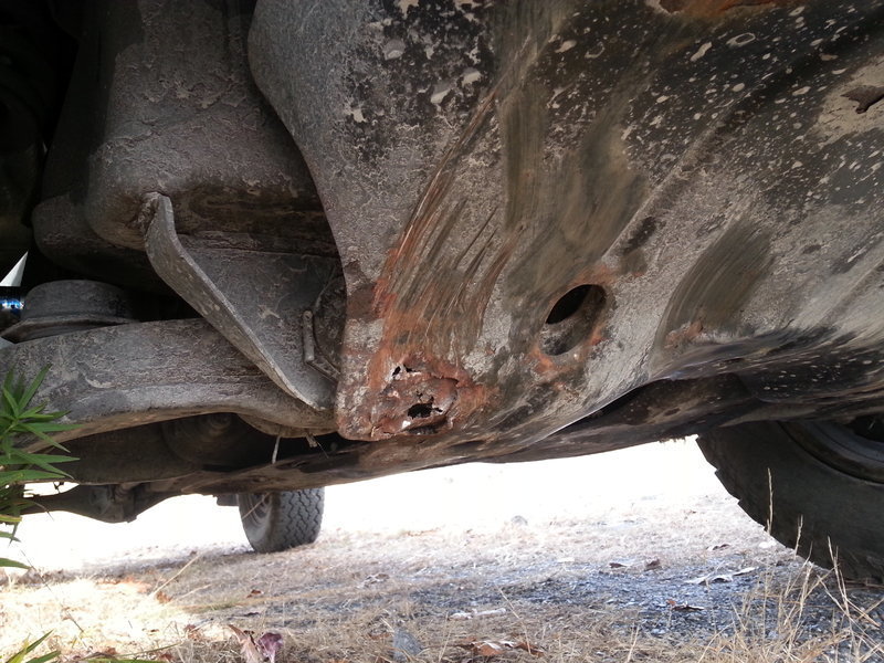

    Your factory skid was pretty bashed by the end of the day though, wasn't it?

    It was. Pic related.
    But I did a few things very poorly. Some specific things as well as generally just not accounting for the 1000 miles of nose dive my truck has. With experience and deliberation, I am thinking a good bit of that could have been avoided.
