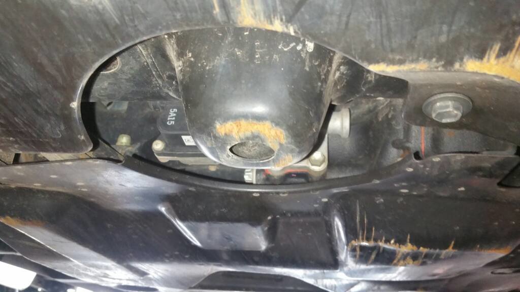

    The proof that I have finally been offroading in my new one:
    Did better than I expected got to clean up the rust and repaint everything.

    My rear diff came out untouched. I also have a metal circle around the plug to protect it.

    thje problem exists when the metal circle gets bent in and lock the nut in place, then breaks off when you bend it back 100 times

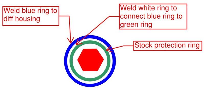

    Build thread in sig... 4-link long travel
    cut a piece of 2'' sch 40 pipe (I think that's the right size). weld it to the diff on the outside, and then weld it to the stock ring on the inside. you end up with a 3/4'' thick guard that won't bend over into the nut.

    red is the diff plug.
    green is the stock guard
    blue is the piece of pipe you cut a small section of
    you essentially triple the "wall" of the guard.
