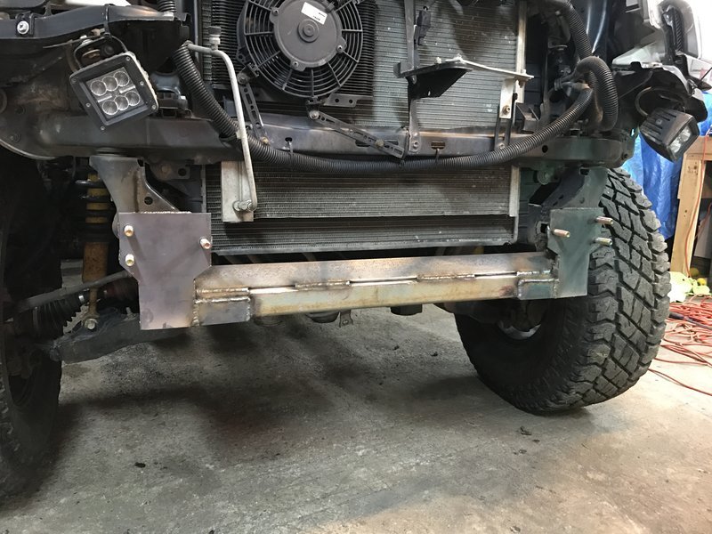

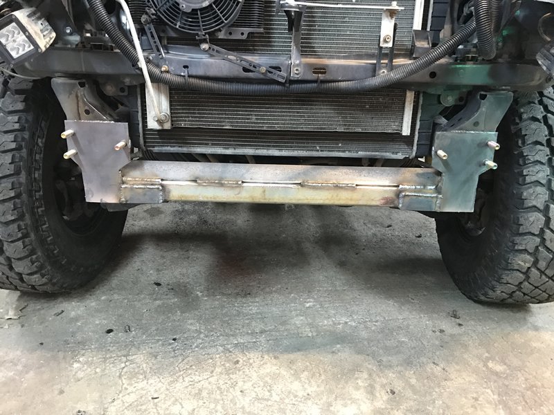

    Just getting started
    You missed a spot

    You get solder in your eye?

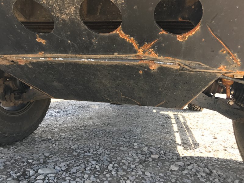

    Looking good. What skids do you have and how thick are they?

    Mobtown down the middle. 1/4" IFS. That's why the angle only wraps around the bottom on the edges of the x member. The 1/4" IFS skid bolts across the center. 3/16" on the other two. RCI LCA, Fuel tank, and diff skids.

    Wow with a 1/4" you still bent that crossmember. That must have been a hard hit!

    Oh, it was quite the jolt... lol.
