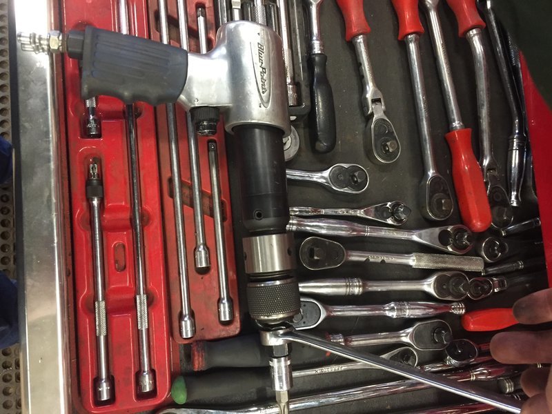

    ****TIP for those of you breaking torq's bit or any frozen bolt.If you have an air compressor and an air Hammer they make an attachment for your air hammer that will accept a socket, a couple of hits with the air hammer and a wrench will break it free.then go at it with a your air gun....less broken sockets.

    How does this work Jerry? It just hits the bolt without any rotational torque? Or just hammers the socket on nice and tight?

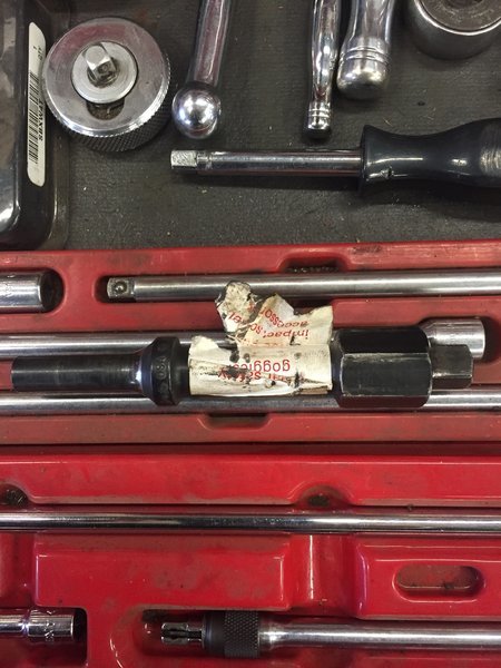

    it has a spot for a wrench (3/4) while hammering the socket if the shock does not break it loose the hammering acion with the twisting of the wrenck usually does it.its for removing.Ill get a pic.

  15. Apr 21, 2017 at 7:55 AM

    Huh, that's pretty sweet. I gotta get that for my air hammer.

    Ooooh. Didn't think of that. I actually do have an air hammer.
    I was doing it the old fashioned way. Smack it with a regular hammer a bit. Use the impact wrench. Smack again, repeat. It finally worked (after a lot of daily applications of penetrant as well.)
    Thanks for the tip Jerry!
