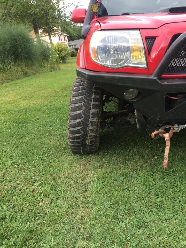

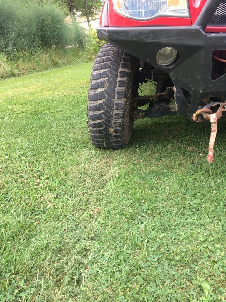

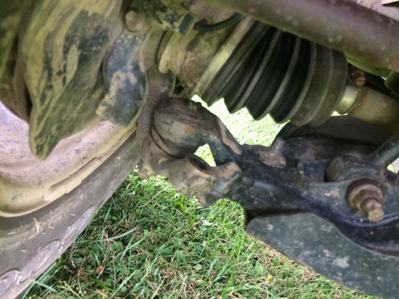

    Alot
    Well shiiit
    Fucking bolt on the lca somehow came out today on my way to work don't know when. But noticed it as soon as I started backing up. Won't have a new one till Thursday then hope nothing else is fucked up. The inner cv boot looked pissed!

    That sucks. Good thing you noticed at low speed.

    I used to have one that the threaded were a little fucked but I tossed it when I got a new one. I'll have to go pick up the bolt after work on Thursday. Get it in Thursday night. I'll be good for Saturday. Haha

    118 ft-lbs.

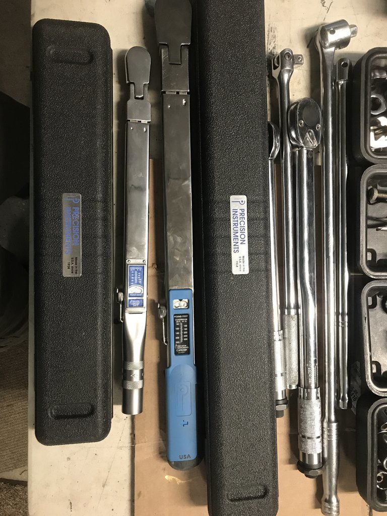

    I read somewhere that peeps that don't use a torque wrench tend to under-torque a fastener, thinking that that are over-torquing that fastener.
    Then there are those that over-torque everything.
    Best tool investment I have ever made.

    I have a torque wrench. But I just went as tight as I could. Haha. Lesson learned.

    It's so easy to under estimate high torque applications without a torque wrench. Everything feels different depending on what length ratchet you have.
