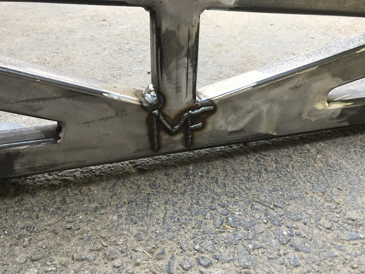

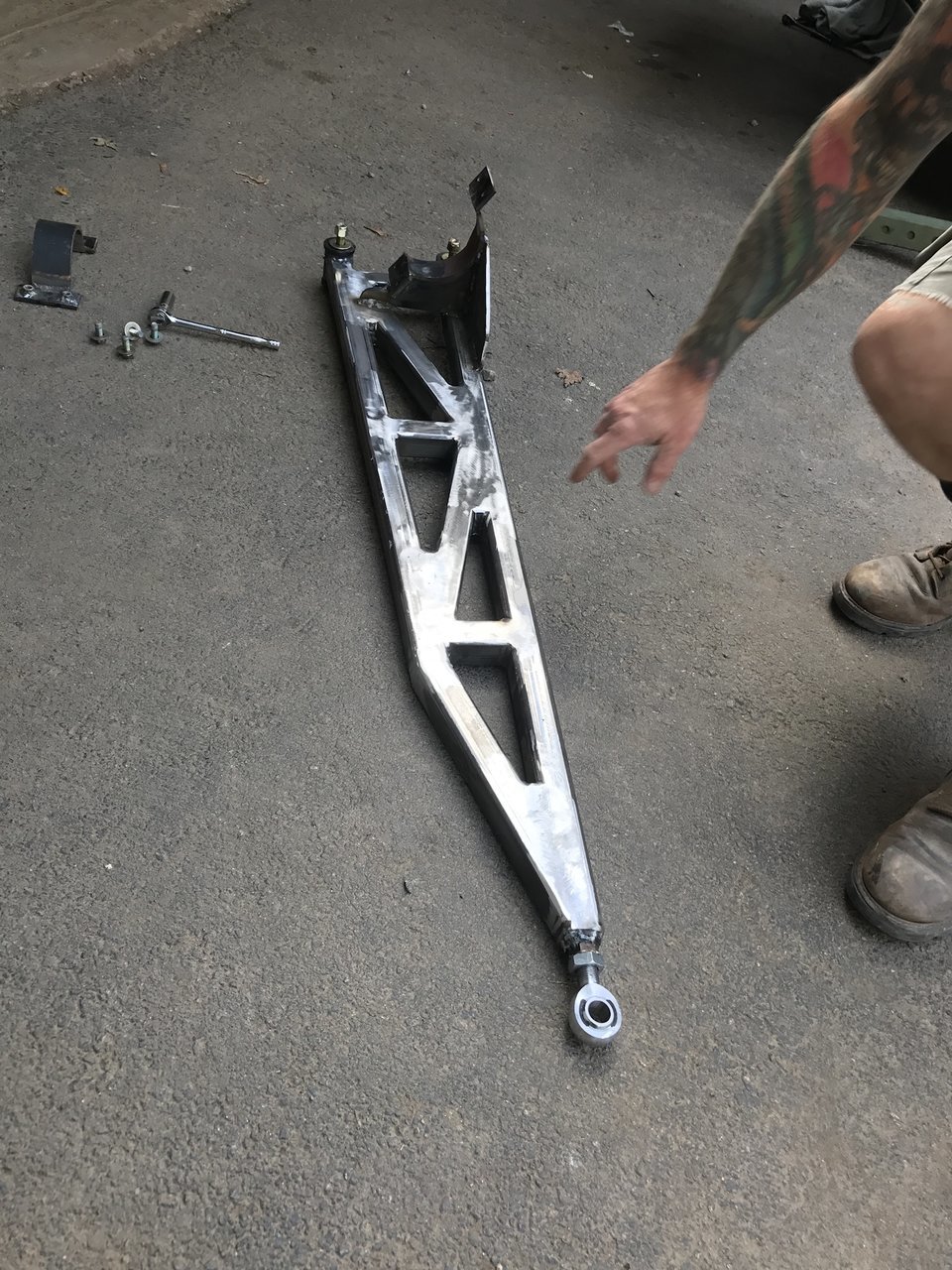

    I made the ladder bar to control wheel hop/axle wrap to keep my axle shafts in one piece because of the SC and 35s. While I was designing it, I realized it could be positioned to help with DS protection. Then I figured it would be nice to have a safety hoop for the DS in case of rear u joint failure. And voila

    Saved my DS quite a few times already.

    I only changed it about 3 times now...lol. I have heims on the rear connection points now too, as the poly bushings were allowing too much slop for my taste

    About $250 for the initial version, then about $80 more for the two extra heims. Obviously going with the heims right off the bat would save some money. Believe it or not, the bushings are not much cheaper than heims. Got all that shit from Ruff Stuff. Even bought the shackles from them to save time.
