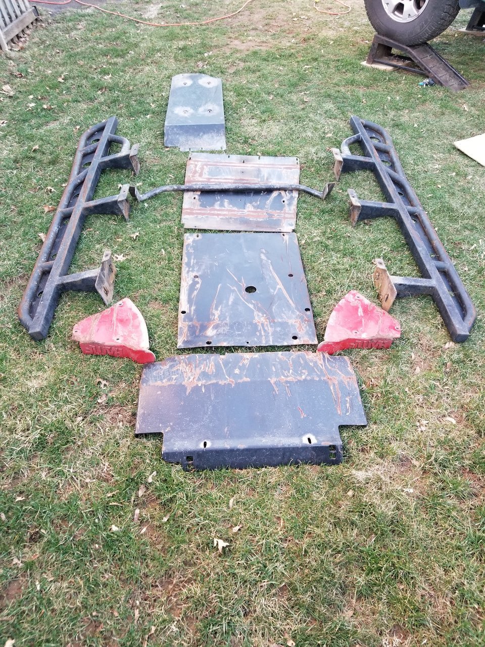

  11. Feb 27, 2018 at 2:44 PM
    Fifthwind
    Fifthwind Master of None
    Oct 13, 2011
    #65144
    2,096
    Murph
    Lehigh Valley, PA
    Scully
    Barcelona Red 09 DCOR- Icon 2.5" ECOs w/CDC - 14" 700lb, ICON 2.0 RR Ext rears, AP EXPO pack, Diff Wedge, Diff and Skid Drop, Discoverer S/T 255/85/16, Ride-Rite Bags w/ Daystars, ARB Bull/winch Bumper, Warn 8k, ARB CMK12, Budbuilt skids, BAMF bolt on sliders BAMF diff diaper, bedlights, hoodlights, BAMF CB, etc.
